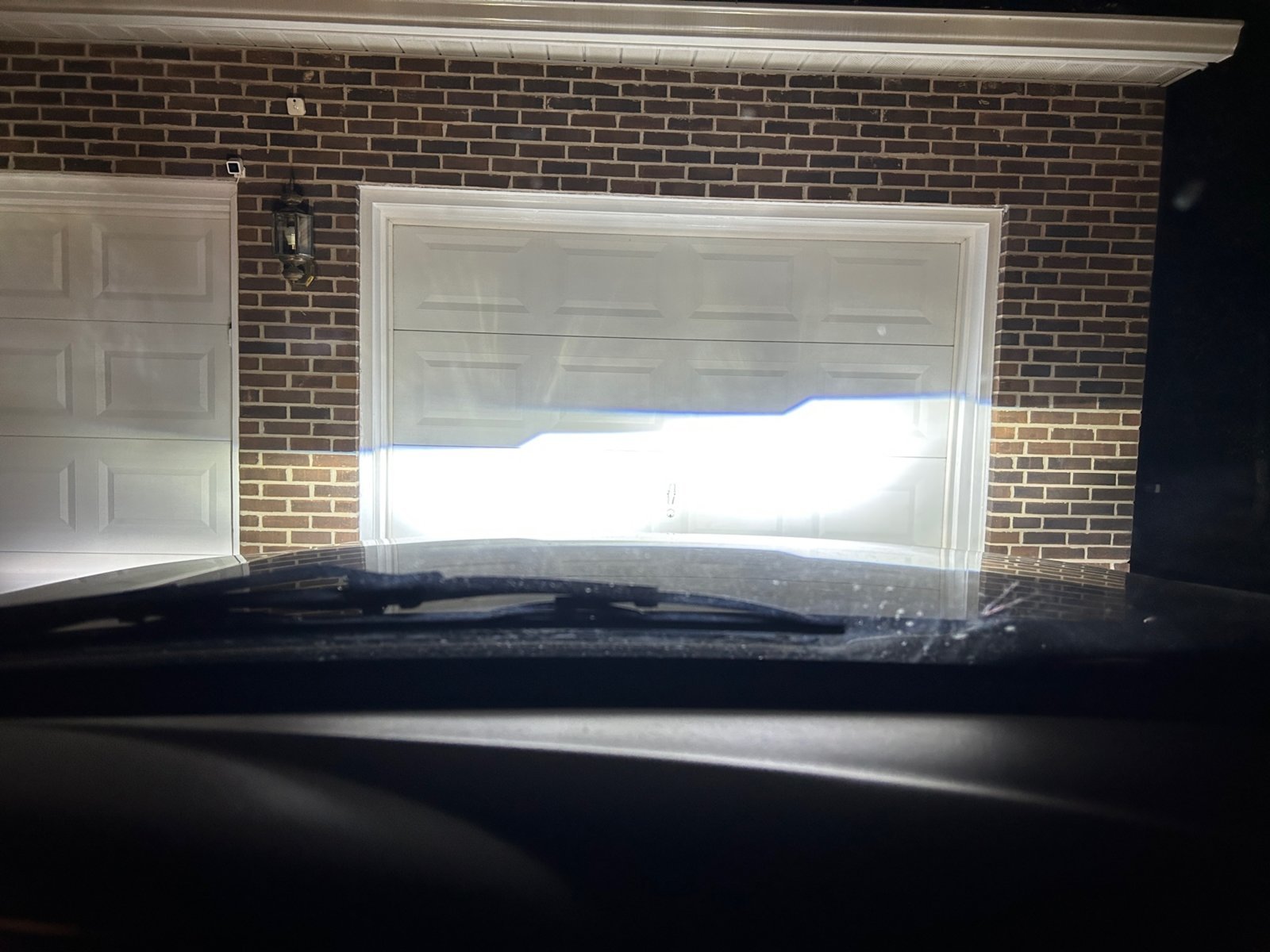

    OK, I drank the kool-aid and just did this upgrade. These are the bulbs I used ($18 from alibaba). I have been using non-projector LEDs, but have not been happy with the beam pattern or cutoff. I have high hopes for the mini projectors. Now I just have to wait for it to get dark. And before you ask...yes, I still needed a resistor on the passenger side.
    Based on the all the comments in this thread, I'll start looking for my next set (next gen?) of mini projectors before these fail. Since I've modified the housings to accept the mini projectors. I'm kinda stuck now unless I buy new housings.
    Another concern is that I can see how to reinstall the bulb shields without covering the fans. Does anyone have a creative solution to this problem?

    I was able to toss mine on with a much larger heatsink. What's the issue preventing you from doing the same?

    OK, I'll try that. I was just afraid of restricting the air flow.

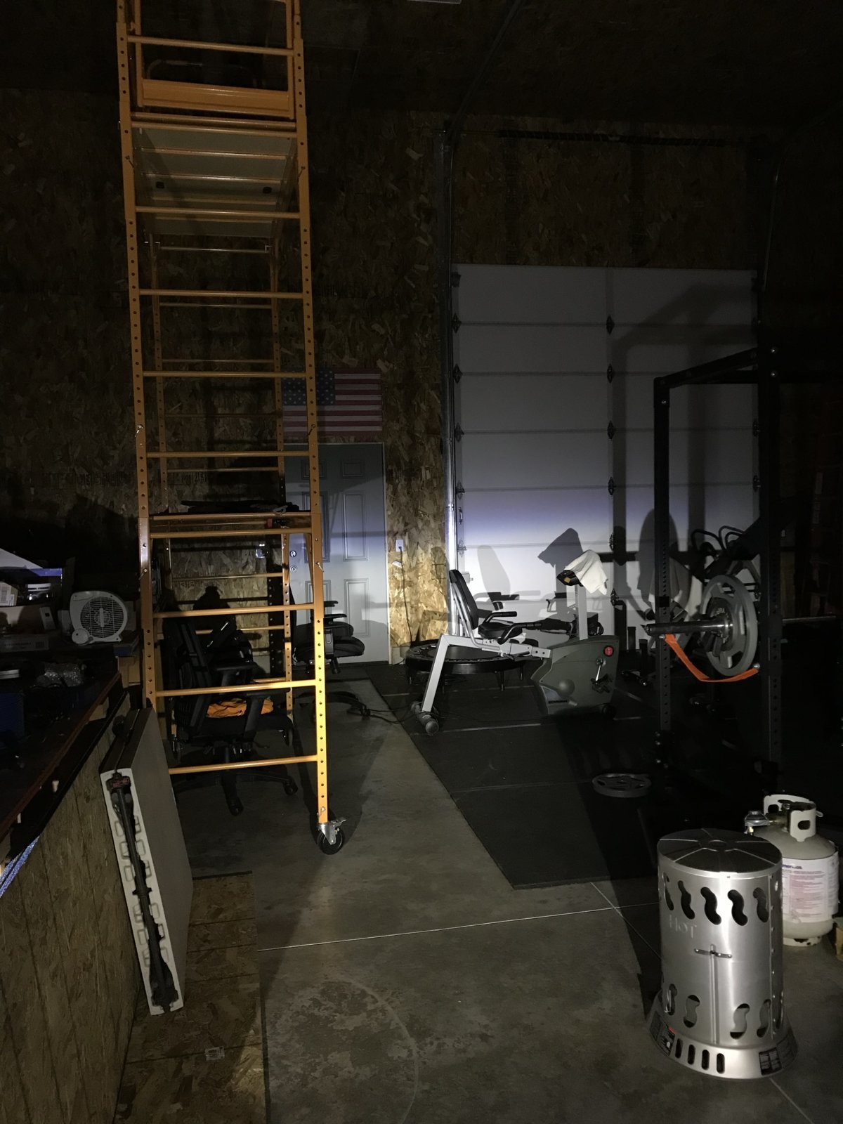

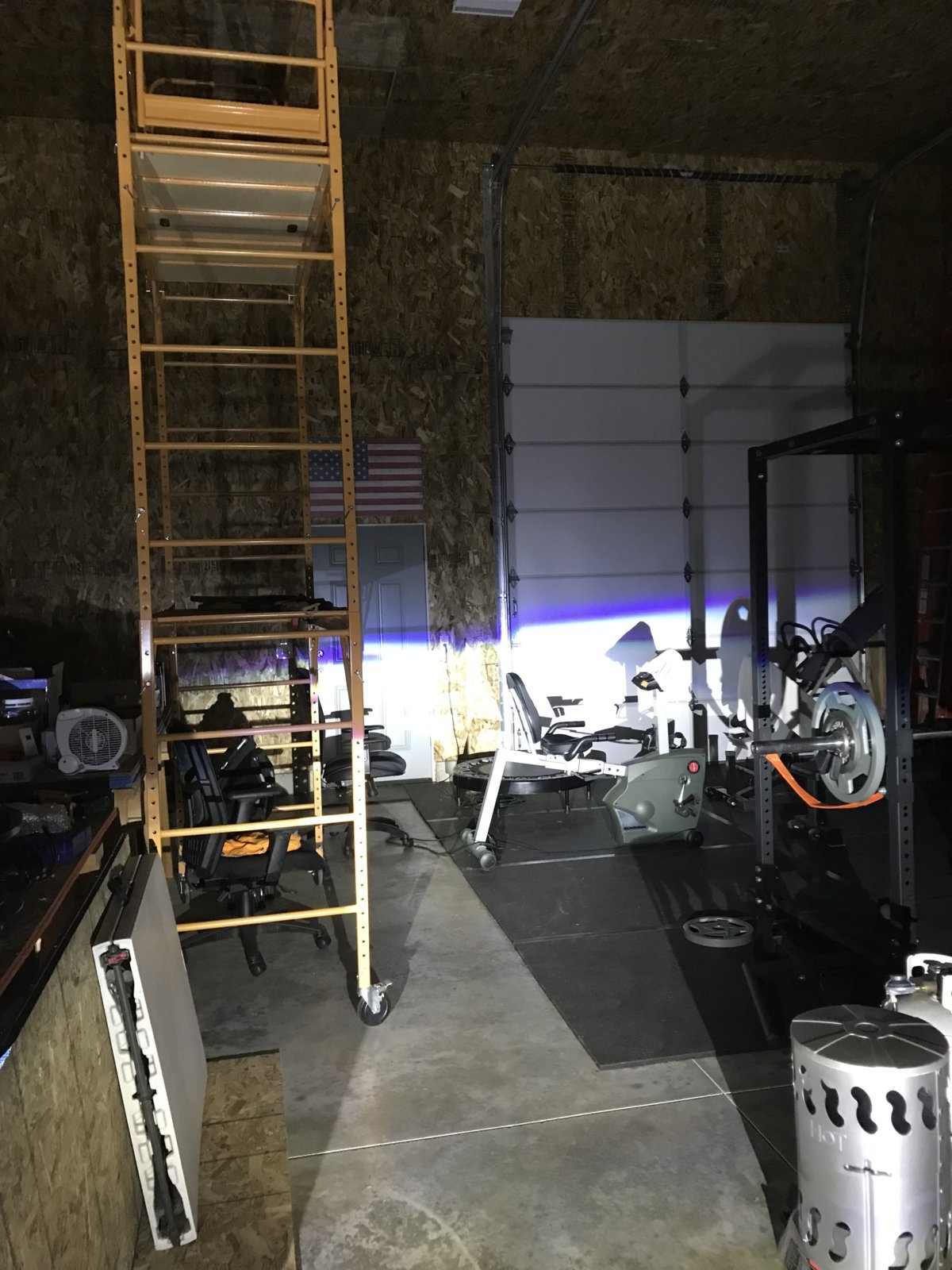

    It's dark now. I guess I have some adjusting to do!

    Left looks like it may be really close, maybe a hair low. Right side definitely needs to come down. But looks good! Damn bright. I think you'll love 'em, that cutoff looks way better than the CO/BraveWAY bulbs.

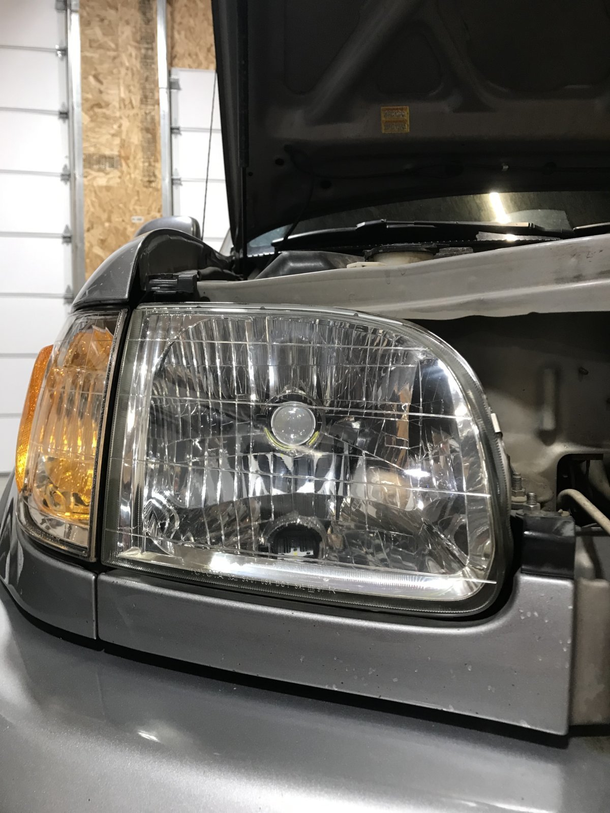

    I hopped on this for my brother's truck. Popped them in (with all the modifications of course) and turned it on... very bright, very impressed! However the cutoff was less impressive.
    Used the headlight kit from Cerakote to clean up the headlights. Immediate improvement! Clear cutoff and even more light output when it is not getting scattered through the oxidation.
    It also gives a more modern look to the front end with zero light in the reflector bowl and only the small projector.

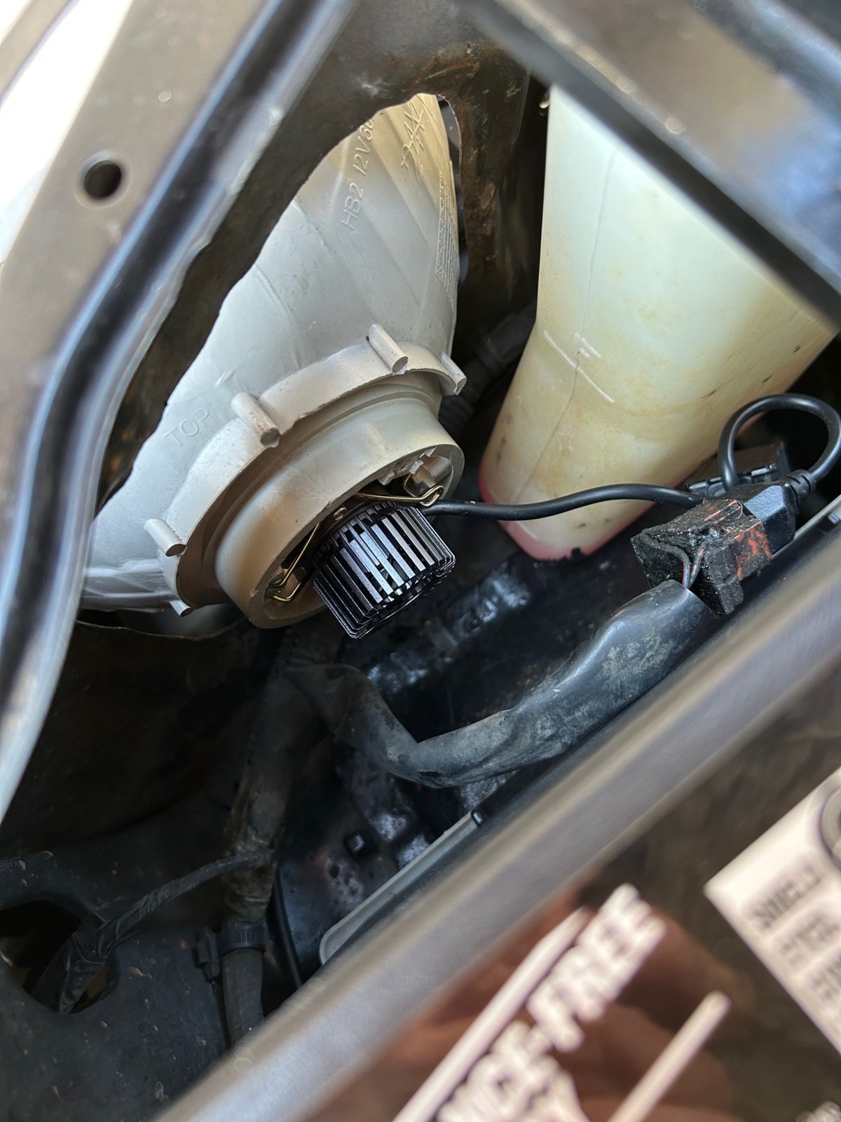

    The ones I have and @shifty`s are fan-less and the heat sink is removable, it just unscrews (this was the case with mine, can’t say for sure about others) then the boot went on and the heat sink could be screwed back on outside the boot.
    I wouldn’t put the fan inside the boot, might either need to cut a slit in the boot so it fits over the heat sink/fan or just leave the boot off.
