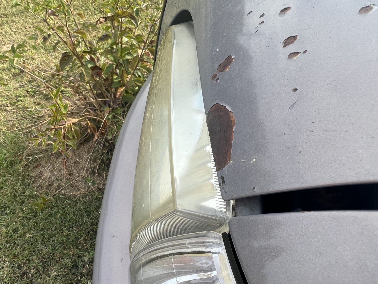

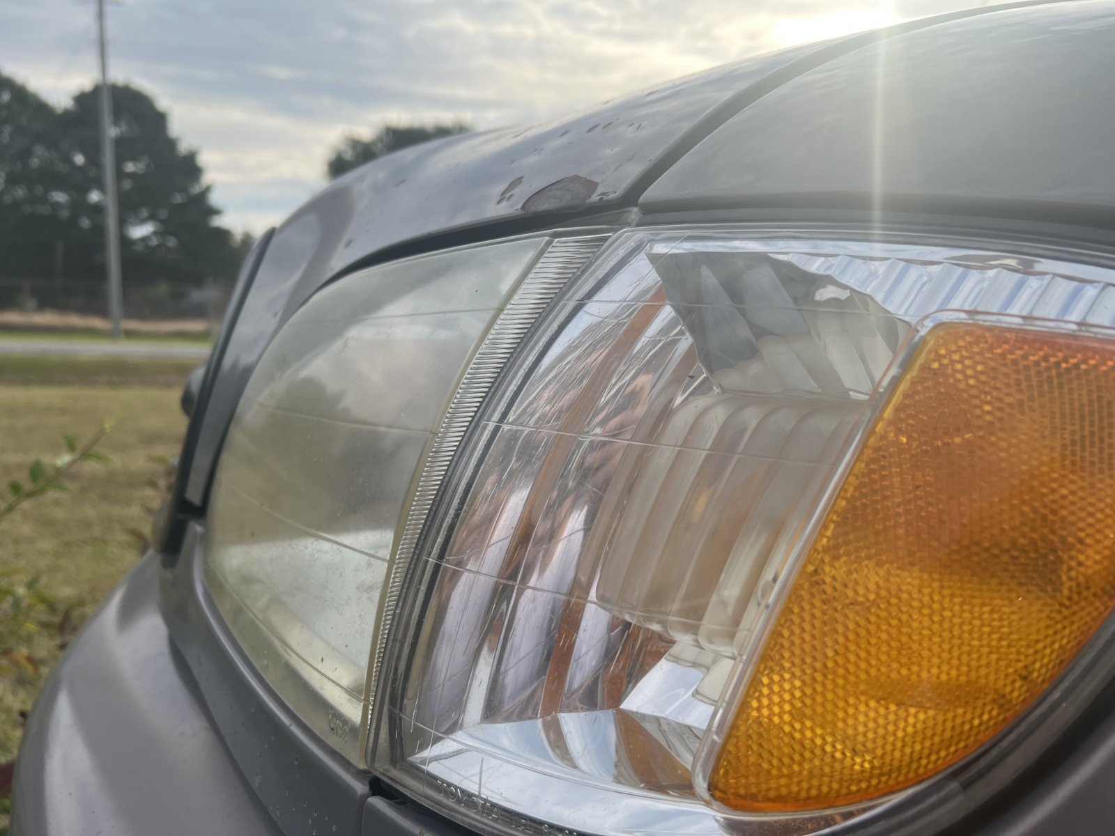

    Mine sit flush to the blinker, I'm pretty sure. I wonder if it's different for the 00-04 fixtures?
    I initially dialed mine in at the house, then went on a drive, and adjusted until I sat about 1" below the trunk line of cars in front of me, like this. And regarding my upward scatter comment, this is what I saw.
    I'll snap a pic up close of my housigns on the way out. All I have is this pic from when I parked this AM. Yes, I take random ass pics of my truck. I like it that much. And no, the parking space isn't painted straight on the passenger side. This deck is striped horribly awkward.

    This is strange. On my 05, the headlight is attached to the body at 3 points, one up top near fender, one inside corner near grill, and 1 outside under turn signal assembly. When I adjust my lightbulb, the reflector bowl inside the light attached to the adjustment screw is the only thing that moves not the whole headlight assembly. What gives??
  10. Oct 24, 2023 at 8:20 PM
    #70
    shifty`
    shifty` Smooth, like a hot comb on nappy-ass hair
    Jun 20, 2020
    #48239
    31,180
    ATL
    '06 AC Limited V8/4WD
    mine is same.

    May have to get me some 05-06 headlights when I replace these then. I do have a 2” or so lift up front with the 5100s and my rear springs are OE tired. Borderline bro-lean with the campershell now. Probably contributing to the extreme headlight angle needed.

    It still strange to me that the lamp is physically angled like that. Usually the reflector bowl inside is attached to a pivot point and when you adjust the adjustment screw it just moves the bowl on that pivot point inside the headlight not the whole outside headlight assembly. I have had an issue once on a retrofit where the projector I used naturally pointed downward somewhat because of its design and when I maxed out the headlight adjustment I had to shim the light assembly mounting bolts using a couple of washers.
    Some projectors include a silicone washer that is molded thick on one side and thin on the opposite side to help mitigate the projector being too low or too high and keeping sufficient adjustability inside the headlight assembly.

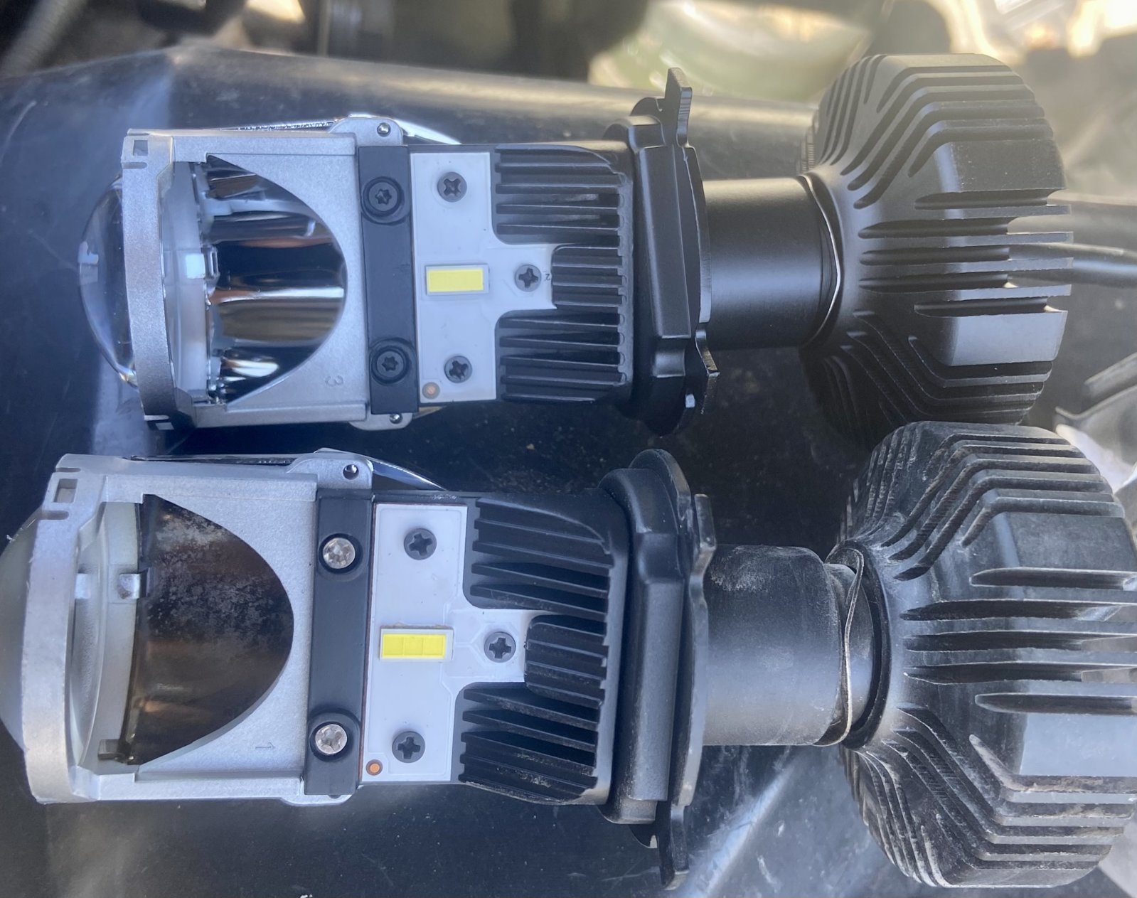

    1 new, and 1 failed after 2 years of use

    Yup, same as the scAmazon part from the review @artsr2002 posted above. Interesting. So obviously these have a failure point. And indeed, that spot is exactly on the back side of the LED chip.
    It would appear these may have a design flaw, wherein the wires aren't heat-shielded, and the LED chip is getting so hot, it's melting the wire sheath, and wires are arc'ing together?
    @RUSTYNUTS you should go into scamazon site, go to 'orders', look up your old order, and review/update your review to upload pictures to share. I wonder if this is why BraveWAY was purging at that price? Maybe they're aware there's a problem with these bulbs melting down, and they're planning to dump and run?
    There are some subtle differences in the two packages also, it's totally possible they fixed the issue in the latest versions, also.

    I installed my first set of mini-projectors into brand new black-chrome aftermarket housings. To be fair, none of us replying up in here have installed legit projectors. These mini-projectors are an attempt to get the benefits of a projector, without the hassle and work of actually retrofitting, which is much more involved, as well as more costly.

    I was previously unaware that you got projectified. It's really as simple as a bulb change so......meh. Now, if someone were to go full retro-projecto, as you have done, but into old oxidized housings...... off with their heads! That's almost as bad as buying a new set of wheels, and mounting old cracked and bald tires on them.

    Well, kids, I called it. The price drop WAS in fact their way of purging inventory. Both CO LIGHT and BraveWAY have pulled this projector off the market. CO LIGHT doesn't even have it at their website anymore.
    I may break down and buy CO LIGHT's other fanless bulb and give it a shot during the holidays. I'm hovering to see if they put out the $75 fanless H4 projector at their website on scAmazon.
