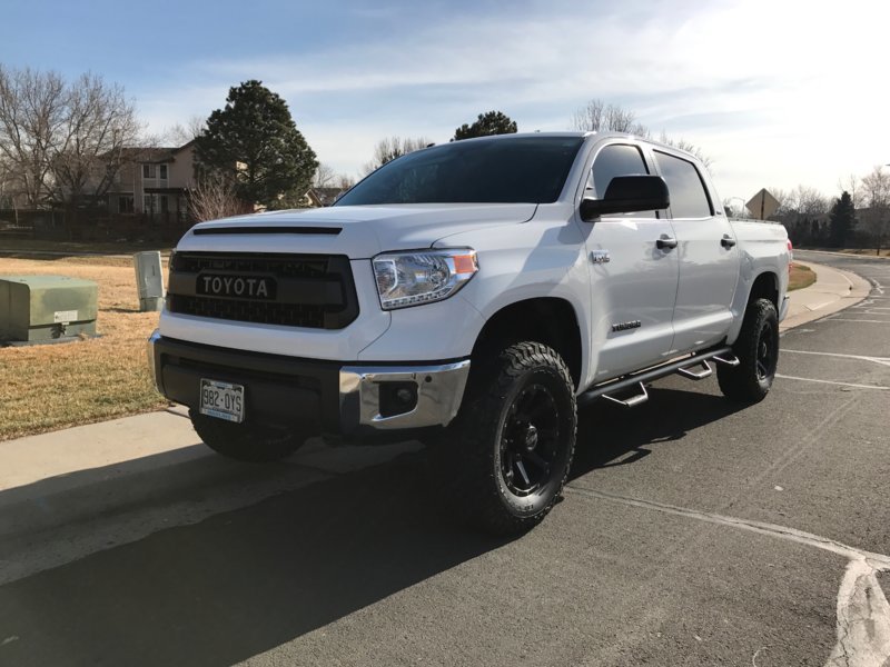

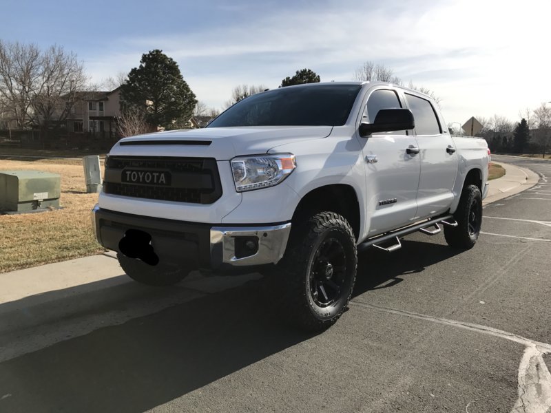

    Truck is fixed and ready!!!

    Truck is all done. Thank you Toytec for the quick replacement parts. We replaced both sides.

    Both since came from same batch of springs. So thanks to ToyTec and Eibach on that one.
