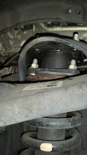

    Hey guys/ladies,
    I just recently purchased my ToyTec/Eibach/Pro Comp coil overs. Also, a set of SPC UCA. I'm having them installed on Tuesday. My question is: can I leave my Pro Comp (level) strut extension on when installing the coil overs, since I will have the UCAs? That way I can obtain the toal 4" lift I want. Will it help keep the shock from locking out, if I keep the coils wrenched down? Or will it cause issues in other areas?

    I looked up the ProComp lift and it is the type where you could bolt the coilover to it. I however wouldn't recommend it. You shouldn't stack lifts. Magnifies potential problems. If you have 4WD then you should keep to 3-3.5" to avoid extra wear to the cvs and wheel bearings. Even with the new UCA it may be difficult to get alignment specs if you go too high on the lift. The coilover is built to adjust, adjust it up to 3-3.5" if desired.
    If you want to go higher then you should add a drop bracket lift. This lowers the LCA mounts and adds a larger spindle and lowers the front diff to keep the cv angle smaller.

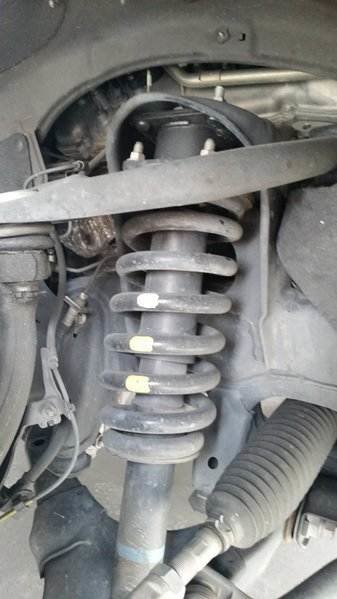

    Well you are in luck. With 2WD you do not have a front Differential or CVs to worry about. If the coilovers you got are for 3" lift then your good, the length is setup for that. If the coilover is stock height or only made for like 1" lift then you could add to your spacer lift and be ok.
    What are you adding to the rear? 1" rear lift is needed to be level with 3" up front.
    Post the coilovers you got and a pic of the spacer lift you already have installed.

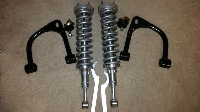

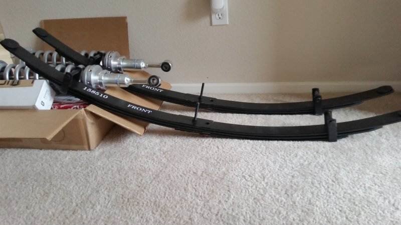

    The coilovers are for 3-3.5" of lift. Unfortunately in building the coilovers, I accidently changed the position of "stock" height w/o marking it ahead of time. They're sitting on Pro Comp Pre Runner SS (the ones that are ride adjustable). I already had the shocks. I got the head & coil from Toy Tec. They sell the same build.
    Right now I have Pro Comp Pre Runner SS shocks in the rear w/ a 1" Pro Comp block.
    As of this Tuesday, the shocks will stay, but I'm replacing the leaf springs & block with an Icon 1.5" replacement pack. As well as the coilovers, and SPC UCA.

    That will be an awesome setup. I would install the rear and then adjust the front to be level or slightly lower than level.
    I would not keep the existing front spacers. Will be too much lift for the front as well as the other items I mentioned above.
