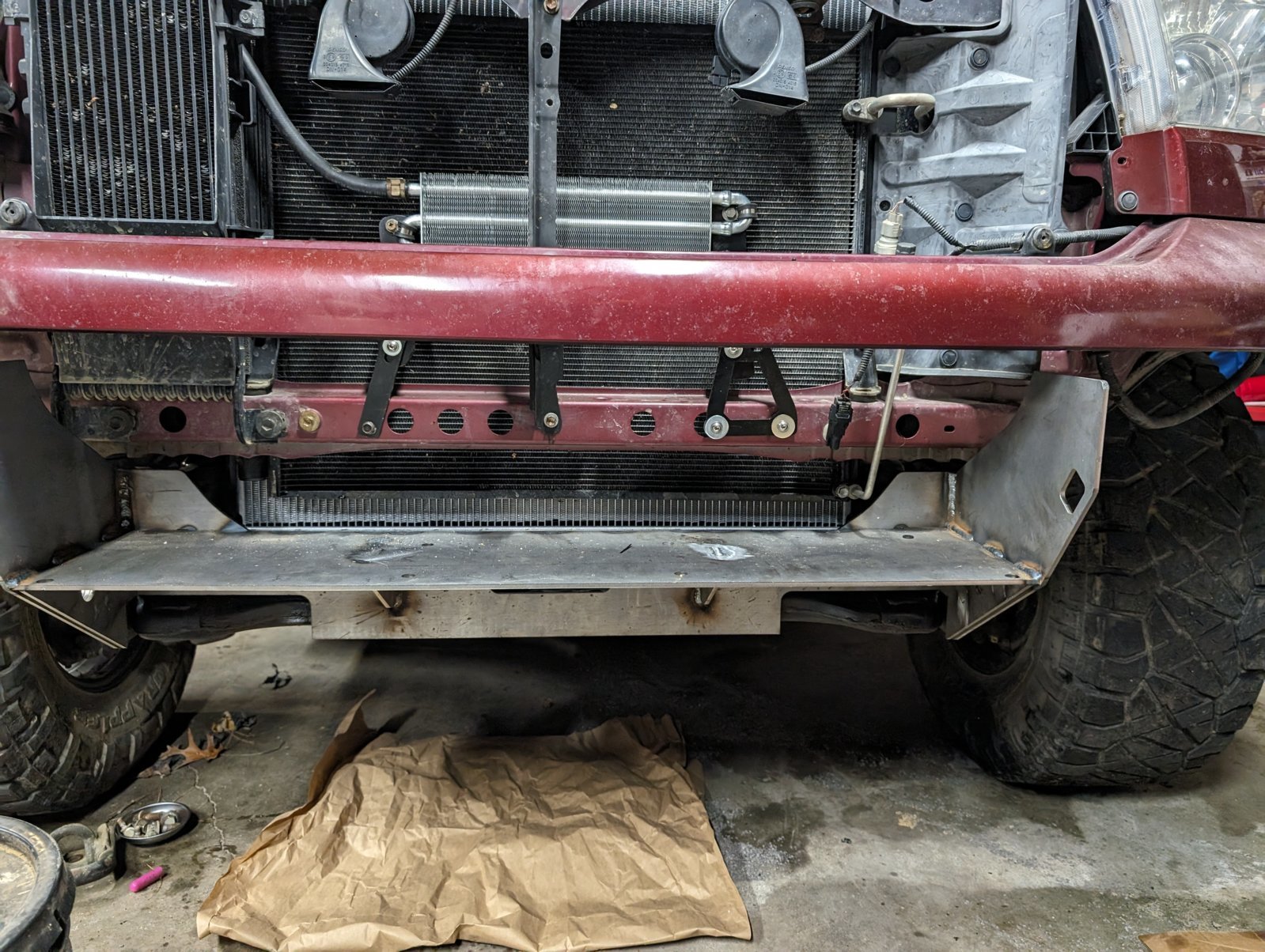

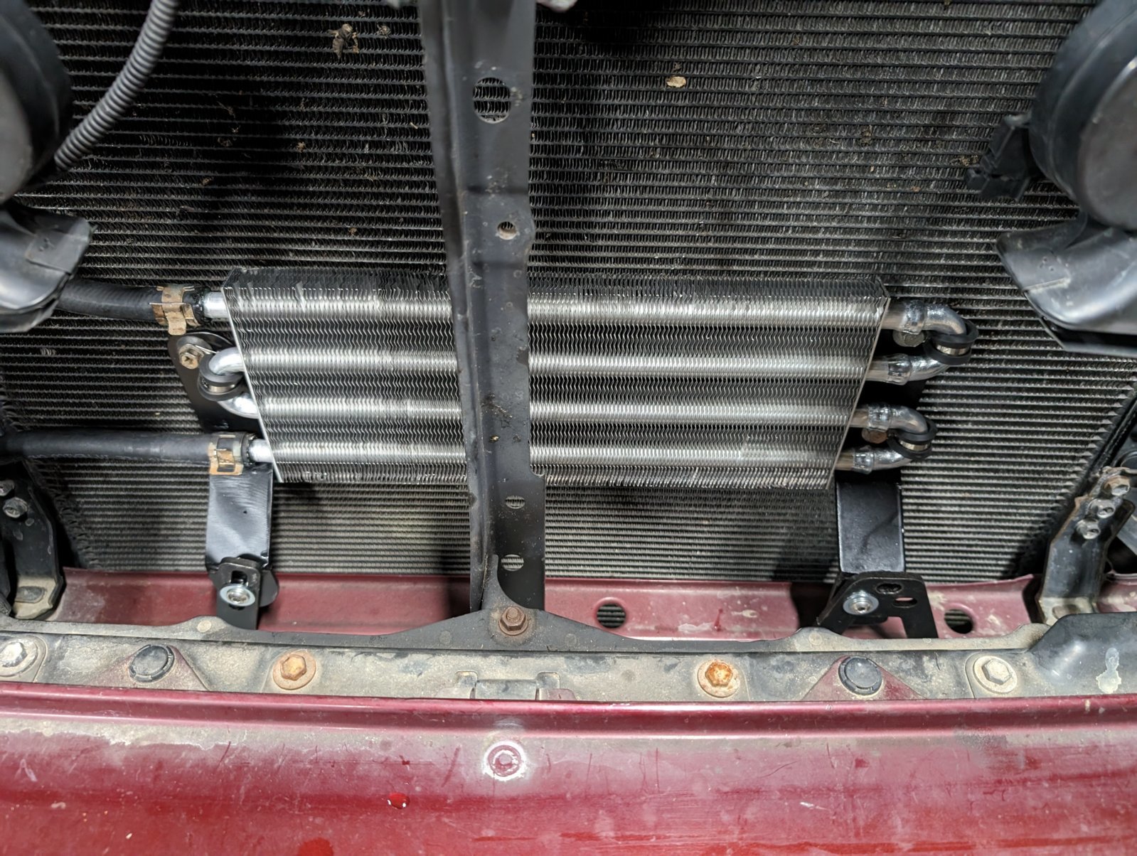

  11. Dec 4, 2023 at 10:20 AM
    #71
    Oochi20
    Oochi20 New Member
    Dec 4, 2023
    #107944
    14
    Ryan
    2008 Salsa SR5
    OME 2.5" Lift SSW Stryker Wheels 35" Nitro Ridge Grappler Tires
    Sorry to revive this old thread but I just got a Coastal bumper and was looking through thread to see what I got myself into. Great write up! I also got hung up on the power steering relocation. In your picture it seems that you may have the brackets on upside down as it should push the cooler up much higher than shown. They may have changed the instructions since you got yours.
    But regardless, I have the factory trans cooler which was in the way of the lines for the power steering relocation. For others running into this, I used their supplied brackets then made my own brackets to fit an aftermarket cooler.
    helidave likes this.

    53
    I assume you have to remove it, can’t leave it and move it when you install a winch?
  28. Jul 27, 2025 at 6:15 PM
    #88
    Wahayes
    Wahayes [OP] Older I get the wiser I realize my dad was
    Sep 23, 2019
    #36539
    1,756
    Will
    2017 tundra limited *sold*
    325/60r20 falken at3w, 2.25 dobinsons ,20x9 +20 fuel torque wheels, leer xr100, bmc
    Correct . It can’t stay in the same place so you have to either relocate it with a bracket , or do like I did and just replace it with an aftermarket cooler.
