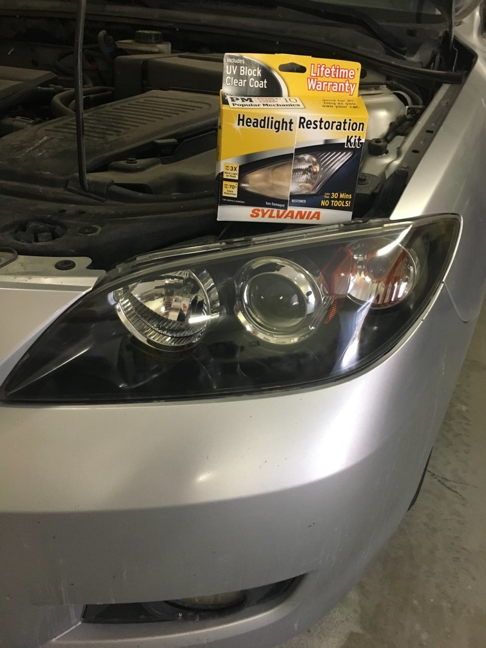

  3. Sep 19, 2023 at 3:04 AM
    Bprose
    Bprose Old member
    Jan 15, 2017
    #5955
    1,781
    VA
    17 Tundra CM TRD
    I use this brand. Works great, same process as described above. IMG_1851.jpg
    equin likes this.
