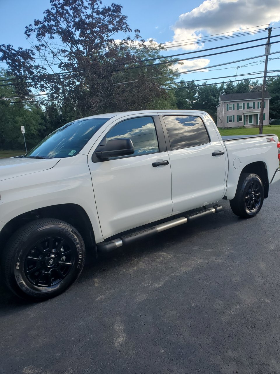

    This was my 2020 with the same issue

    I'm not sure what that is, but it doesn't look like all the clear has peeled. Without clear, your paint would have zero gloss. Base coat has a flat or satin appearance. It appears that the edge of the hood still has gloss.
    To see what the base coat looks like, open your hood. Areas of the front radiator support and inside fenders is base coat only without clear. Base coat has a flat finish until topcoated with clear.
    Try dragging a finger nail lightly across that line. If it's the edge of peeled clear coat, your nail will hang up on the line.
