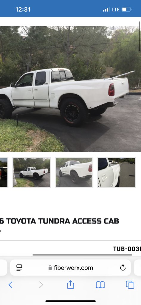

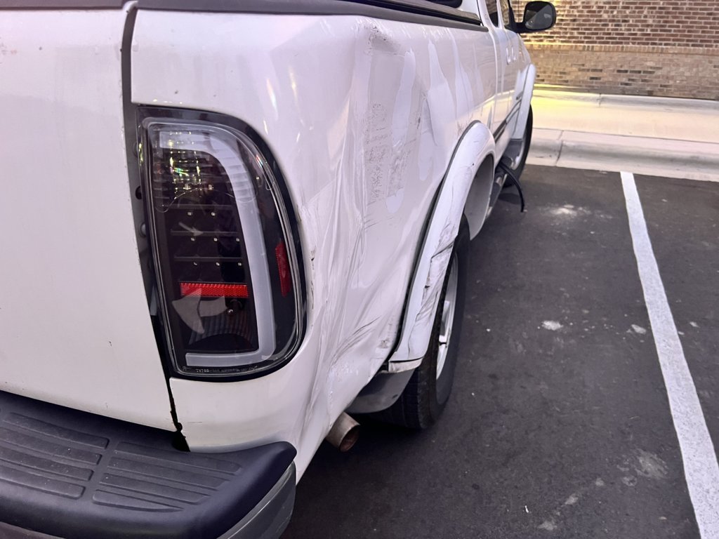

    I’m thinking about throwing a wide body on her now. Especially if I’m gonna have to pay a deductible for insurance

    Bummer! But maybe also a blessing in disguise, there's your paycheck to a repaint. If the Insurance Co doesn't total out the truck over the damages, ask them to cut you a check for the damages. It'd cost you less than $800 to find a good bed w/no damage.
    If you're smart about this, you could potentially get a lot done. Like ...
    • You could probably find (4) part-out doors from a white 2005-2006 AC for under $500, which is about 1/3 - 1/4 less than a body shop would charge to paint.
    • You could probably find a left/rightfender and hood from a white 2005-2006 AC for under $400 which is about 1/2 what a body shop would charge to paint.
    • You may be able to also find a nice white AC tailgate and hood for under $200/ea which is at least 1/2 what a body shop would charge to paint.
    • If you hang the doors, then take the panels to the body shop and have them repaint the cab and only the cab (no doors, single stage, so basically just the roof and A/B pillars), you're probably looking at $1,000-$1,500 tops, maybe a little more if you ask them to hang the new panels (hood, fenders) and polish it out.

    • You could even have them do the wide body parts at the same shop and install, then skip buying the junkyard fenders.

    That’s exactly what I want to do, get a check from the insurance co and just do all the work myself and upgrade while I’m doing it. I’m in 28544 NC, if the paint is two stage I think finding some replacement body pieces is a good way to go. I wish I had documentation of all of the work done on this truck

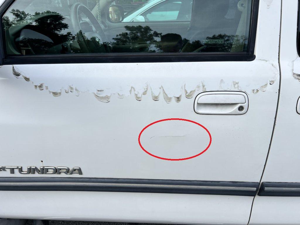

    Not one to want to say, “wait!”, but give it 6-8 weeks. See if it’s still shiny. If it is, and it were my truck, I’d try to peel as much of that failing clearcoat off as possible, which shouldn’t be too hard if they painted it over chalked single stage paint, and polish the entire truck without clear coat.

    Update: Insurance is saying that the accident was partially my fault lmk what you think. Im gonna post the video here. Also truck paint is still shiny from the number 7, also I’m thinking that this is not clear coat coming off maybe it was a wrap?

    Maybe it was a wrap? But if they cleared over the stock single stage, it’s probably separating and it would look like that. I would get a plastic 3” putty knife and see if you can pretty easily start where it’s flaking at the top of the door and work it under the clear, and peel it off in sheets. If you can, see how hard it’ll be to peel all the clear off the door.
    How could someone backing into you possibly be partially your fault? I don’t understand.
