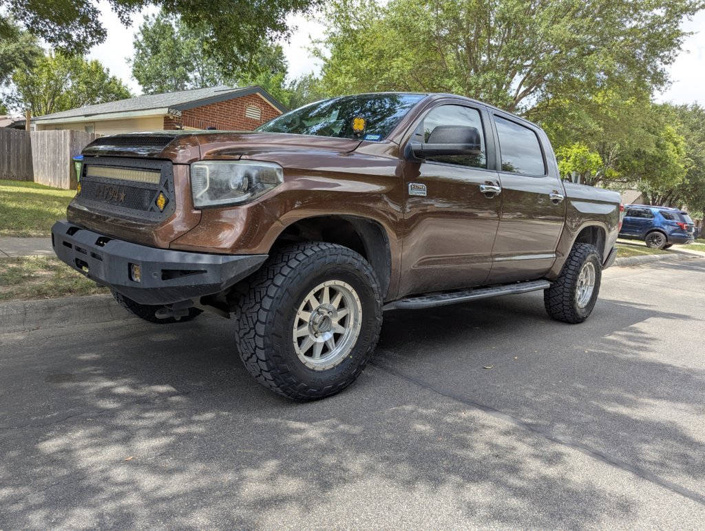

    Picked up some SPC UCAs a week ago for installing 37s. Been running the 295/70/18 ridge grapplers for almost 70k miles. Switched to the Toyo RTs due to the cost of the ridge grapplers being almost $100 more per tire. Took a little work but they fit. I do need to reroute some of the rock light cables and heat up the plastic at the fire wall area, as the tire just catches plastic. Also need to cut the BMC more aggressively, just catching it at full turn. Added a shim to the driver side for the driver lean too.
