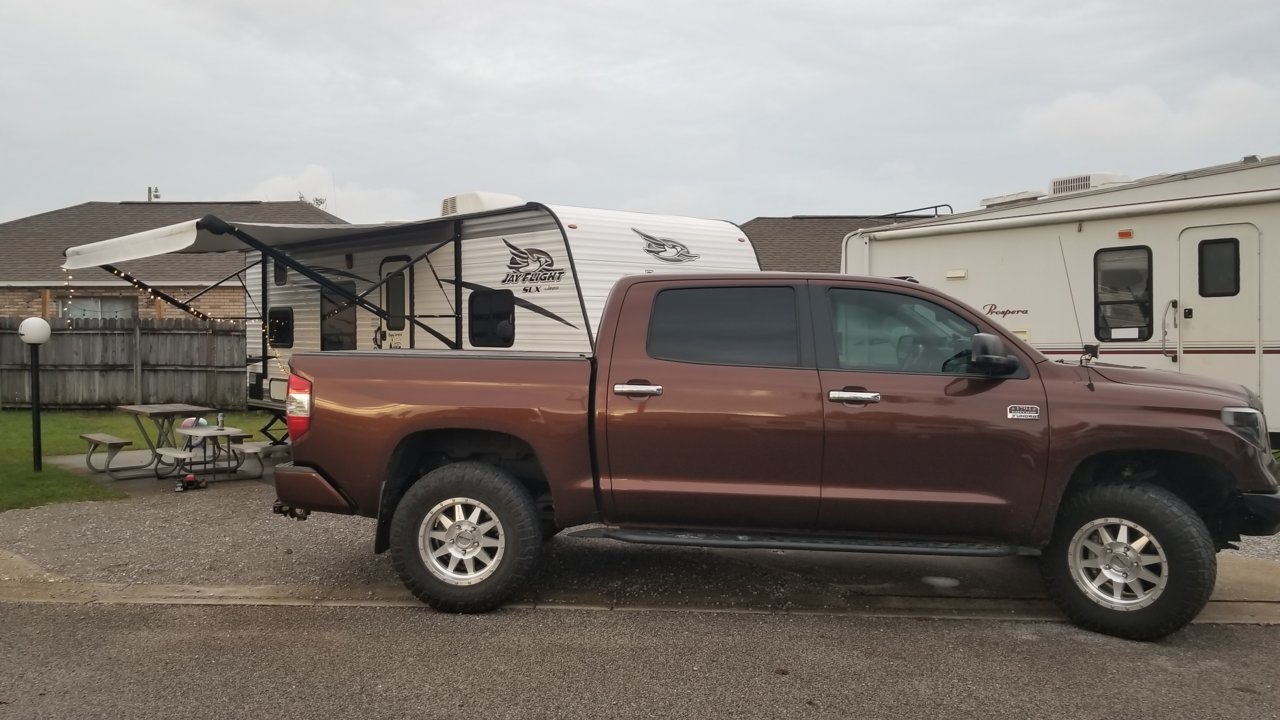

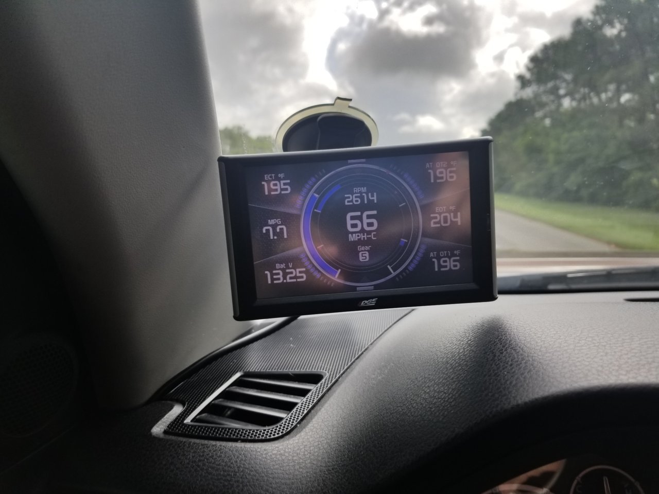

    Drove the camper 800 miles to Navarre Florida for a mini isolation vacation on the beach. This was the first long stretch towing since installing the 529 gears. Truck pulled well, was able to run in 5th on the highway since i only have 34" tires. My rpms in 5th is almost identical to 4th gear with stock gears. Trans temp stayed around 197 the entire way.
