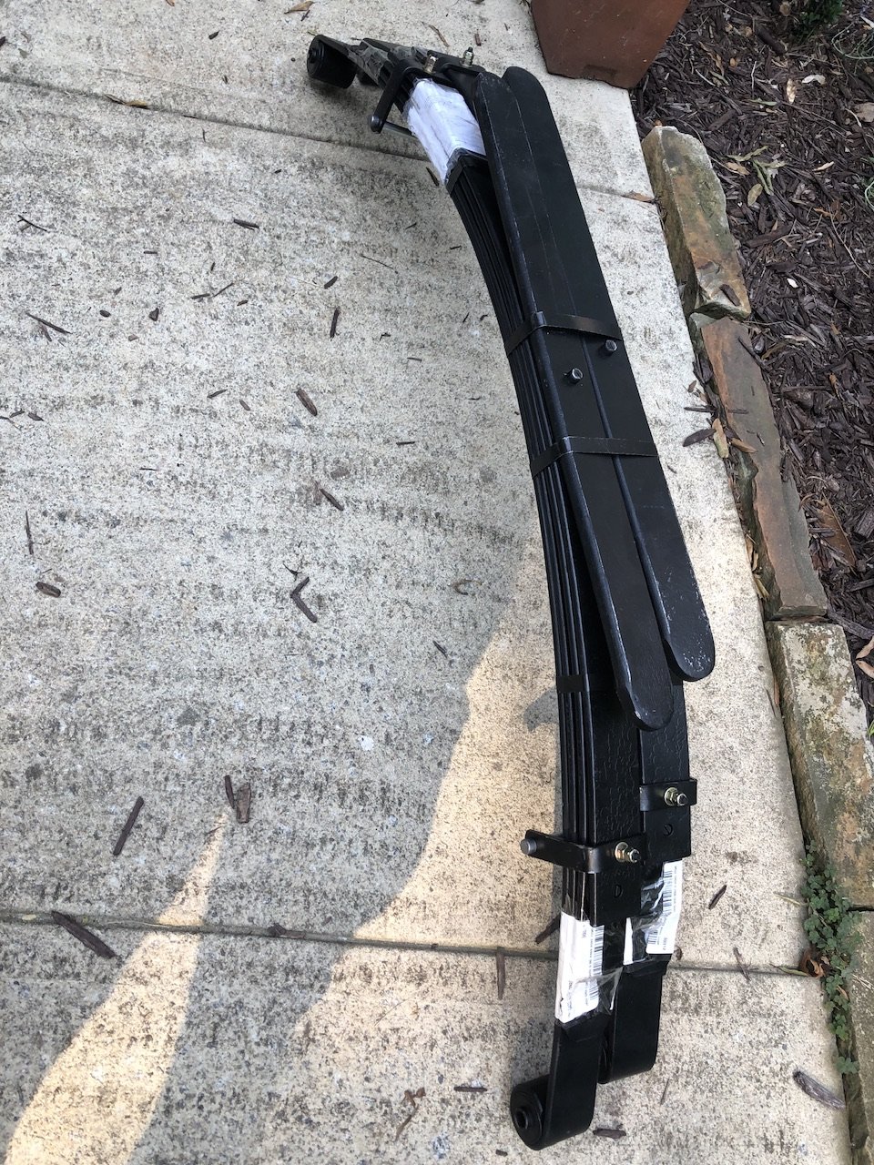

    ATS 90-221HD leaf packs gave me almost dead-nuts 2" over stock height.
    $500 after tax for two (universal) leaf packs, shipped to my door. https://www.autoandtrucksprings.com...vy-duty-rear-leaf-spring-both-sides-90-221hd/
    I also have an access cab V8 4WD. The general spectrum of lift folks have gotten from this exact same HD leaf pack is 1.5"-2", independent of cab. Haven't seen anyone get any more nor any less than that range.

    Not bad. 4 leaf pack with overload? Any idea if these are by chance the same as the HD leafs from general spring KC? They have same part number (90-221HD) and price.

    Considering ATS makes the springs in-house from their warehouse of misc leafs, they're the likely source for GS KC.
    ATS used to make the same part for Dorman as well, based on digging I'd done prior to purchase.
    And yes, 4 pack with overload. Lemme grab you some pics.

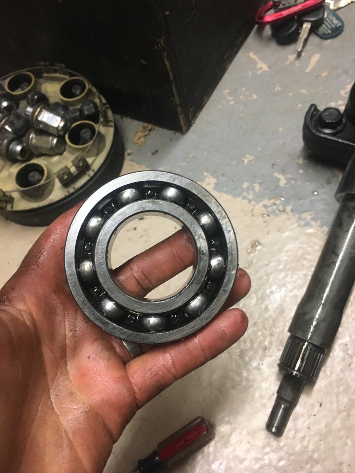

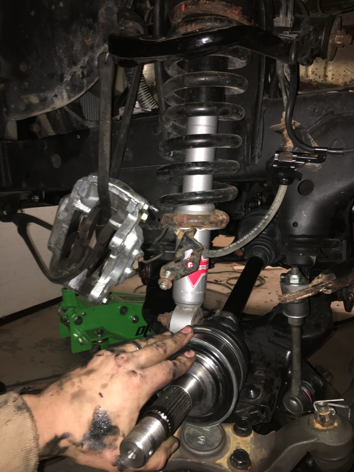

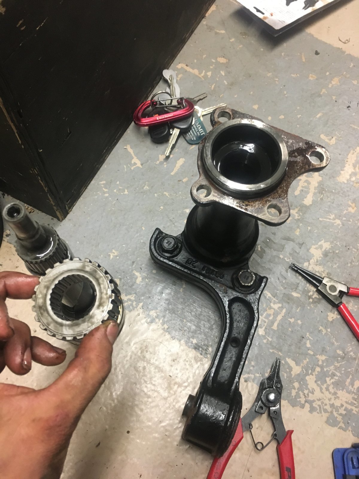

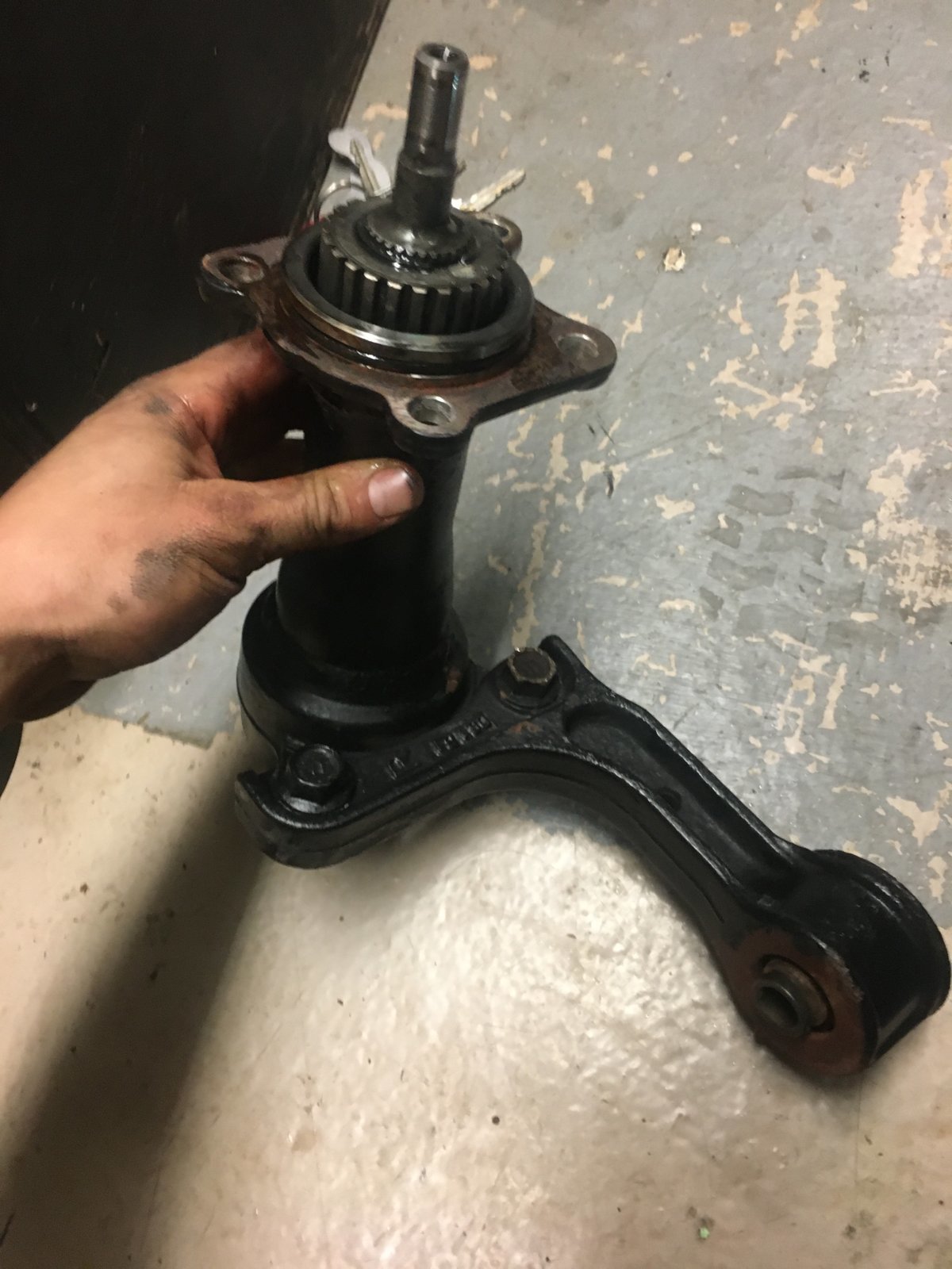

    Biggest frustration and triumph from the last few months was tracking down a leak at the passenger side of my diff where it meets the cv axle. I replaced the axles early in winter, along with new seals, but could never get the passenger side to stop leaking profusely. I must've disassembled and reassembled that shit at least 15 times. At one point I even replaced the bearing that the inner shaft rides on, thinking that must be going bad and allowing fluid by or something. I was really stumped and eventually I just resigned myself to the fact that it was gonna leak and let it, figuring I'd replace the whole diff if it blew up, which it never did. With help from here, I finally realized that I simply needed to set the seal at the outer edge of the diff tube, as opposed to the inside, and it hasn't leaked since.
    Inner shaft bearing replacement:

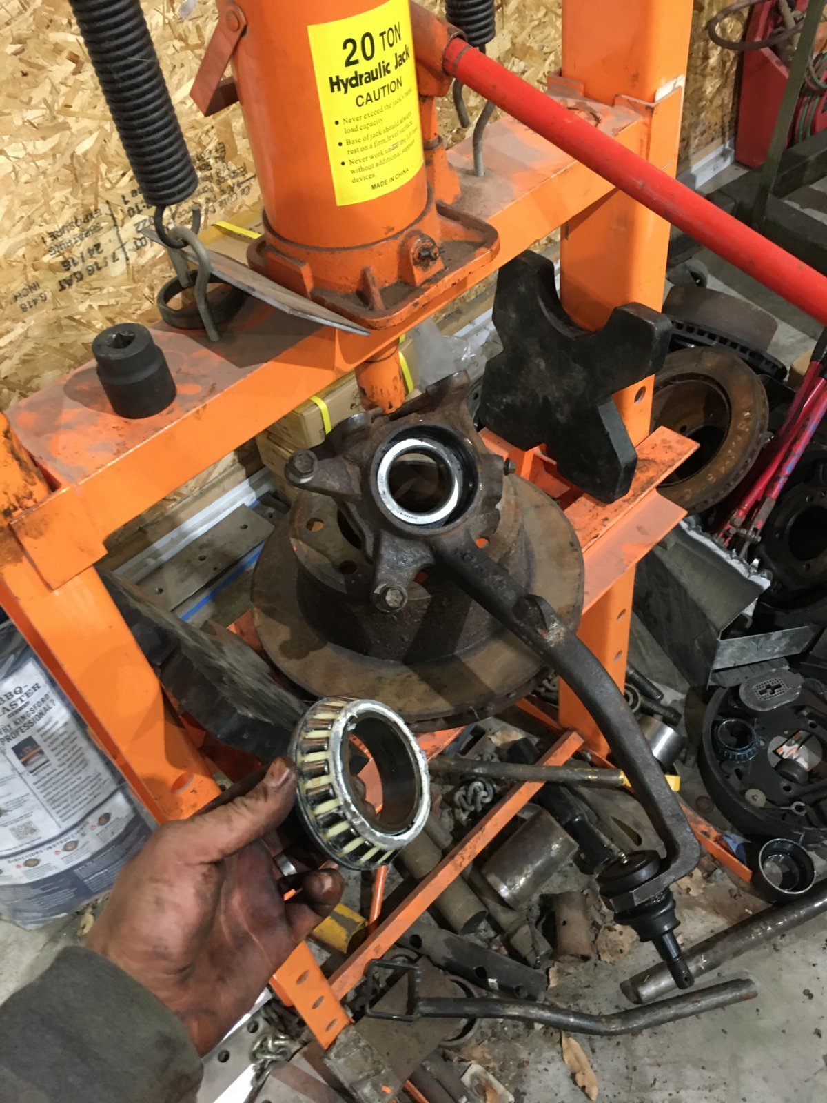

    Wheel bearings were pretty easy, if I recall correctly, I was able to press everything out and back in in less than an hour. Having a press at work and a balljoint set was really helpful. The old bearings were screaming and one of them fell apart upon removal of the seal.
    Installing the new CVs. Initially, I was planning to do the extended CVs or rebuild my oems with high angle boots, but got this set super cheap from the RA, like 25 an axle, so decided to run it. One has a torn boot again already, the other seems to be holding up. I'll revisit this at some point.

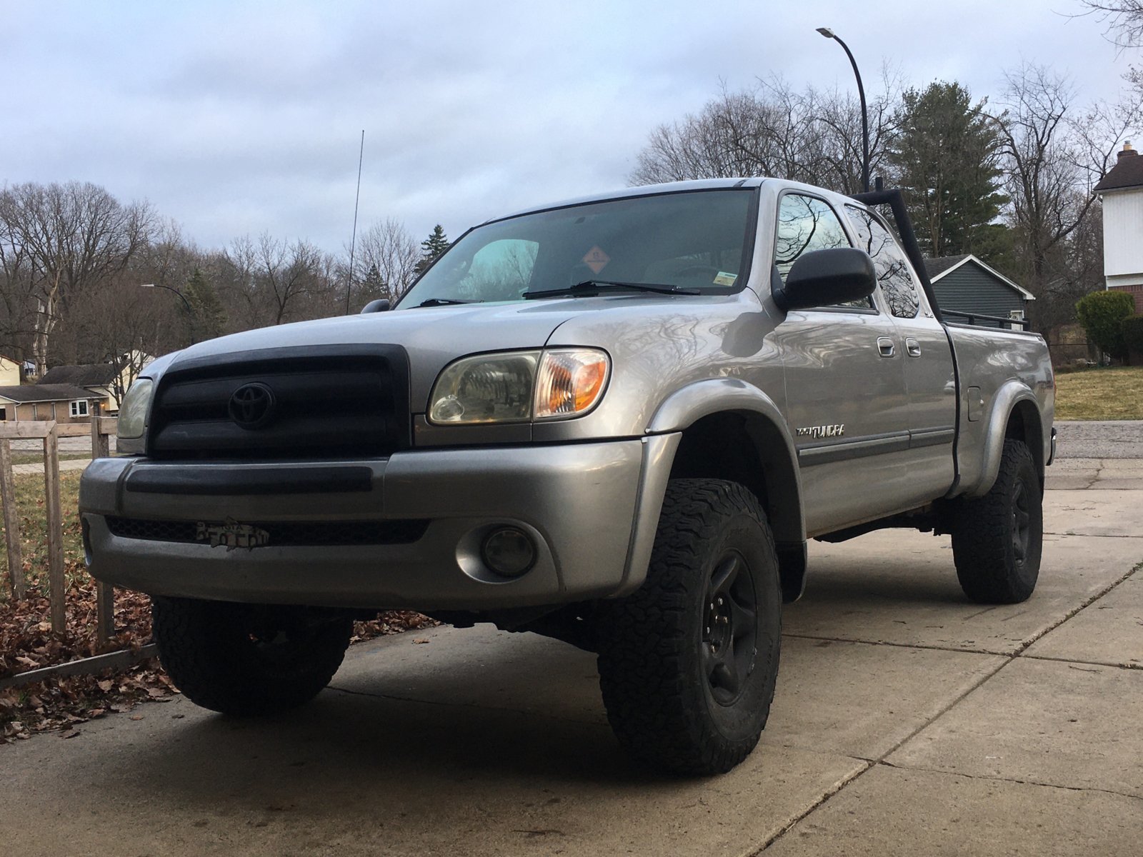

    After installing a basic rough country lift kit on my brother in laws' tacoma at Christmas, I decided to just get some cheap blocks to level out my rear and hold me over until I can afford to go for an HD pack or have the time to build a bastard pack out of the stuff I have laying around. Got a 1.5" block for like 30 shipped and had them installed in less than half an hour start to finish. Already had some u bolts and wheelers universal bumps lying around. Eventually I'd love to revisit the whole suspension and go with a decent coilover, arms, and rear packs, but as it sits it's fine and it meets the all important budget.

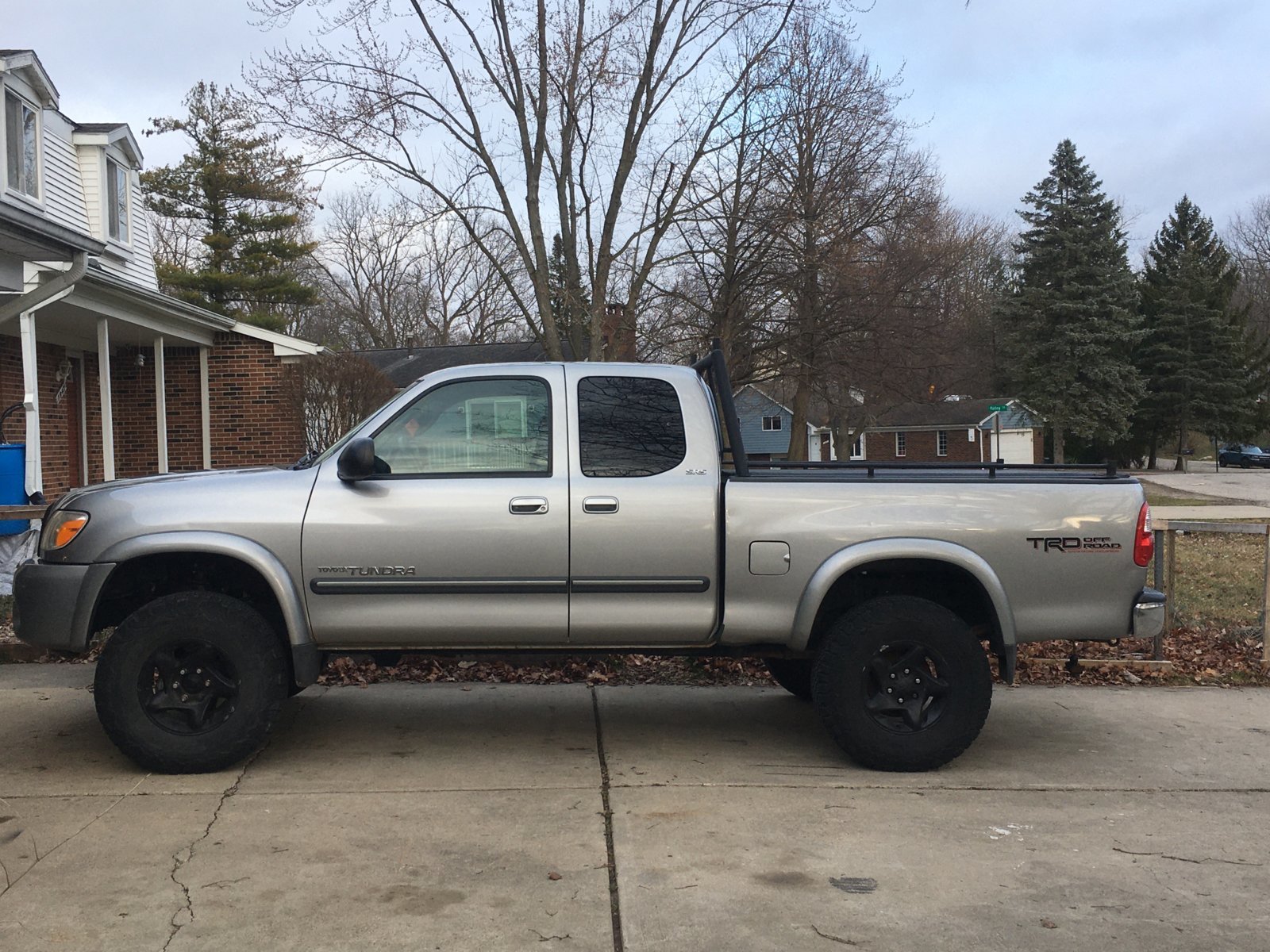

    Here's how it sits as of today:

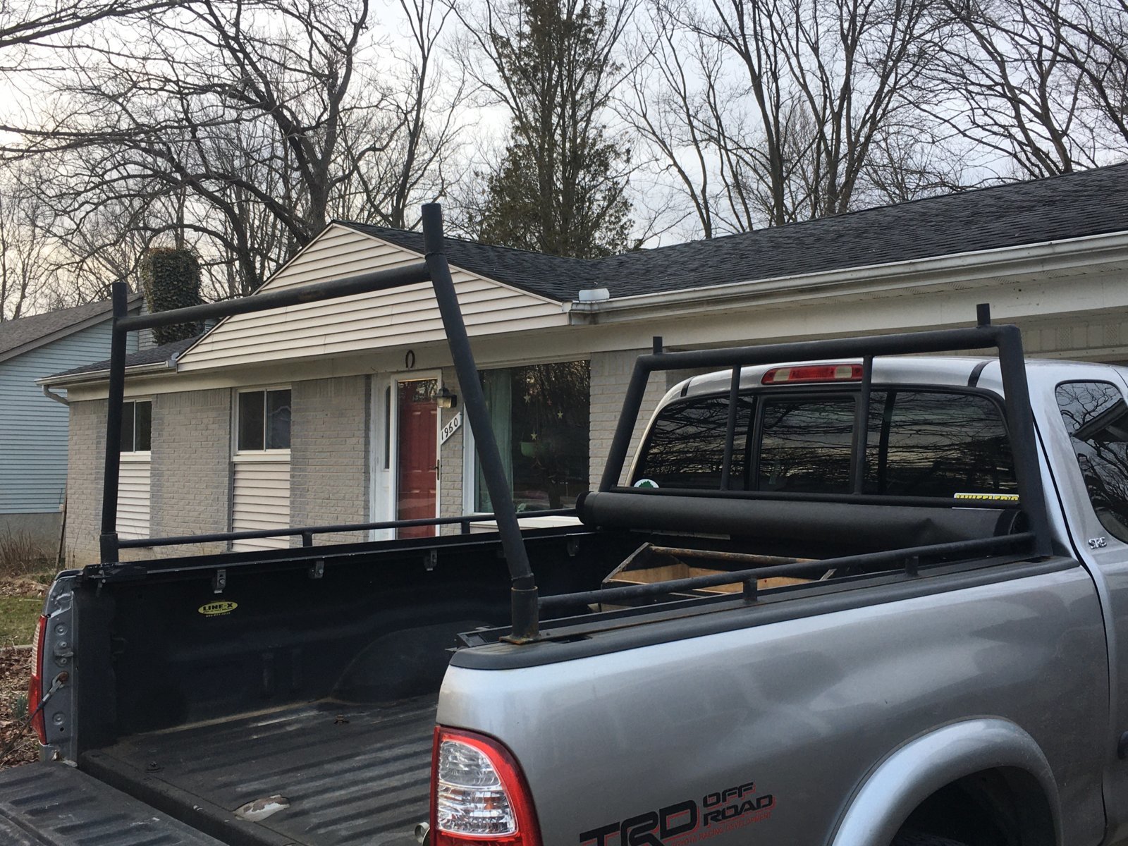

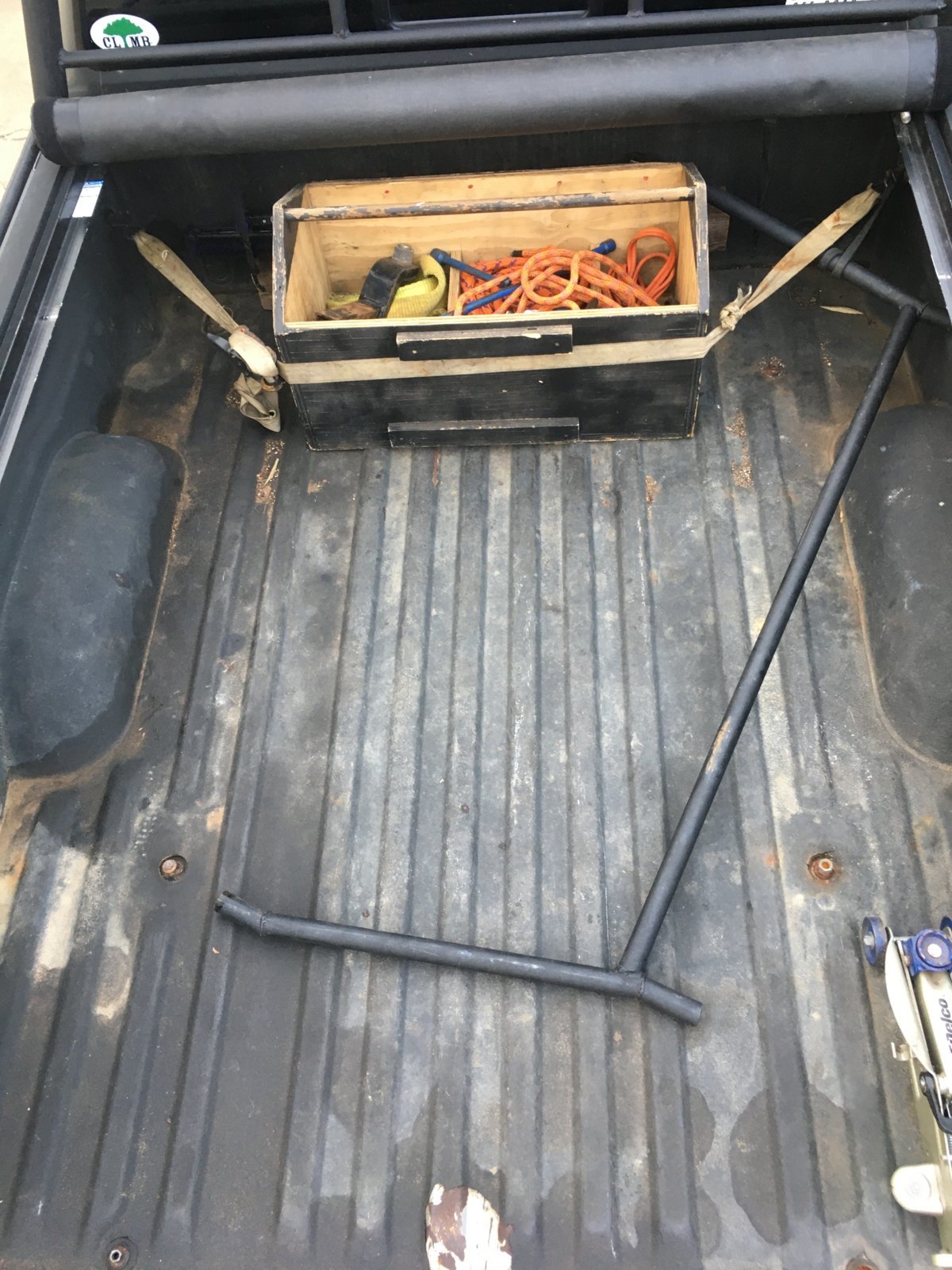

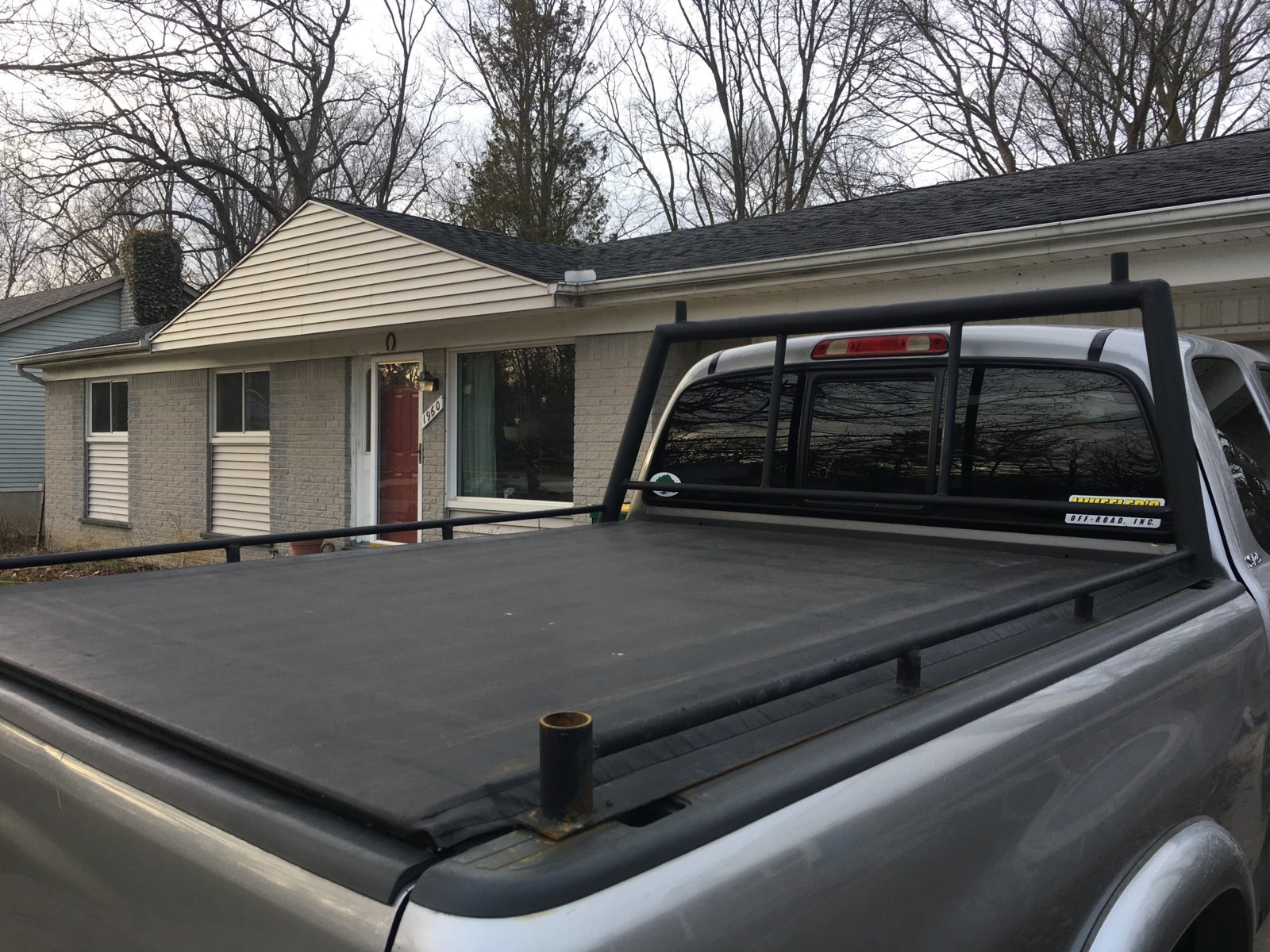

    Also recently got my headache rack mostly finished up. I'd still love add some mesh to protect the windows, and maybe build in a space for some work lights, but maybe down the road. I've also been looking for shells so we'll see how long I stick with this setup. I built it in a pinch as I needed to haul some 20 ft lumber at the time.
    The design is such that the rear rack can be removed and stowed when it's not needed. I'd love to a bar over the roof as well, currently I've got got a temporary setup for long material that leaves some to be desired. Something purpose built would be better. I have some tracks from a 4runner laying around, but am hesitant to do what's needed to install those. May go inno down the line.
    Here is the rack. Made this with schedule 40 pipe I pulled out of the dumpster for the most part.

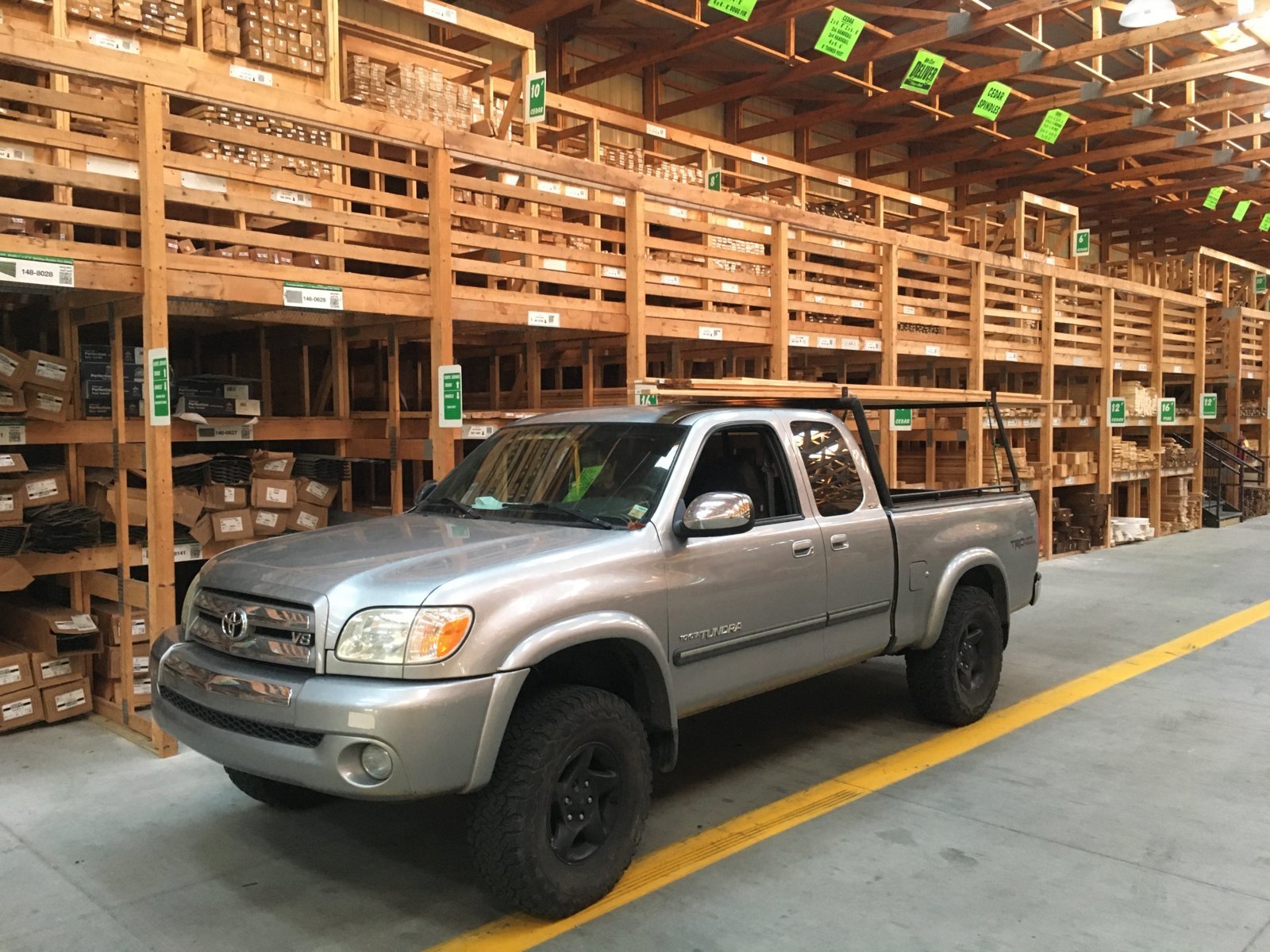

    Last post for now - just to show that it actually leaves the driveway here is a pic of the rack in use awhile back.

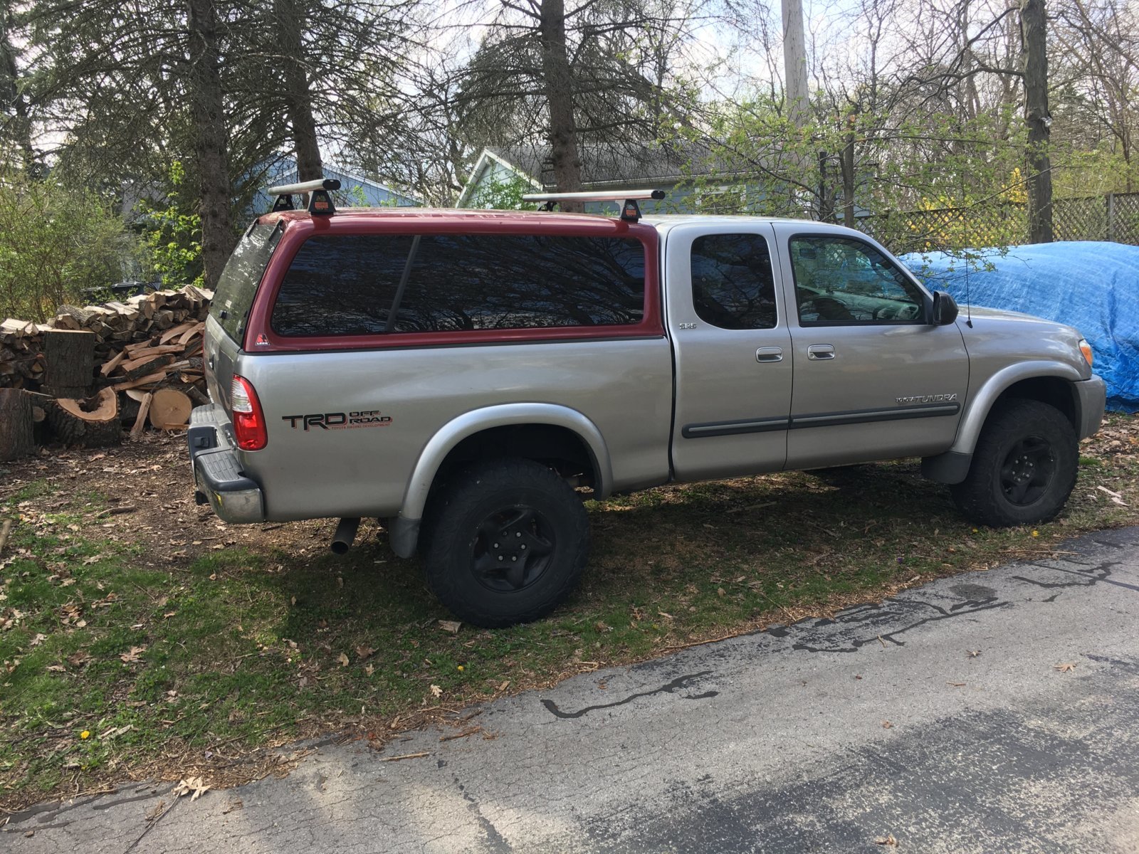

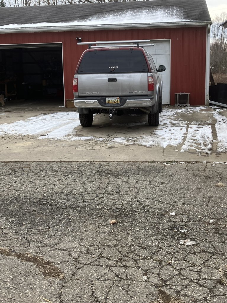

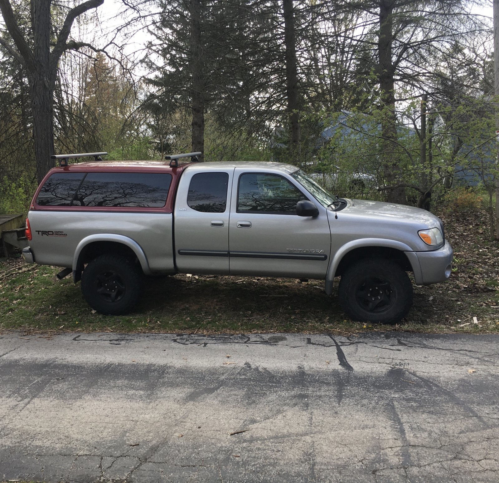

    Well I've been looking for a cap for the truck for awhile. Last week I was doing my daily scrolling of my wife's marketplace, and I came across one for $100. It was 5 hours away and there was only one bad picture, so I ignored it. Then saw @The Black Mamba post it up in the first gen camper shells thread and now it was free... so I checked it out and the seller seemed legit. Talked to my wife and it was on the way to her folks place, so we decided to go for it and make it a weekend. Seller held it for us and was super cool and kind. She was military, moving to a different city, and had sold her truck and just wanted the cap gone. It's a Leer 100xl with all windows in good shape. Needs new struts and new seals on the rear window, but I'd say it was a great deal at the low low price of free. Also has racks on top which is a must for me, and I don't actually mind the red.
    Hoping to fix the little things and build a removable platform and low-pro bedslide. Anyway, enough words:

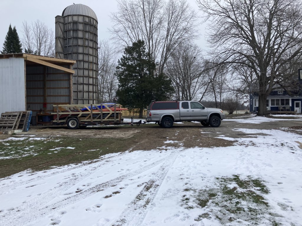

    I picked up an old 7k tilt utility trailer that was going out of service at work, and have been towing that around some. We built some sides onto and used it to haul a fairly heavy load during the move. All loaded up, the truck hauled it well at 55mph with the OD off. But boyyyyy do I need some of those ATS HD springs. Or maybe even the archive garage heavies, now that I will be hauling more frequently. Or maybe, if I have the time at some point, I'll throw in some scavenged junkyard leaves I've been kicking around. But basically, it's riding on the bumps loaded down.
    Anyway, here's some photos, since that's what I always like to see myself...

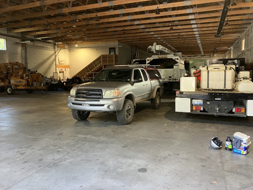

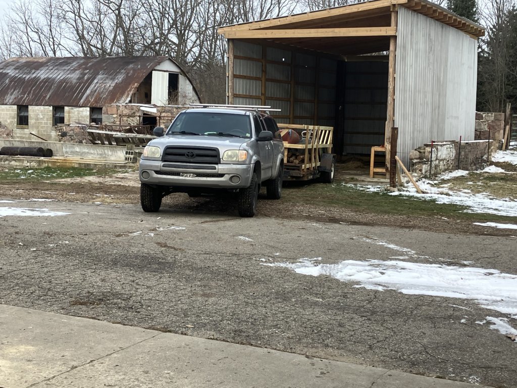

    truck in the shop at work, old tires
    New tires, unloaded
    Trailer, loaded

    I trace the wiring on the truck, looking for loose or broken wires, or anything unordinary - nothing shows itself. I add a redundant ground from the ground wire on trailer plug, to clean body metal. Problem persists. I add a redundant ground at my tail light, thinking maybe something happened when I positapped it for the camper shell (brake light and signal are same wire on trailer). Problem persists. I run a jumper from clean metal on the trailer to clean metal on the hitch. Problem persists.
    I replace every fuse to do with signals and lights, as well as all fuses to do with towing/trailer on the truck side. Problem persists. Thinking maybe it's something to do with the flasher relay on the truck and the led lights on the trailer, I swap trailer signal/brake lights to halogen. I'm thinking, maybe led isn't giving the correct resistance, and pushing through to the other signal, idk. In this case, signals stop working entirely, and all other lights flash instead (WUT). I ground those directly to clean metal on the trailer, and try several different combos of wiring, nothing makes a difference. I return to the led lights, things work as they were before.
    I try my brother-in-laws trailer with a 4 pin connection (4 pin on the truck is tapped OFF OF the 7 pin). Everything works, signals work, as well as all other lights. Confounding.
    At this point, Im stumped. I think I'm leaning back toward the trailer having a ground issue. And the other trailer I hooked up to at work also having a ground issue, leading me to point towards the truck as the common denominator. I would consider just rewiring the trailer with a 4 pin connection, but it has a brake on the axle, and I plan to haul some heavier equipment where trailer brakes would be nice.
    Anyways, long read, not entirely truck related. Anyone have any ideas??
