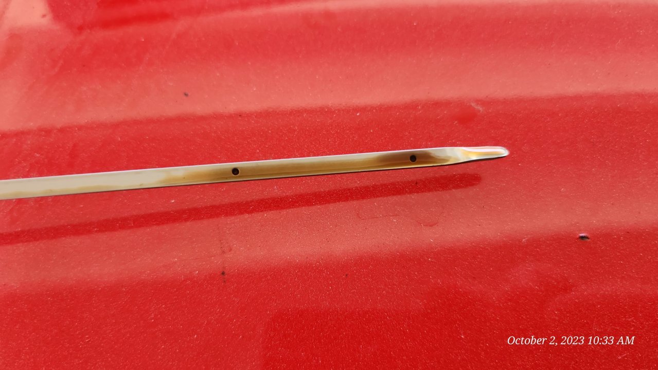

    Takes a dipstick to design a dipstick I guess. After sitting overnight, wanted to get a baseline of oil level. After 3 pulls and wipes, still can't tell. WTF! Crystal Ball anyone? How would you ever know it's low?
    Oh yeah, the main bearings would shit the bed.
    For reference, I changed at 5k, have 3k on dealer oil change now, that was done at 10k.

    Seems overfilled to me. Should be between the two dimples in my view.

    How’s the other side look?

    If it's been sitting all night, it's definitely overfilled.
    That's a lot of oil:cheers:

    Started it for several minutes, let sit 15 and checked. Still appears overfilled but I'll take it for a drive to full temp and recheck it. Yes one side is useless to check, thanks for mentioning that.

    Looks like the manual wants it checked at operating temperature which I have never done. I have always check it cold on any vehicle I have ever owned so guess I will have to try it this way.

    The dipstick reading should be between the 2 dimples. Top dimple, and your overfilled.

    Lightly sand the dipstick crossways. It helps.

    Dipstick is indeed useless. The damn thing is 10 feet long and by the time it travels up the tube, oil gets smeared for an inaccurate reading.

    Horizontal across the stick if it is standing on end. Create grooves for the oil to “rest”on. I did it from the very bottom to an inch above the full mark.
