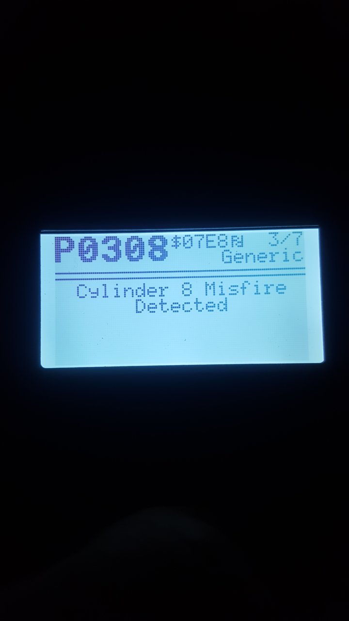

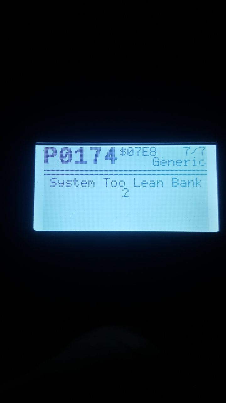

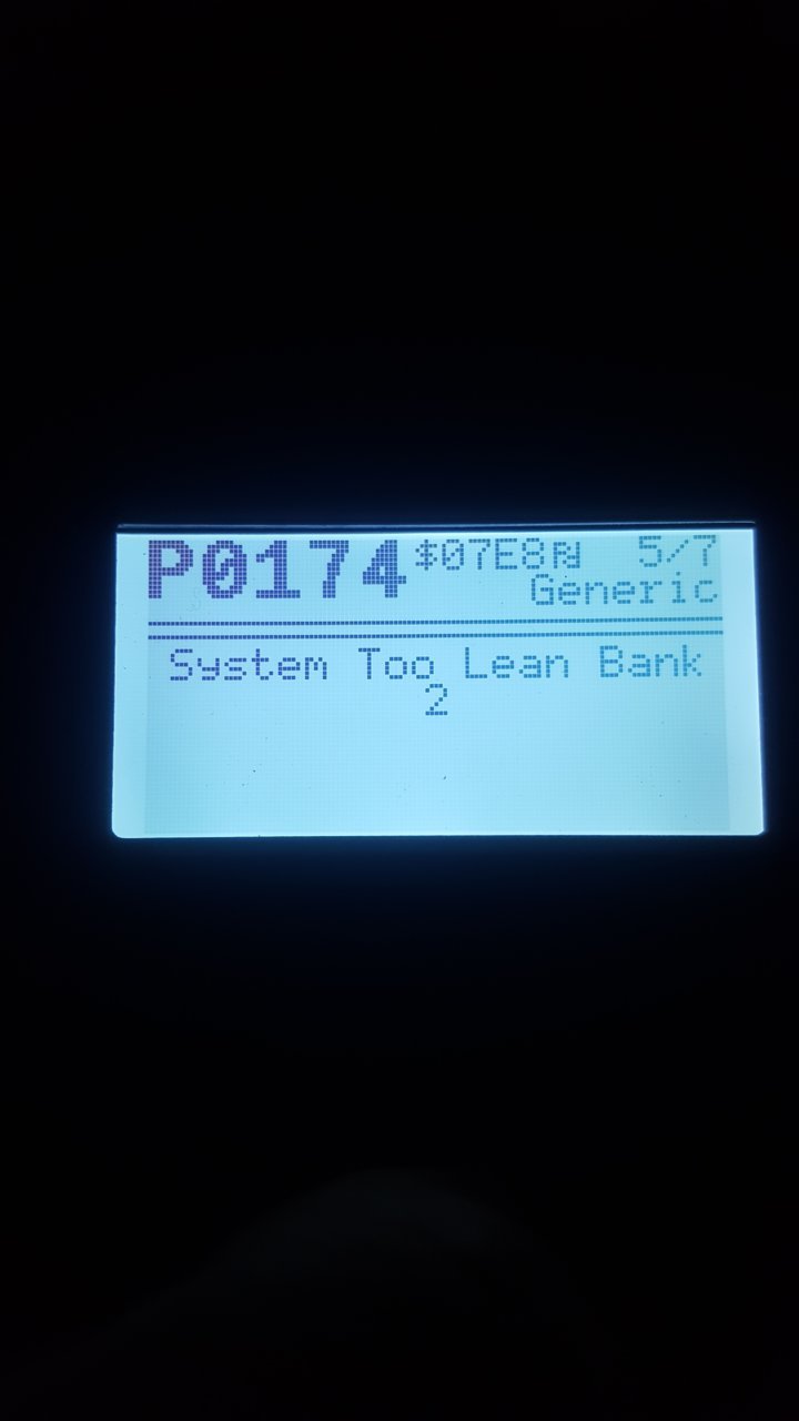

    Here are codes I'm getting only thing I did to the truck was change air filters I changed it from a Napa gold filter to a cheap one from Amazon. I'm lead to believe I need to clean the MAF or change spark plugs but maybe someone here has some better insight.

    Sounds like your MAF is dirty, especially since you just went through some mud. Clean it with some MAF sensor cleaner.
    Other suspects could be a vacuum leak or some sorts. This can cause lean situations.

    To further on the discussion, if the simple troubleshooting doesn’t work, may be a faulted O2 sensor, but since both banks are lean, might not be a good indicator.

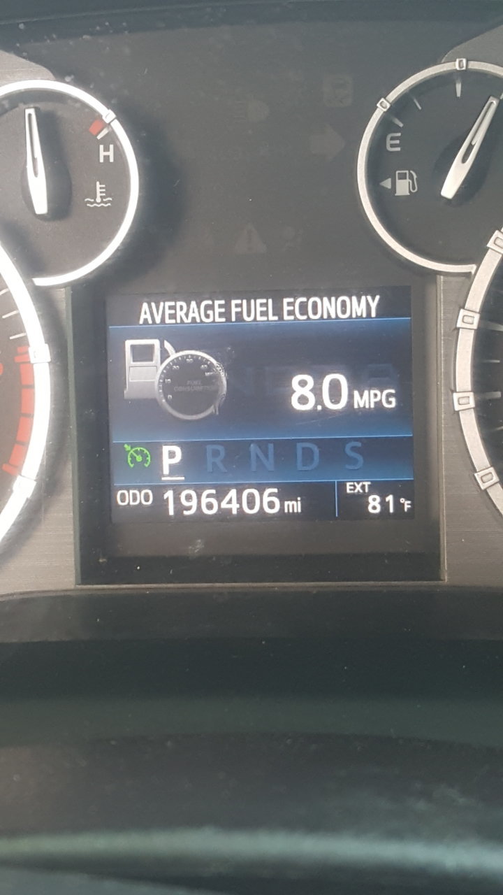

    Just did 110 miles pulling my dump trailer empty at 65 mph. I averaged 7.9 on this route I normally average 10 but that may be an unrelated factor. Under load the truck seems to fall on its facing trying to maintain speed. Usually it stays around 1900 rpm I was staying at 2100 and it wasn't hitting 3k rpms going up hill like it normally does. It's alot better than before. Before I was having a hard time maintaining speed pulling my flat bed empty at 65mph

    For some reason my mpgs will not go past 8.9 towing now. But it might be totally unrelated. 100 or so miles so far doing good. It shifts pretty good still had one hesitation so I'll he watching it and taking it easy.

    Little update threw the p0171 p0174 bank 1 and 2 lean code again. Cleaned the maf went away for 903 miles now it came back and now the truck is having hesitations while being under load. Cant find any vacuum leaks. Idles fine. Debating changing the maf sensor next then the o2 sensors. Hopefully its not a fuel pump.
