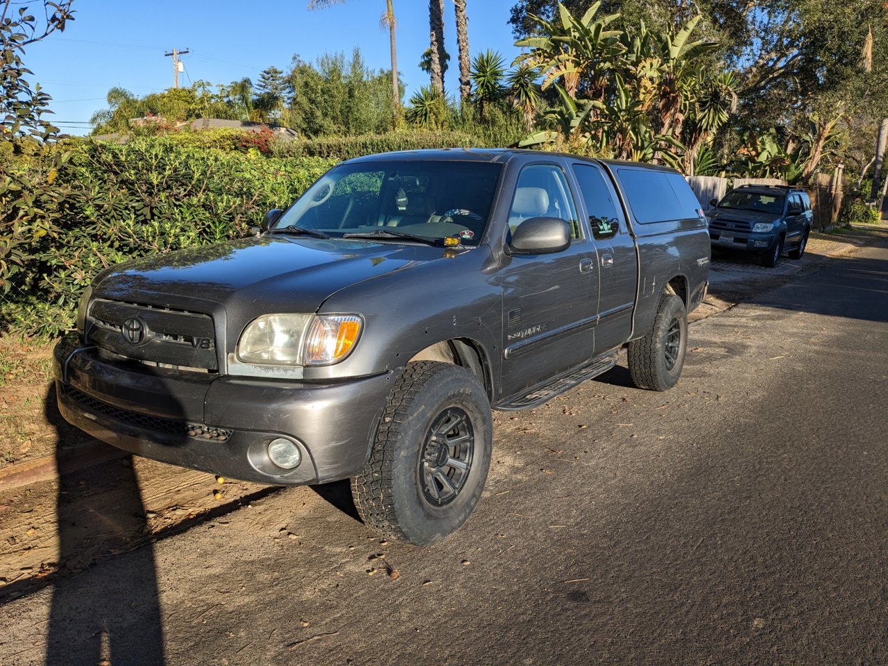

    Hello all. I intro'd myself in the New Member thread, but thought I'd get in front of you first gen enthusiasts.
    I am now the proud owner of my son's 2003 access cab limited 4x4. Why do I now own it you ask? Well the timing belt decided it had had enough and took the rest of the motor with it. I helped him get a new truck and took this one in exchange. This will be my second first gen, and third tundra (2002 and 2013 previously, to go along with a couple of land cruisers (84 and 89 I used to be around on ih8mud) and a couple 4runners over the years).
    I'm trying to decide what to do with this one. It had over 300k miles on it, so needed some stuff even before the engine died (mostly it needed some brake work, a new steering rack and a front suspension refresh). I put it up on CL just to see what the interest was, and it seems like the market thinks it's worth maybe $2k. Fair enough I suppose.
    I'd be interested some advice about what it really costs to replace the engine. While I am fully capable of mid level wrenching, I don't think I have the skills for a swap, let alone the space or tools. I really like this truck, but I'm trying to decide if the economics make sense.

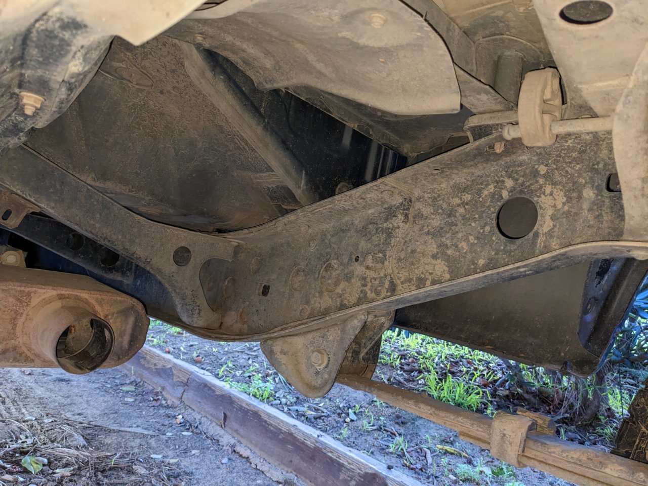

    How's the frame, as far as rust goes?

    By the way, I was asked about frame rust. This one is surprisingly essentially rust free, which makes me want to keep it.

    Wow, that is a really nice frame. I would definitely do it with a frame like that.

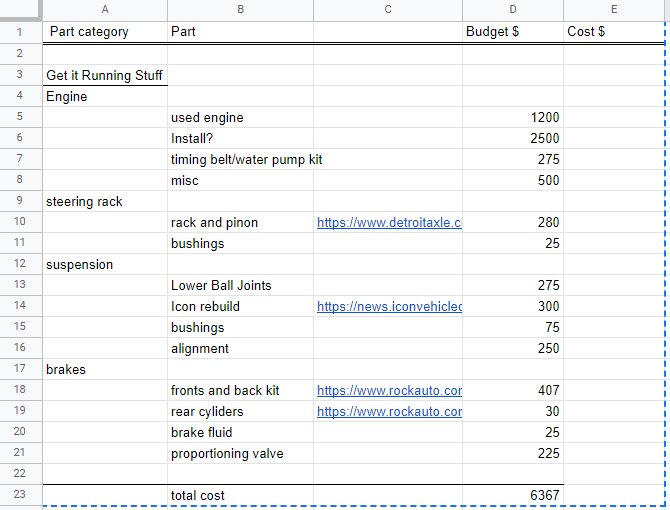

    So in the next month or so I think I will be ready to get started on this project. Figured I share my budget and what it ends up actually costing me. So far, I'm at about $6400 for what I think I need (this includes paying someone to r/r the engine. I might still this myself, but I'm kinda limited on space in my driveway). I'm sure there will be more. Here is the budget as it stands.
    With the engine, I plan to get one from a local junkyard. They seem to be around with less than 200k miles for around a grand. As it will be a mystery, and I try to learn from mistakes, I plan to do the timing belt and water pump while it is out of the truck for ease of access. There were a couple of suggestions for other things to do "while I'm in there" above. Besides new headers (unlikely due to being in CA) anything else I should do?
