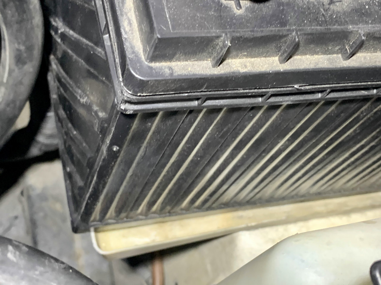

    Since then got some "updates". Bought a dometic CFX3 75 and a cover, replaced instrument lights with LED's and replaced the group 24 battery with a group 29HM I had for a troller motor.
    Had been thinking about getting a group 31, I remembered I had the mostly unused group 29 and figure why not.
    The footprint is much closer to a 27, has 675CCA and is rated 115aH.
    I think it will work. The battery bracket fits just right and though the terminals are backwards the car cables reach without tension. I did have to adjust the bracket for the loom coming from the engine.
    Below are picts of the installed group 29 battery, the second one shows how it sits on the OEM plastic tray.
