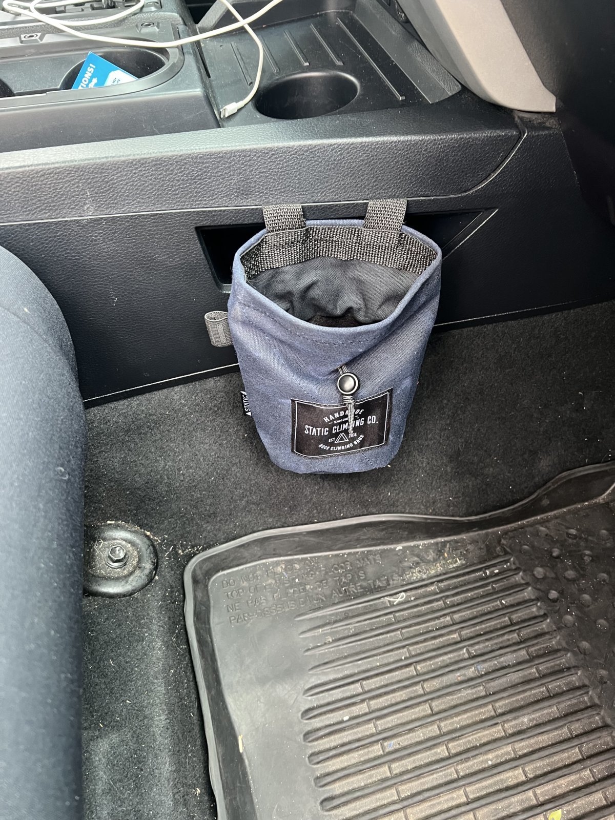

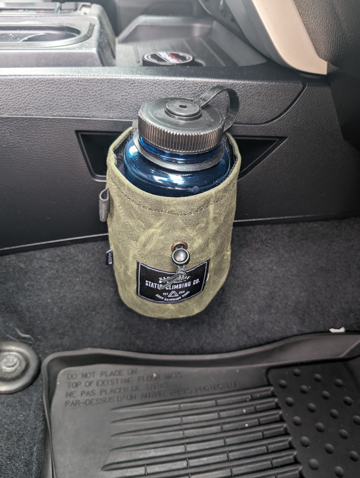

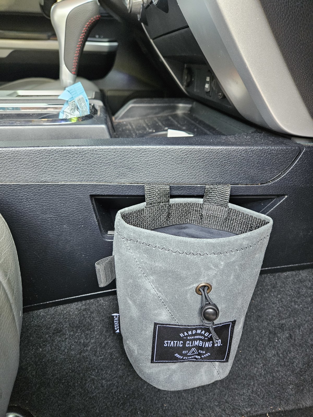

    Did this mod today - very happy with the results! Now those little cup holders are freed up for coffee and the chalk bags are for water.
    Anyway, did things a little differently. Cut the loops to form a single strap as suggested by the OP.
    Driver's Side
    - Started by punching holes with a hot nail, similar to the OP. Rolled up with zip ties.
    - However this seemed somewhat weak so I did it again except with a piece of aluminum stock I had laying around
    - The rod now lays under the plastic lip inside the console, seemingly should be very strong
    Passenger Side
    - Did not want to obscure the little 'cubby' since I keep some stuff in there
    - Wanted the bag right next to the seat, as on the driver's side
    - Turns out there's potentially interference with some of the plastic posts of the console cover
    - Decided to "roll up" the left strap. The aluminum bar was too thick, used a piece of a nail
    - Undid the screws holding the inner sections of the console to gain some play and jammed it between. Put screws back in.
    - On the right strap there's no room to jam the roll anywhere.
    - Cut the strap to the size of the inner plastic shoulder and used a hot nail to create a pilot hole, then put in a sheet metal screw
    - This is even stronger than the driver's side
    - Note: I cut a little relief into the strap using a hot nail assuming one of the console posts would hit it. This cut was not needed. (No interference when assembled)

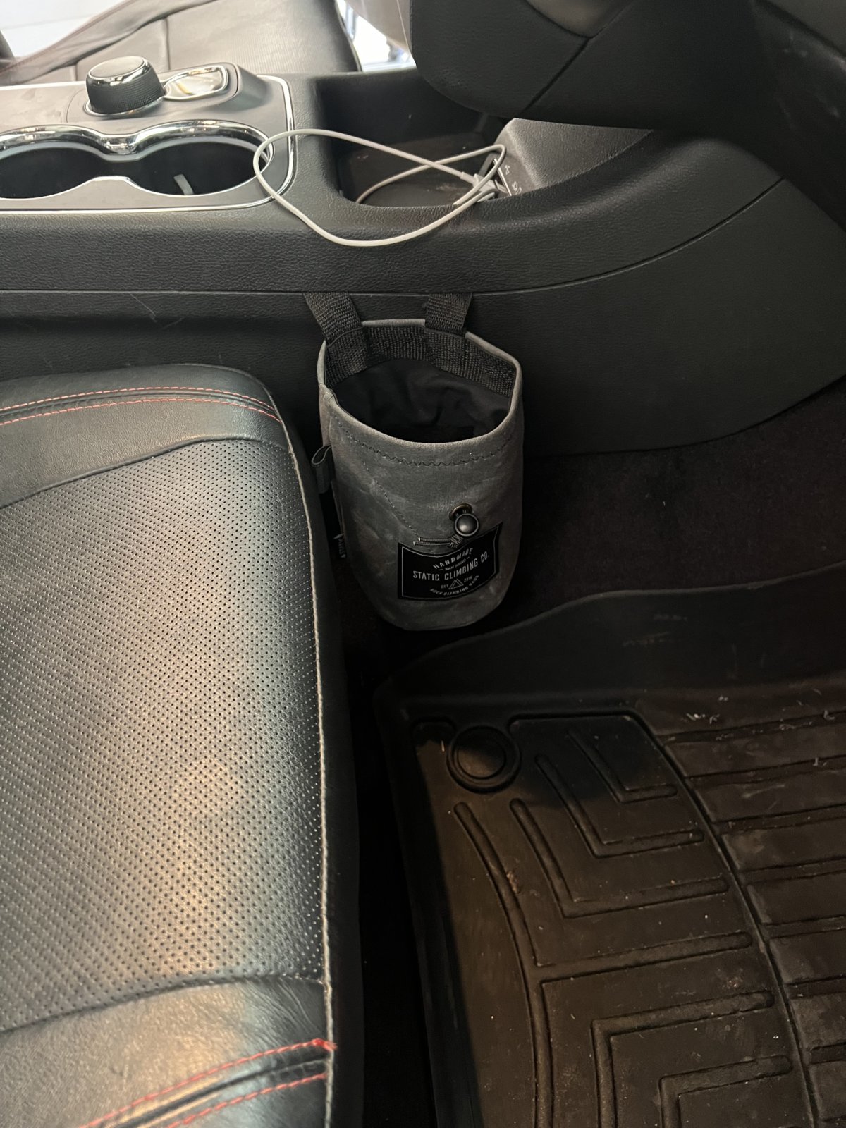

    Did it for the wife. Gonna inspect her Durango and see if I can do one in there also.

    I couldn't find a drill or a hole puncher, so I used a utility knife and it worked fine for making the hole big enough for a zip tie to fit through.
    Fits the big Nalgene bottle great, and also works great for the 28 oz Blender Bottle.

    Works the same in the Durango. I didn’t do an aluminum bar this time like I did on mine but it seems pretty secure.

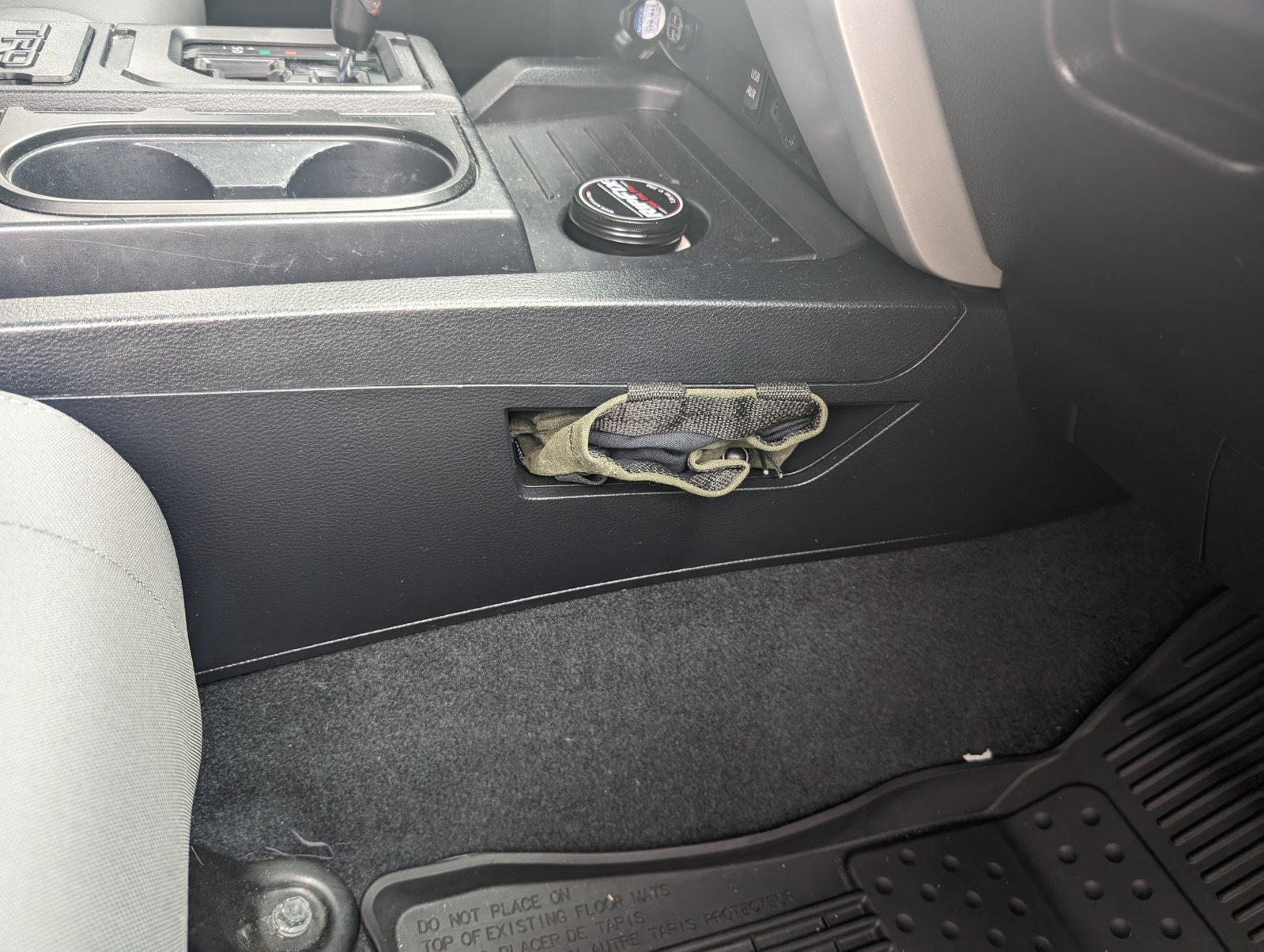

    Finally got around to doing mine! Finally have a spot for my Nalgene that works. Might do one on the driver's side too so the wife can put her obnoxious Stanley cup in the passenger side one.20240407_181540.jpg

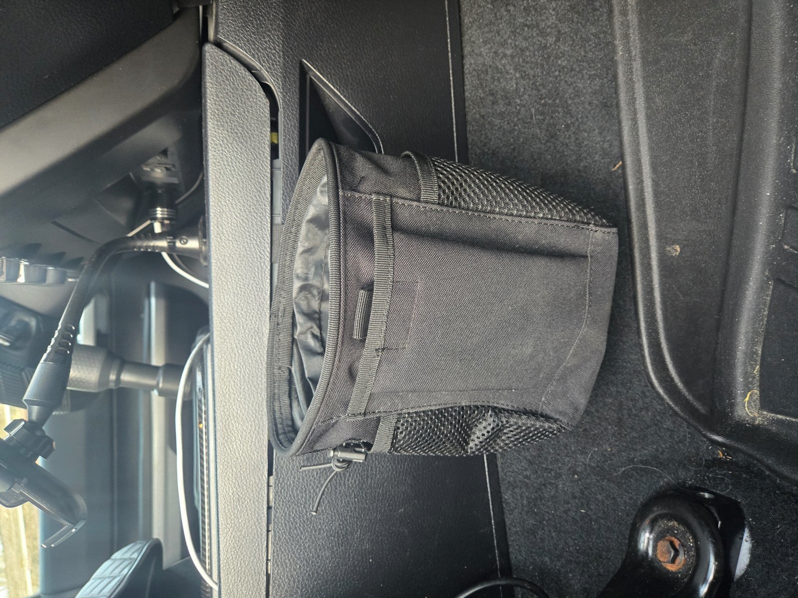

    Can anyone confirm if that tacticool option can roll up into that slot on the passenger side like the chalk bag can?

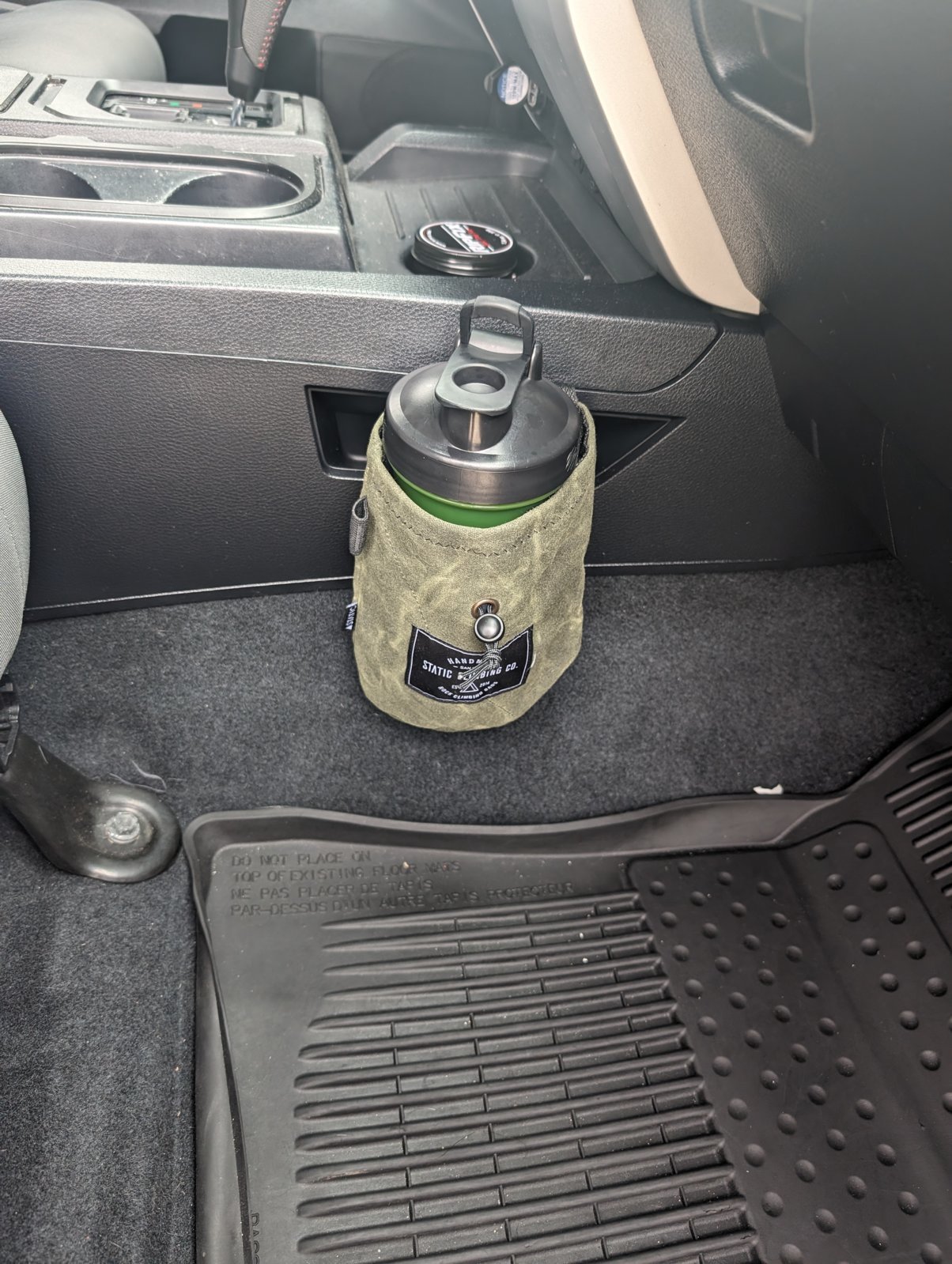

    Took this pic last night, the bag has been in for several months. Looks like I need to get the console seated back in.:rolleyes:

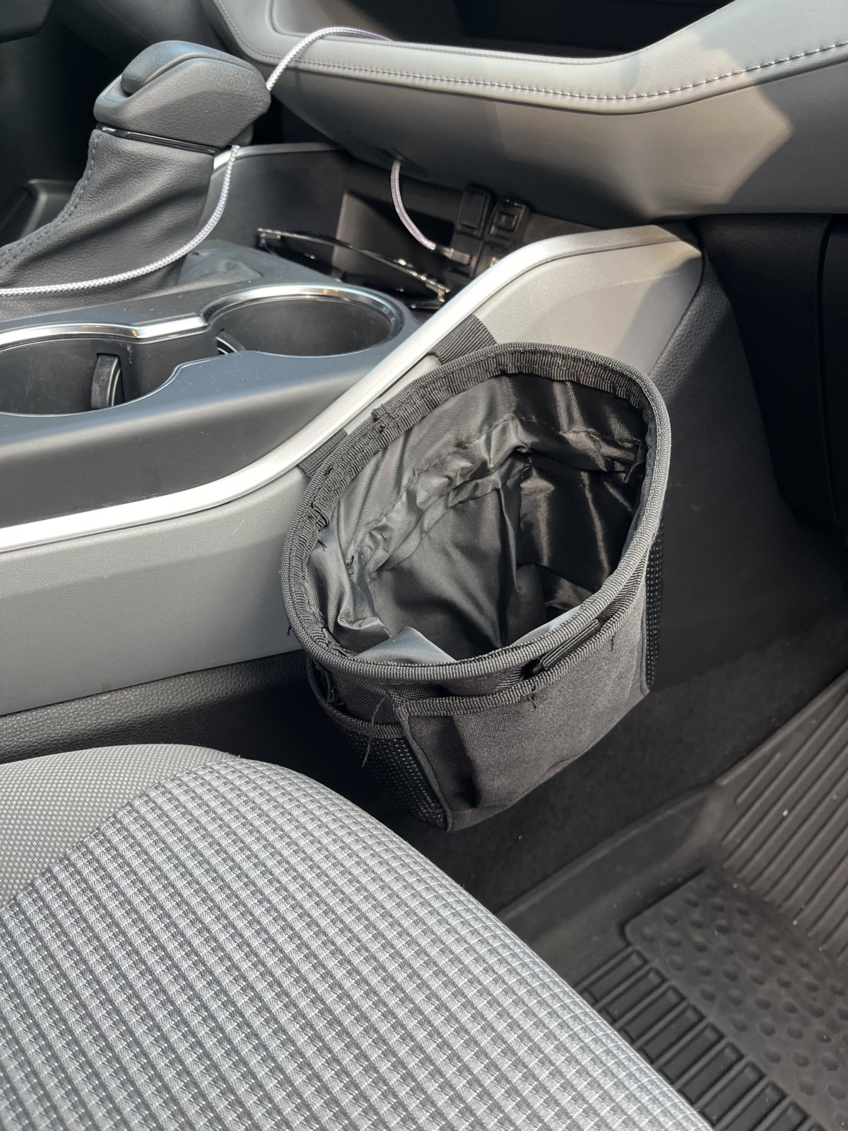

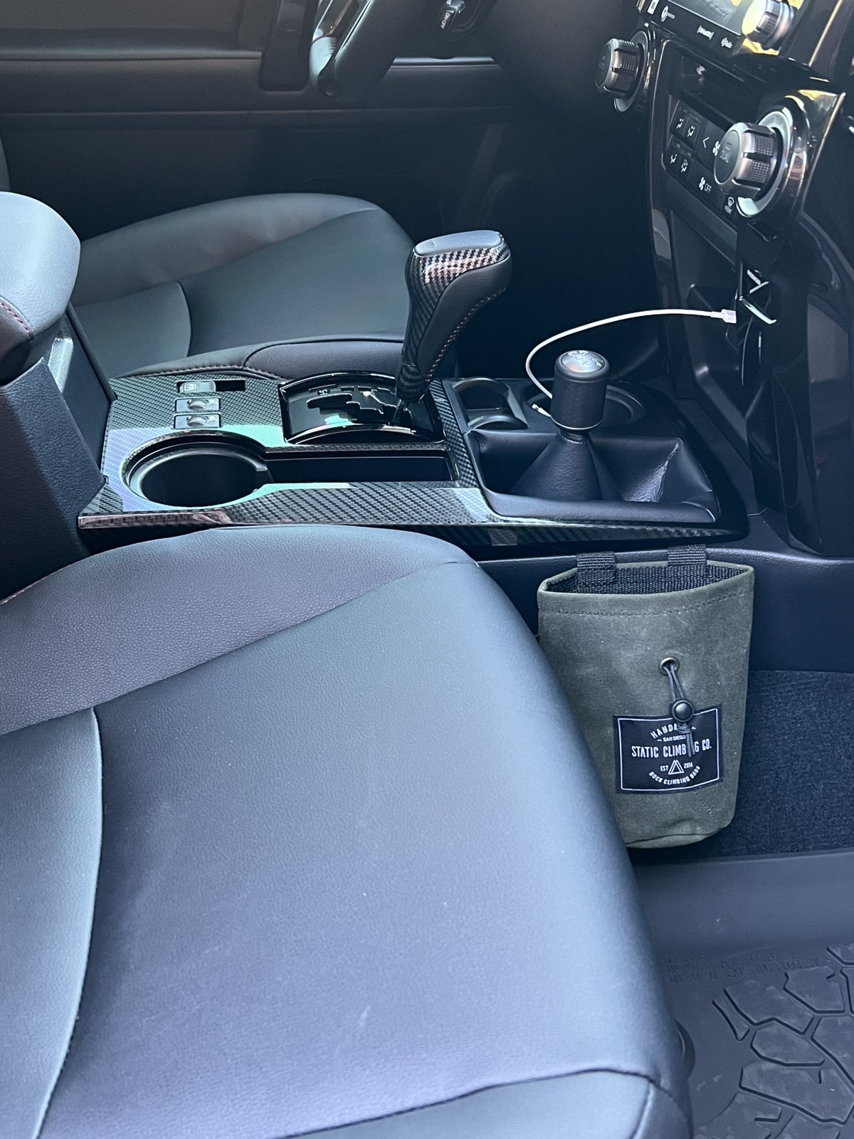

    Did the bag mod to my wife’s Highlander.
    Not so sure it will be for a water bottle, as much as it will become a trash can (which is fine, because this bag has a one piece liner)
    Either way, it fits nicely and is easily accessible from the driver’s seat.

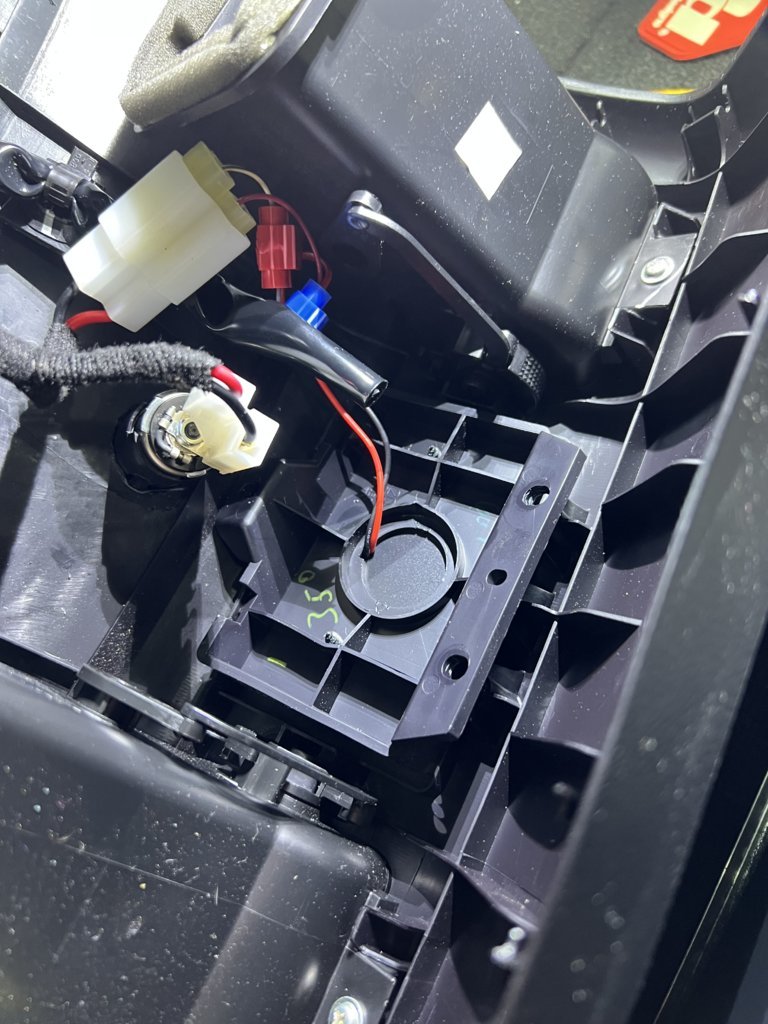

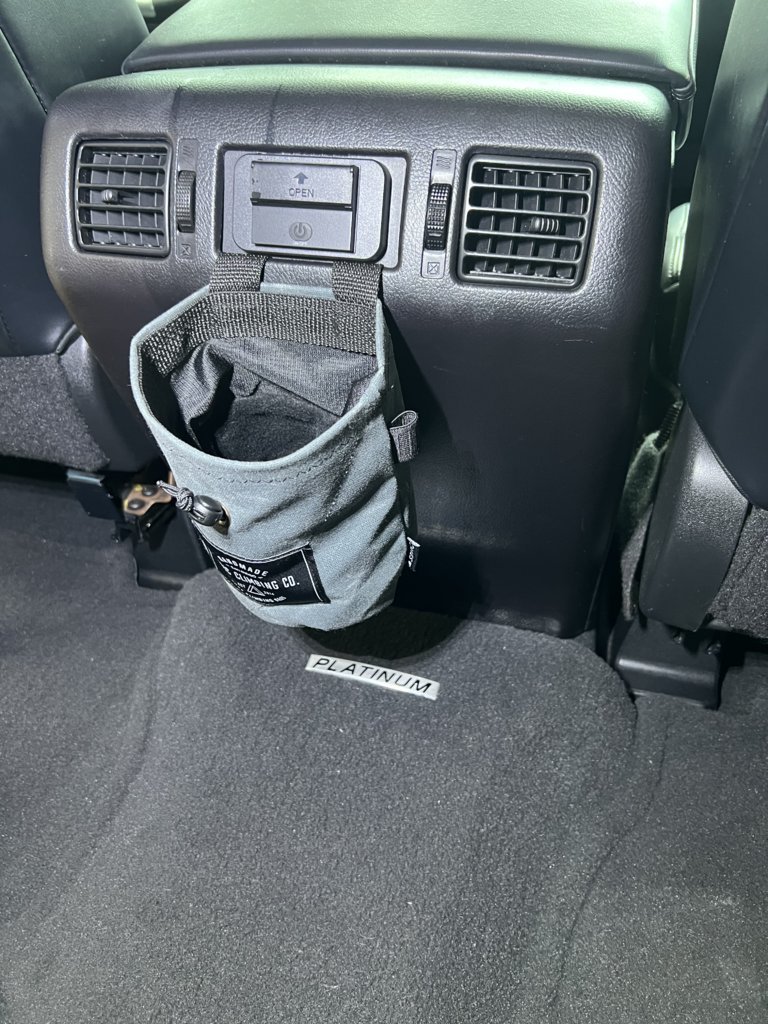

  22. Aug 26, 2025 at 6:35 AM
    #172
    subspd
    subspd New Member
    Jul 10, 2025
    #137702
    69
    Seth
    SW Florida
    2015 Tundra Platinum 4x4
    Magnuson Supercharger - TRD Exhaust - TRD BBK
    So this worked perfectly. Holds tight and adds a center cup holder for the middle passenger in the back or as a trash/stuff holder. Would work if you have the stock cigarette socket in place too.

    Some

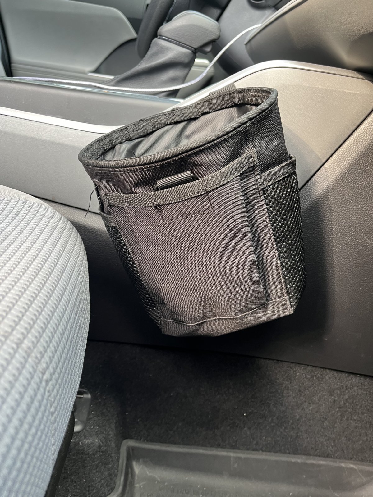

    I love idea of supporting woman making the bags herself but I did find a mesh drop pouch on amazn for under $7. The molle straps fit under trim the same way and fits my 64oz water bottle.

  26. Aug 26, 2025 at 7:58 AM

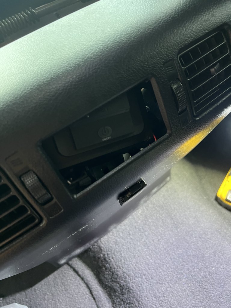

    How do I remove the stock cigarette lighter/ DC plastic panel? Is there a section I can remove just the rectangular panel with a trim tool or do I have to take apart the whole center console?

  29. Sep 3, 2025 at 6:21 AM
    #179
    subspd
    subspd New Member
    Jul 10, 2025
    #137702
    69
    Seth
    SW Florida
    The back panel comes off easily it just pops off toward the back. Start at the bottom. Then the power outlet panel has 3 philips head screws holding it on. Take those off and then you can easily mount the bag in place. Its easy to do and really handy!

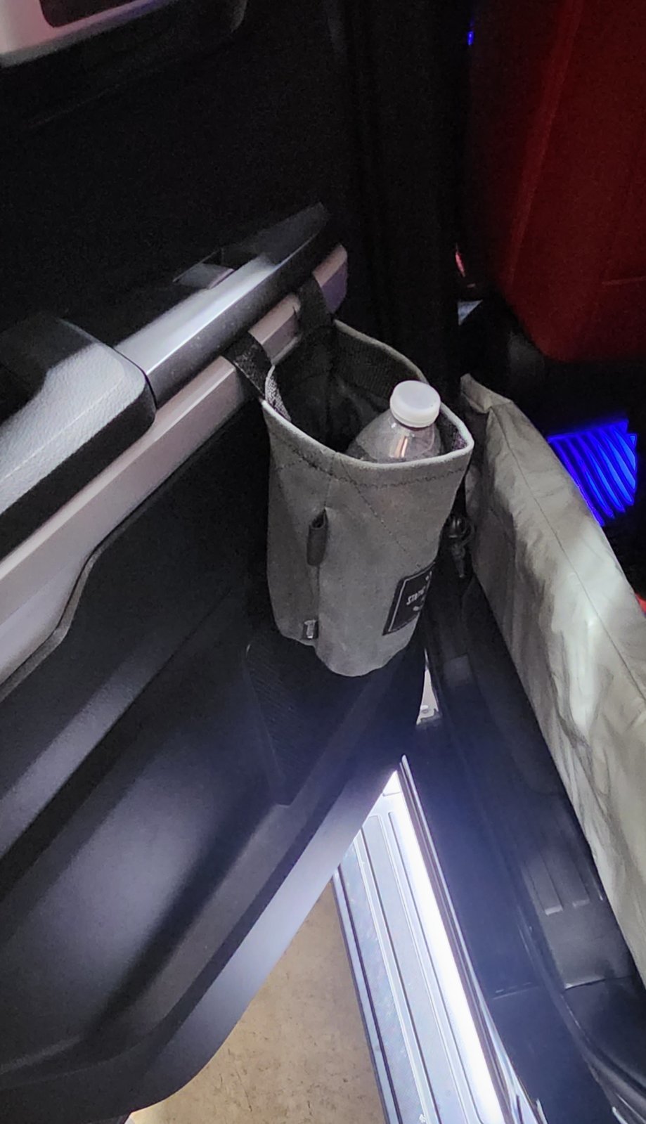

    @Jim LE 1301, how is it holding up on the door panel?
