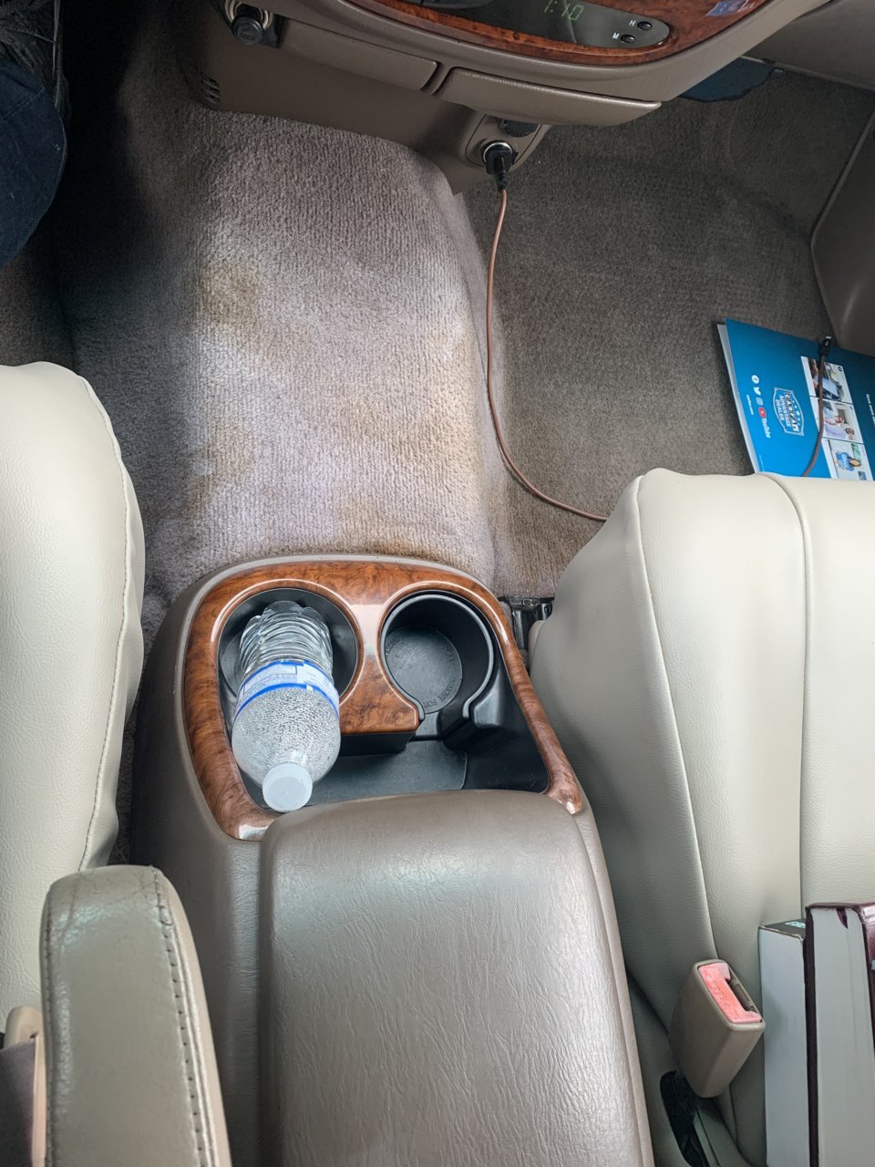

  15. Mar 21, 2024 at 12:14 PM
    Kimosabe
    Kimosabe Slacker
    Jul 28, 2020
    #50004
    1,261
    Sun Valley, Idaho
    06 Tundra DC TRD 4WD
    W.I.P - FOX 2.5 with DSC, SCS F5 wheels with MT Baja ATZ 285s
    It will work. Find the bracket is the hard part.
    Here are some pics of my 2003 AC with the double cab console. Sorry not the best, but what I had handy
