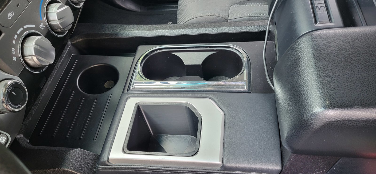

    Apologies for necroing this old thread but wanted to let anyone know who has done this conversion that I have designed and printed a drop in cup that fills the void left from the missing floor shifter. PM me if you want the file.

    That looks nice, but I'm curious, what's under the front by the single cup holder? I'd be interested in more room there.

    Absolutely nothing is under that portion, only issue is that it's all one molded piece, so to utilize it better you would have to cut the console. I could see about designing something for that area but would be up to you to cut, print and test it.

    That's more than I'm taking on right now. Thanks for the info.
