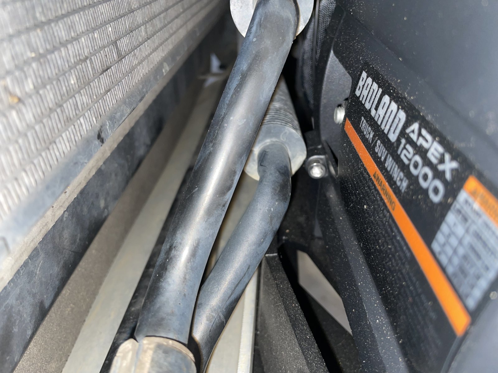

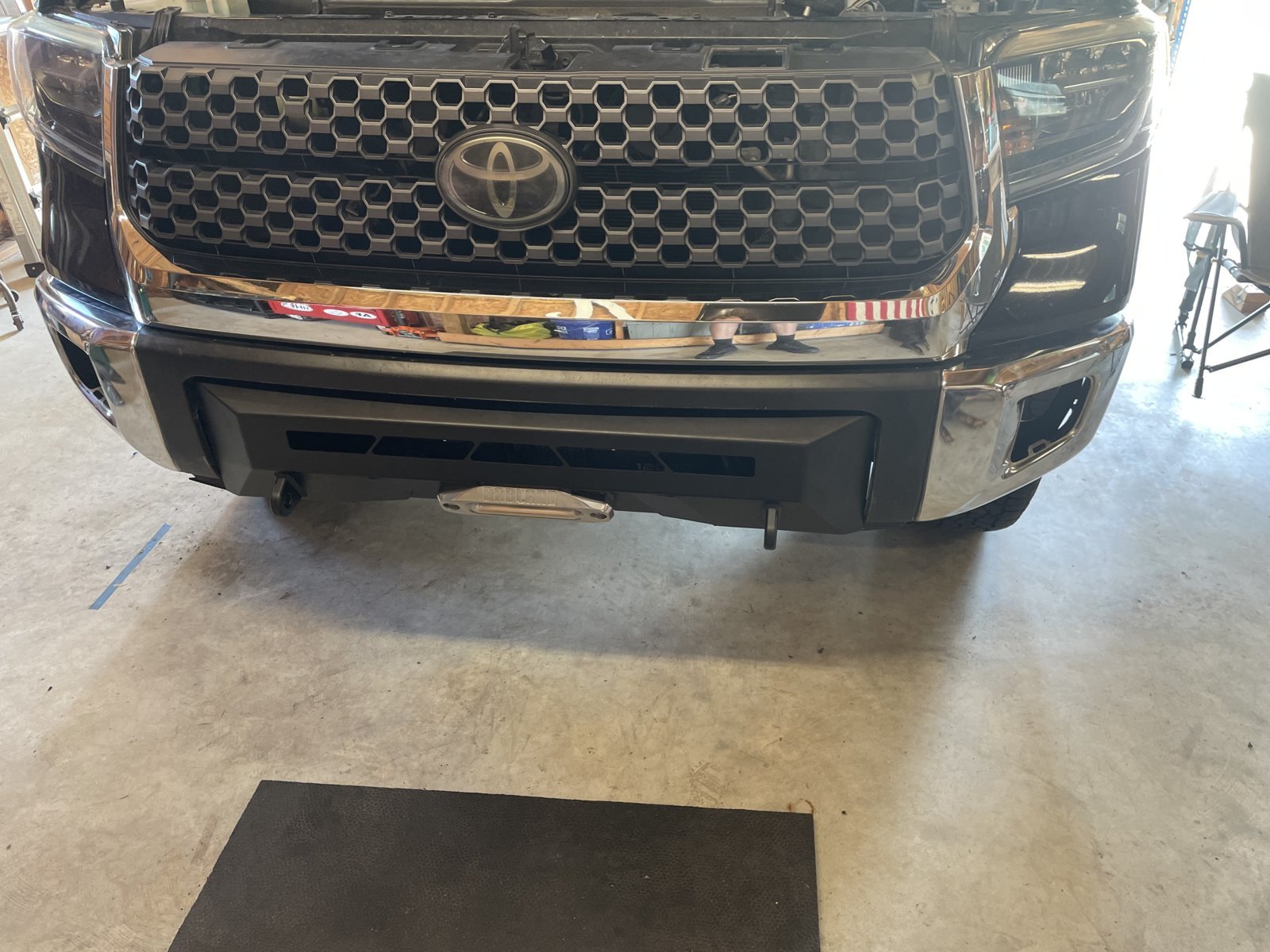

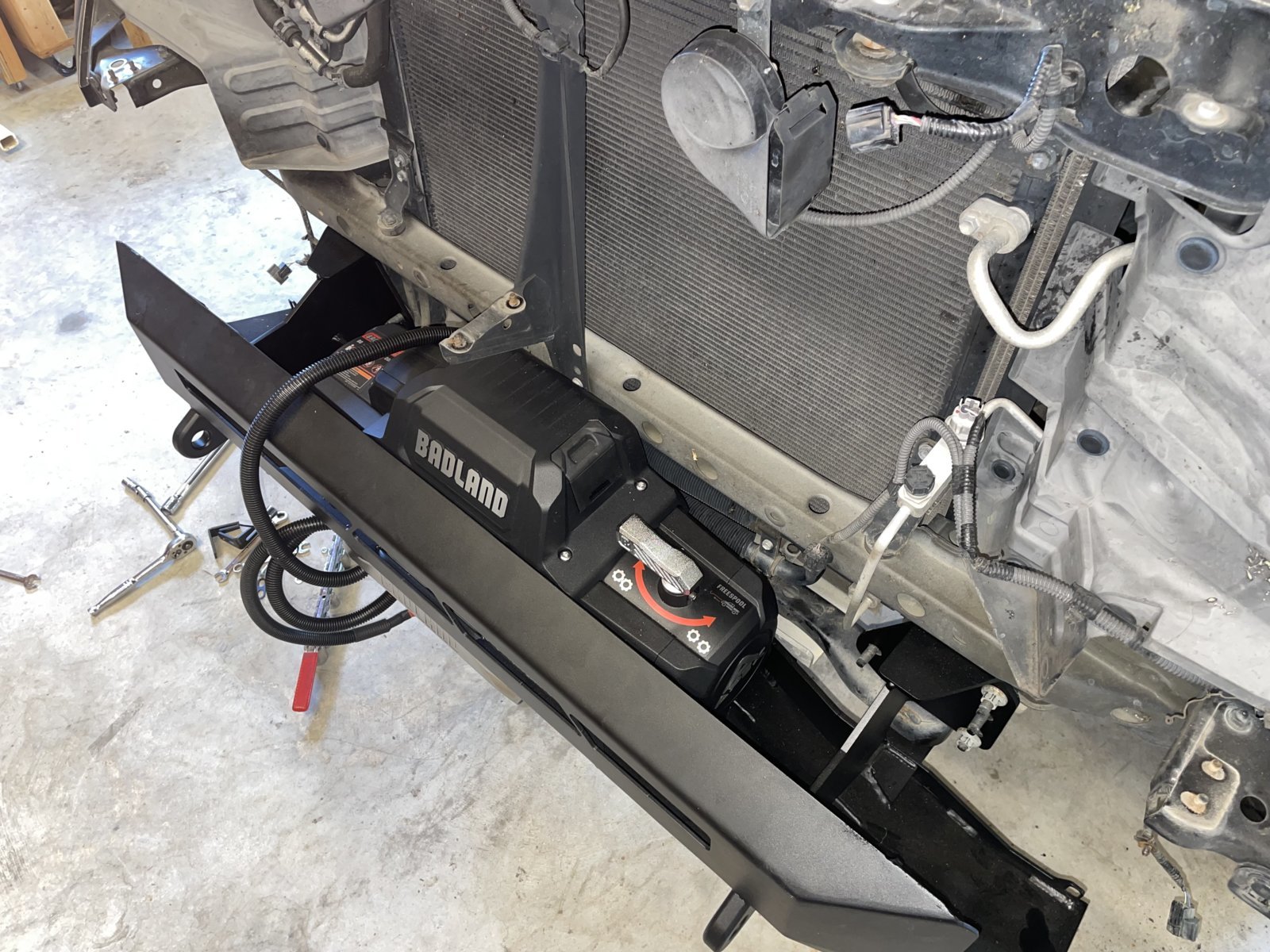

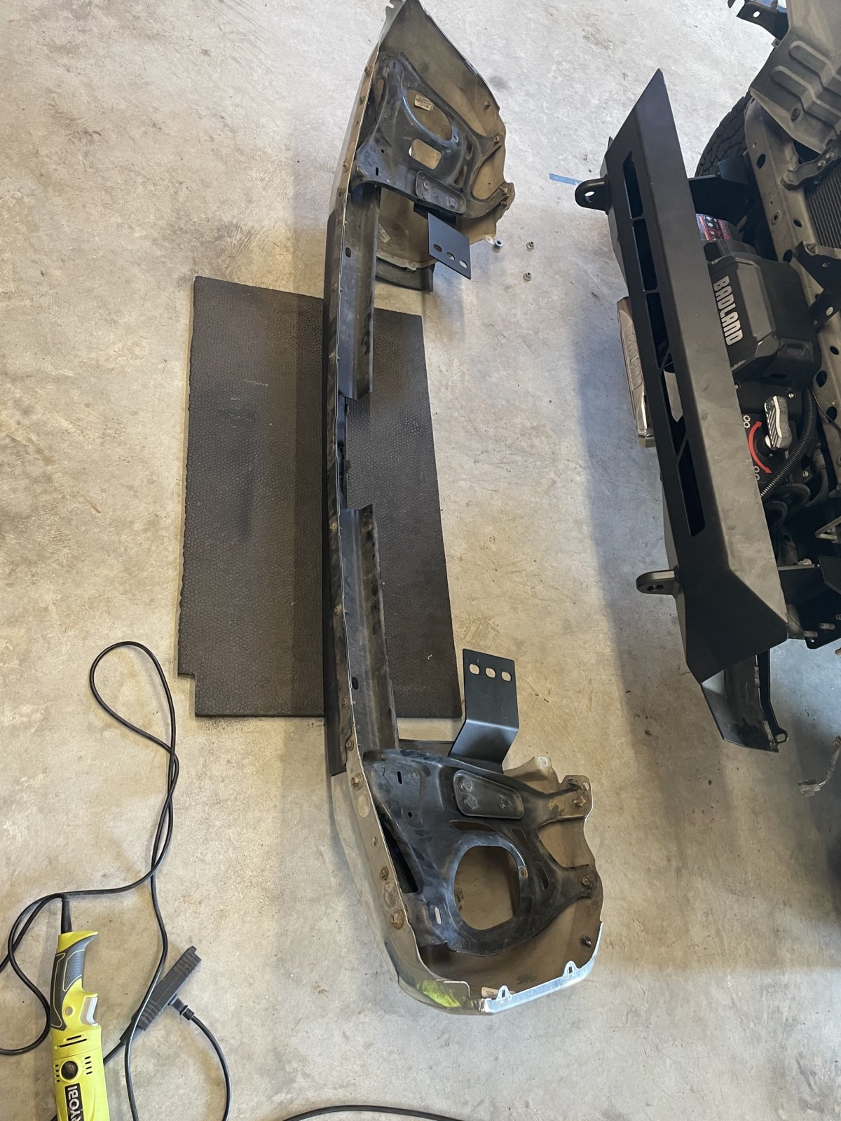

    Yeah for sure man. The only thing you have to cut to fit the winch is the a piece of C-Shaped channel that runs the width of the bumper. Just take about an inch off to fit around the control box like you see in the picture. I'll also include some other pictures to show how tight of a fit it is.
    Basically I did it in two sections. You have the covert bumper with the winch mounted and a light bar if you found one to fit, and the little bit of bumper left with the fog light buckets attached and put that on over the winch/bumper combo. This is the only real drawback to this set up. The brackets CBI uses to attach the fog light buckets leave a lot to be desired. They are a little flimsy but use what you have available to you to sturdy them up.
    It is tight working in there so definitely have a good combination of ratcheting wrenches and socket wrenches with U joints/extensions to choose from.
    You might think half way through you should have bought a full bumper, I know I did. But just know it'll be worth it if you bought this so you could be a little subdued without sacrificing recoverability. I don't wheel often or hard enough to justify a full bumper, and I like the look of the Tundra front end. Not to mention the weight savings by going with this unit.
    I hope the pictures help, they'll probably do better than me trying to explain things but feel free to reply here or message me.
