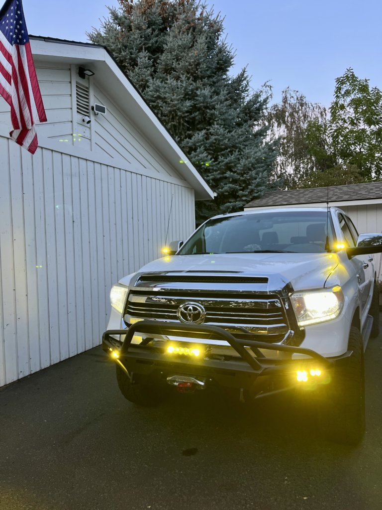

    I’m beat :rofl:

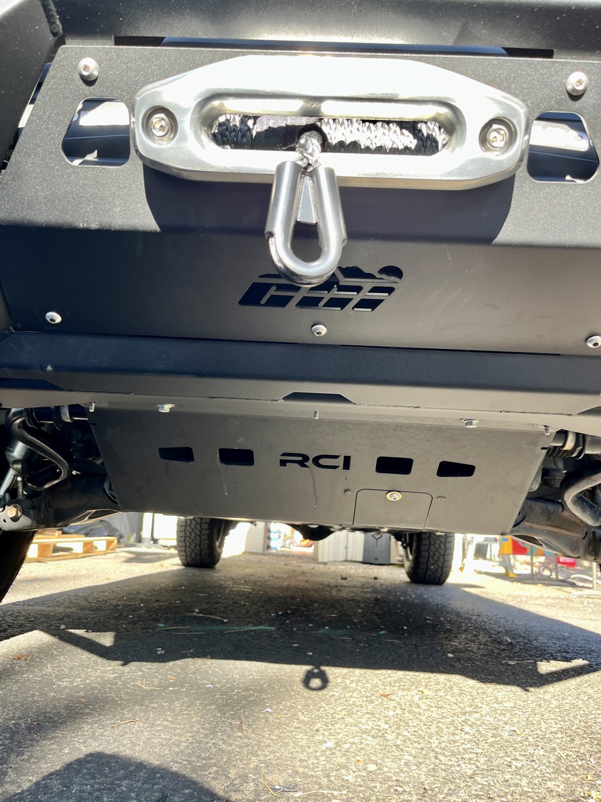

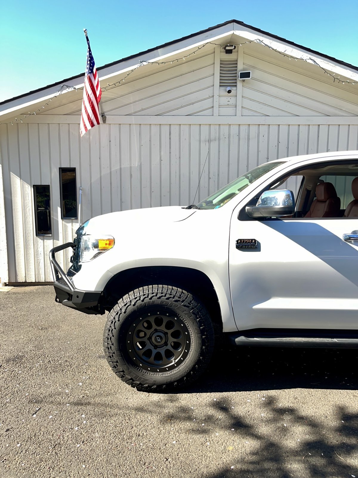

    Damn, looks great. Are those aluminum or steel skids?

    That’s the RCI front skid…aluminum..I was worried it wouldn’t work with this bumper, but it fits just under it…I’m hoping I can slide it out when service the front diff
    I’m rusty on this posting stuff, so my apologies if I’m doing it wrong

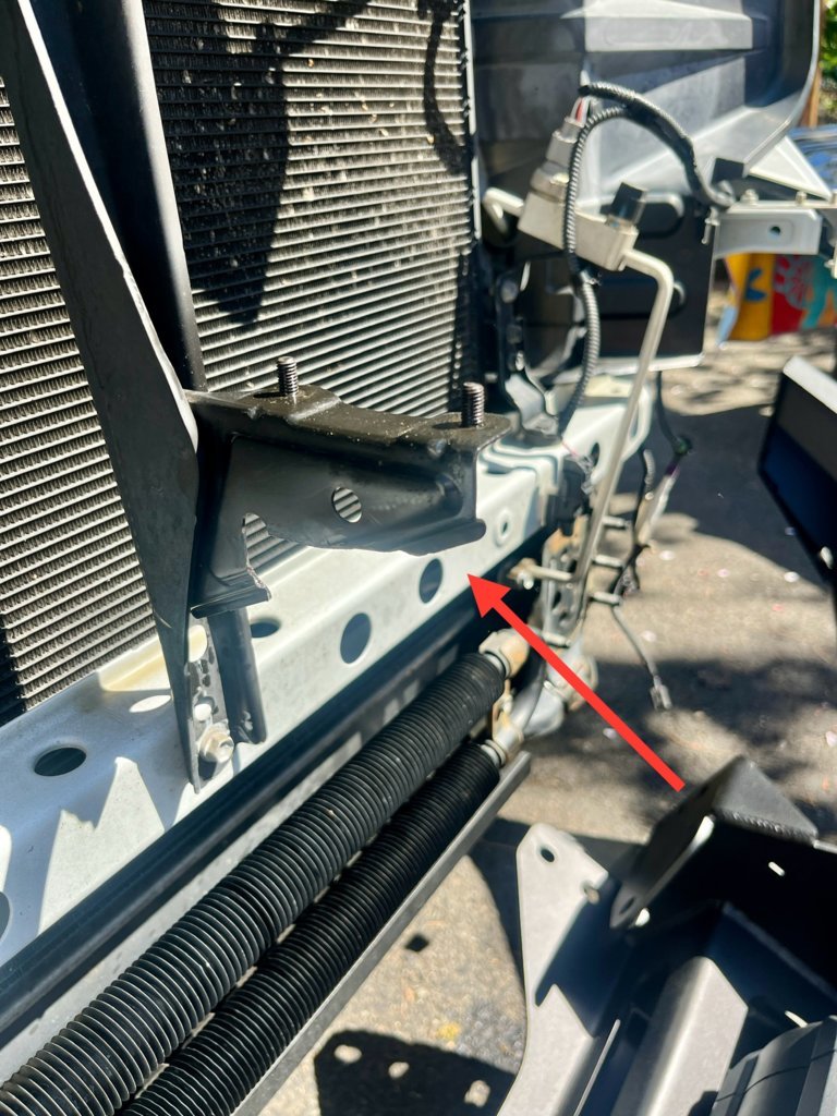

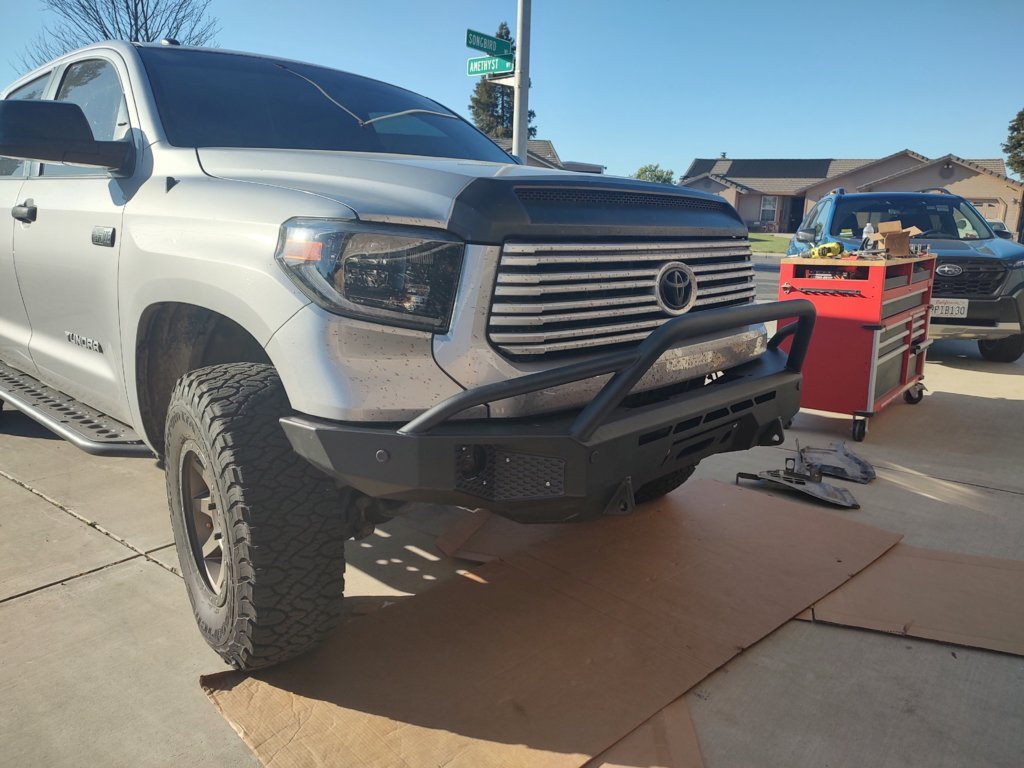

    Any issues with fitment? Did you have to trim or relocate anything?
    CBI Baja is the next item on my list

    Nope. Just take off the old one, new one bolts on. Gotta trim a little on one of the grill supports (think it’s #24 in this thread)
    It’s heavy with the winch on…definitely will need helper

    Lol of course #24 is one of the few posts that isnt displaying the picture, at least for me its not.
    Is it pretty obvious when you get the bumper mocked up? For what needs to be trimmed ?

    Awesome
    Thank you for the clarification
    I appreciate it

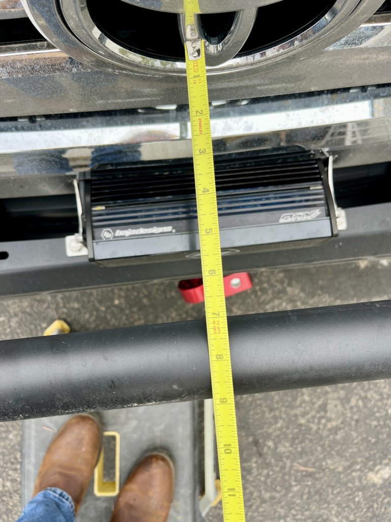

    Can one of you, either @Shawsmash or @smokint, do me a solid and measure the distance from the grill to the outside of the bull bar? My garage is pretty tight and I am trying to figure out if the truck is going to fit with the bumper.

    Yeah, lol, that may be a bit late.

    Thank you so much for doing this for me. Much appreciation!

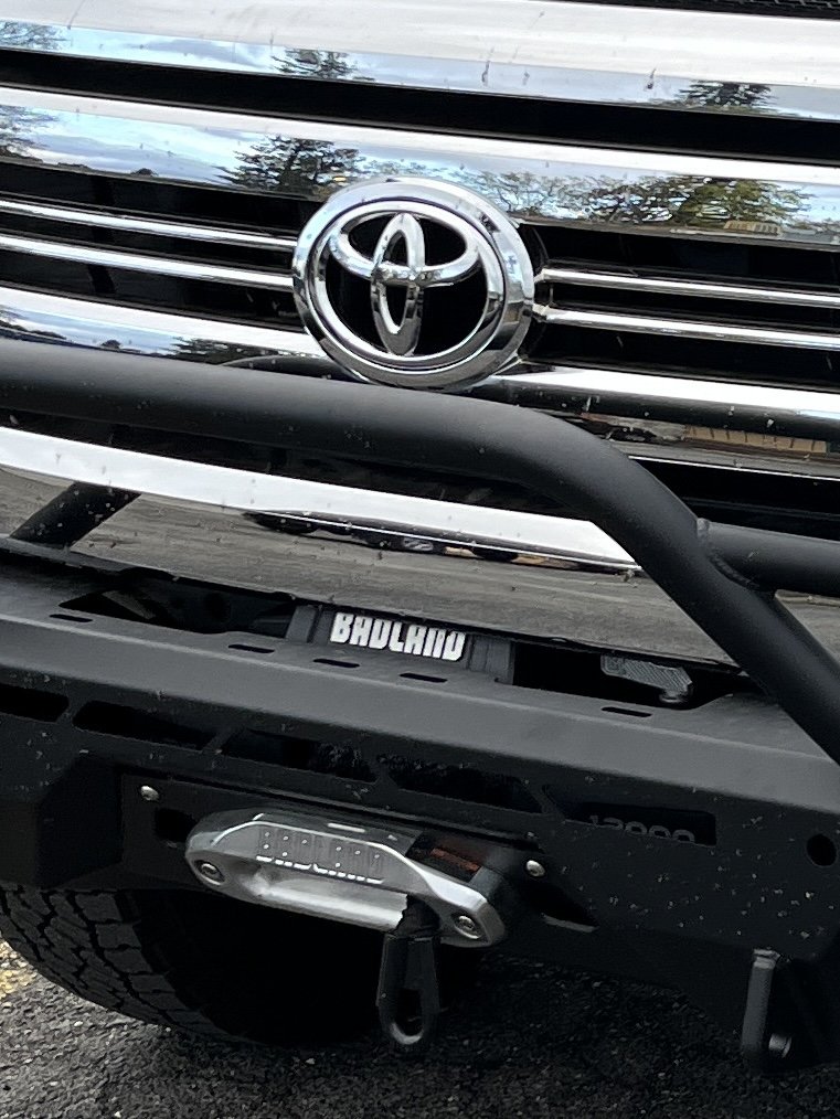

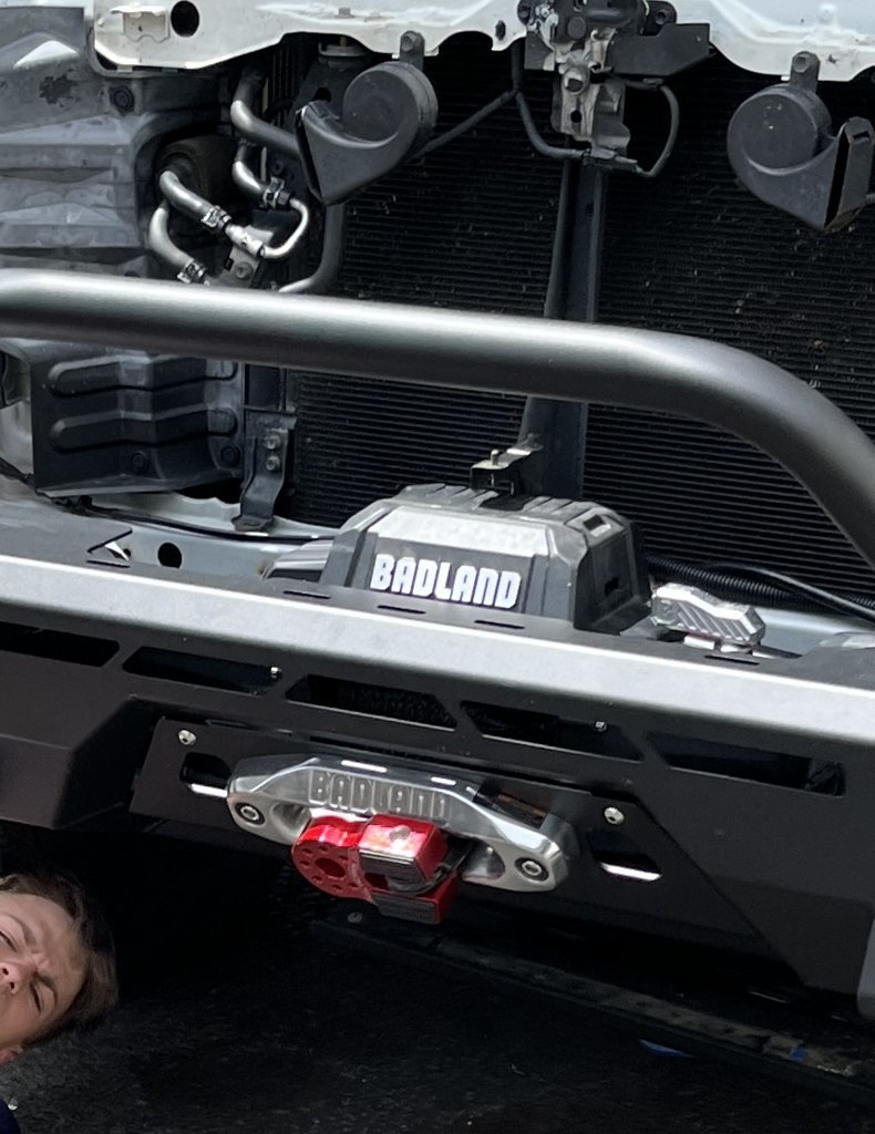

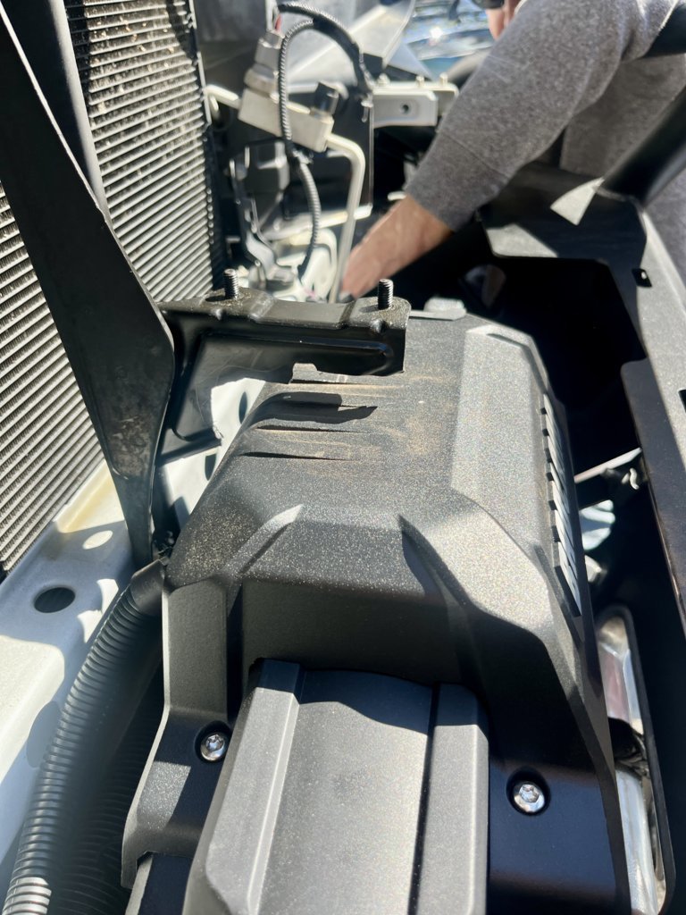

    IMG_20250225_161132123_HDR.jpgso I got my bumper installed now sans light or winch.
    Quick question I see the access hole in the top between the grill and the bumper.
    2 questions can you see the spool from the top or would you have to watch the line spool through the light bar cutouts?
    And can you access the clutch on your winch from here ?

    Yes and yes. Just gotta reach under grill to grab clutch , easy to do
