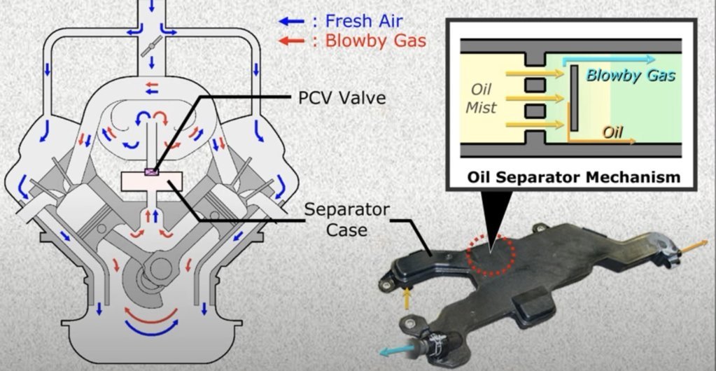

    No opinion on the matter, the 3ur-fe does have a built in oil separator fwiw.

    What happens to the blowby vapors? They are being separated but are they being caught, not that it matters on the 5.7?

    The blowby gas/fresh air mixture goes to the intake manifold.

    There are a few old post on the forums discussing catch cans on NA set ups and the CC side never catches anything from what I've seen regardless of NA of FI. One of the posts discussed the built in separator that returns the oil back to the pan which is probably why all the CC side cans I've seen posted here run dry.

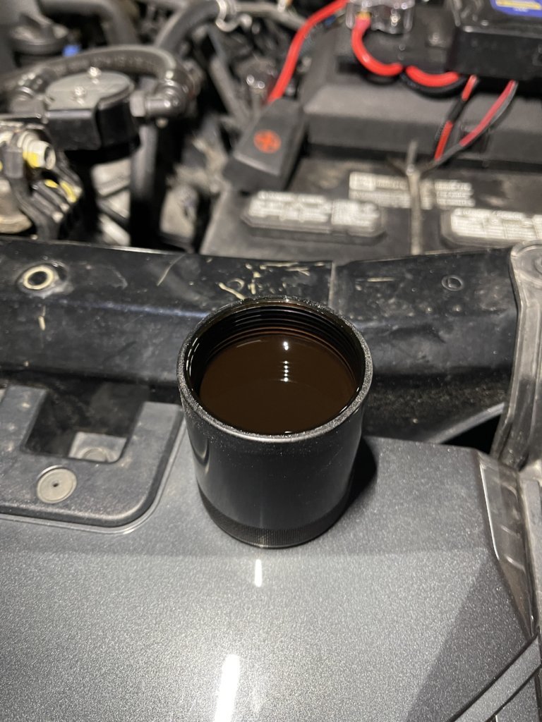

    I dont know about you guys and that it doesnt work. But this is what my JTL 3.0 catch can show when i decided to open it tonight.
    No FI here. Stock NA. Can’t really say how long ago last i checked, but glad i did because it is getting full.

    I remember now how long ago i last check. It was last October when i installed this catch can.. bout 6 months and 1 oil change since..bought the truck September 2024 and installed it October 2024… so in 6 months you can see how much blowby it caught. Worth it for me..

    That’s an alarming amount in 6 months. I change my Durango’s twice a year (every oil change) and it’s maybe 2 ounces worth. My previous LS was about the same.

    Kinda shocked myself. Now i need to keep an eye on it and check it more often..
