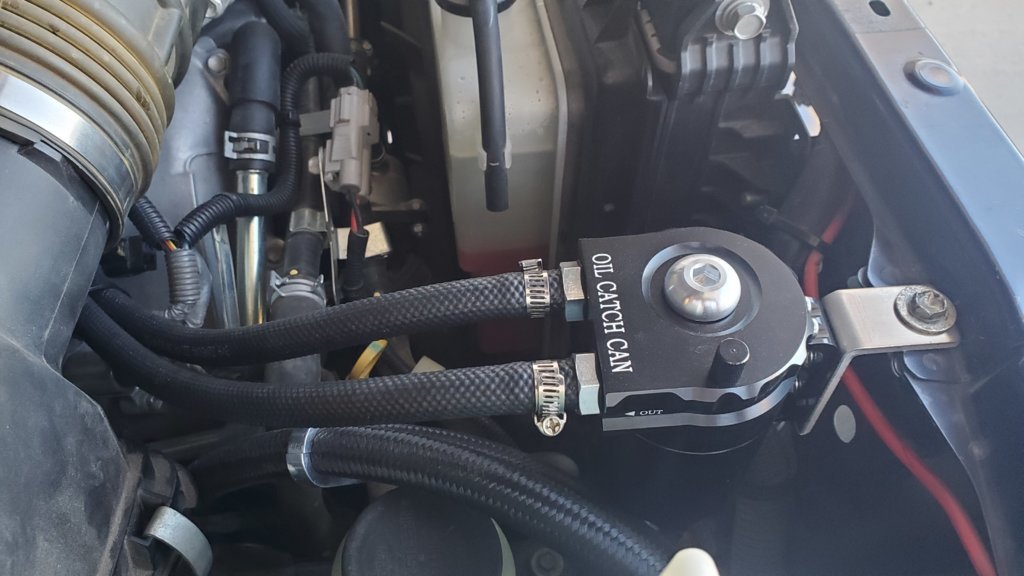

    Does anyone have an installed catch can that caught nothing within the span of, 11-ish months?
    I installed one of those on my truck and it is roughly 11 months, no a single drop, though does smell of strong petrol if I sniff the can.
    Normal, or weird?

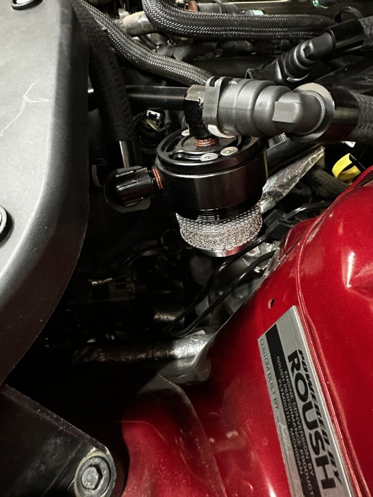

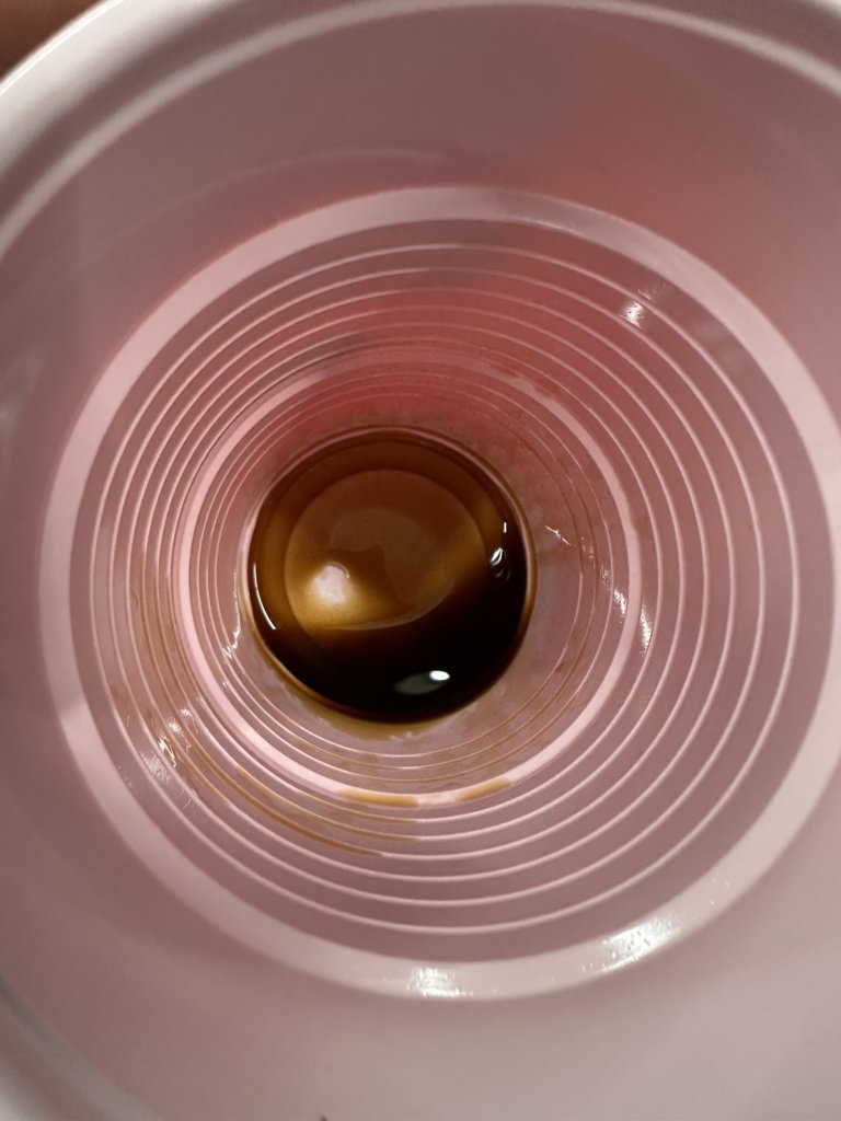

    My catch cans caught nothing until I altered them. Even then only the can attached to the PCV valve does anything - the can attached to the valve cover ports is pointless.
    Looking at that Radium link, it looks like the design has slightly changed from what I have. I ended up gutting my catch can lids and added stainless steel Scotch Brite pads inside the cans. The can connected to the PCV valve now actually catches.
    Here are my posts about it in the general supercharger thread. 1 2

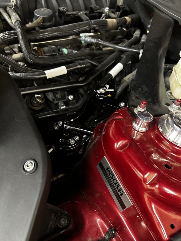

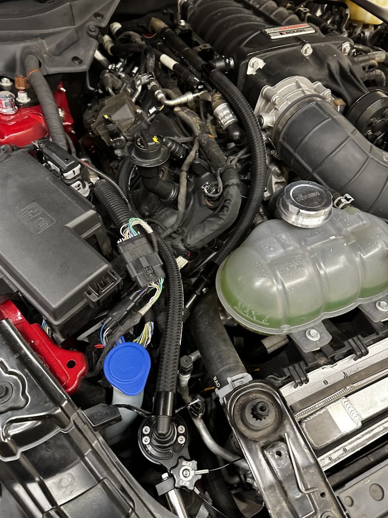

    Dirty side catch can:
    Clean side catch can:
    200 miles of pretty easy driving. I don't want this 5W-50 in my intake...or on top of my intake valves (DI).

    My "new" Radium wouldn't catch anything until I modified it. I went a bit further than just steel wool and added a bypass port cover sleeve AND more wool. I posted in the SC thread about it.
    Now it finally catches some goo.

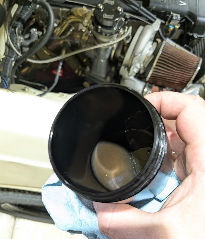

    This was how full my Amazon one was after a single drive the other day. Fat ring gaps, new engine still sealing, and seeing 20psi of boost every few minutes :D
