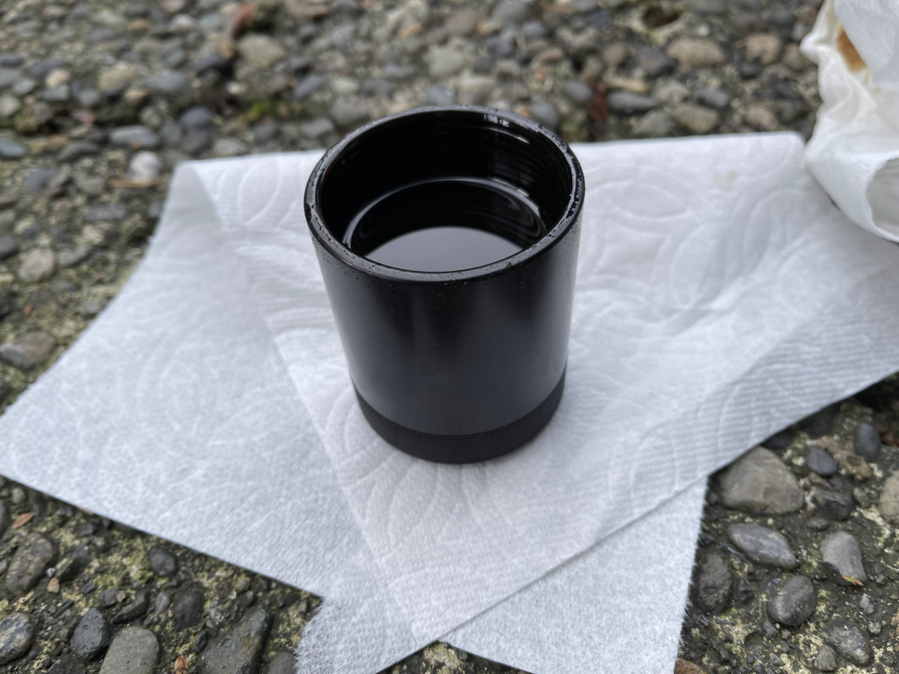

    I had about 1/4 of the cup full after 3k miles when I installed it on my truck (0W-20 oil, NA). So not a lot, but not "nothing" either. I was actually a bit surprised at the amount. I know @Green Thunder also gets enough on his truck between oil changes that it can't hurt to put on on the NA trucks.

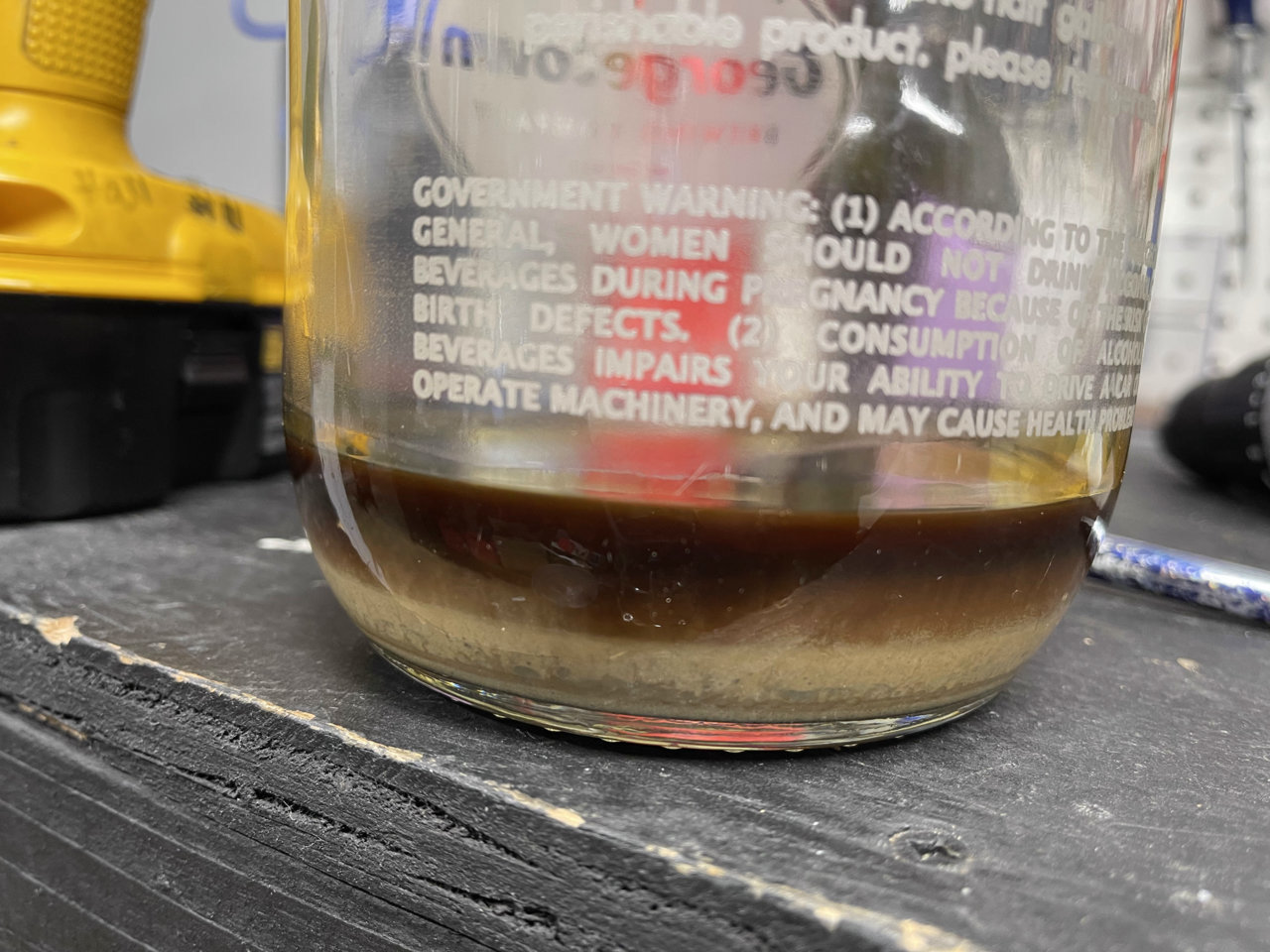

    This was my can after 4,000 miles. IMG_3649.jpg Basically full; so I’ve dropped my cycle to 3,500 miles. I just emptied it a few weeks ago at about 3,300 miles and it was getting full but still had a gap to where the threads start.
    I’ve saved every “harvest” so far in an old half-gallon beer growler. This is after 14,xxx miles IMG_3650.jpg

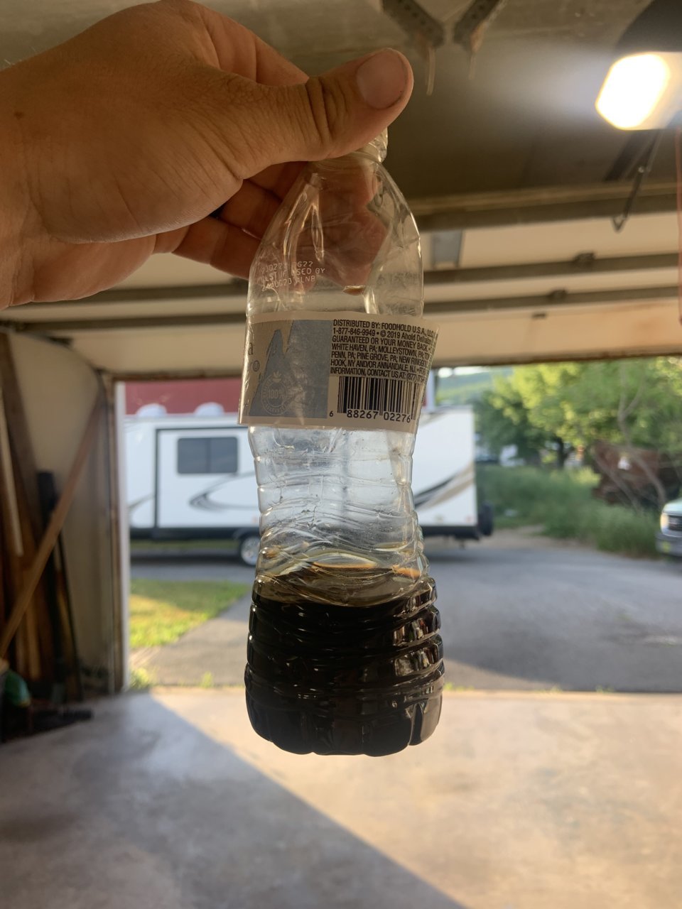

    I collect mine too and @snivilous harassed me for it. Then the term “ass fluid” was coined and it is now my prefer nomenclature. Here’s my current collection of said “ass fluid.” I get far less than a lot of you guys though it seems.
