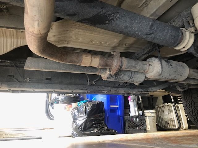

    It looks like they only got one of your secondary cats, right? You could easily throw a basic resonator in place of that to help with the sound, then also have the secondary cat on the other side cut off too and replaced with the same resonator. If I'm correct, I can see the downstream O2 sensor in your picture, which means that your truck shouldn't be throwing any codes since you still have the primary cats, and you should still pass emissions (if you have them in your state).
    Buy two of these, https://www.summitracing.com/parts/vpe-1792 , take them to an exhaust shop you trust, have them installed where the secondary cats go, and you should be right as rain. THEN buy a Valhalla shield which will protect your primary cats. I had my secondary cats removed completely and it is a bit louder (I already have a Carven TR muffler), but really isn't too bad. If you don't want your truck any louder, throw the resonators on there.
    Can you take a few more pictures showing more of the exhaust? I think you'll be just fine, but seeing more will help make more sense of how you can proceed.

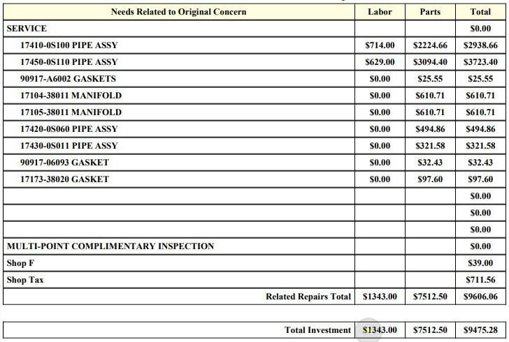

    this was my bill from toyota in february 2021. geico covered all but my deductible.

    Thank you! That is crazy expensive! All so some ass hat can make a couple hundred bucks.

    Holy crap, that's more thievery than cutting the cats in the first place! New ones must be made entirely of rhodium
