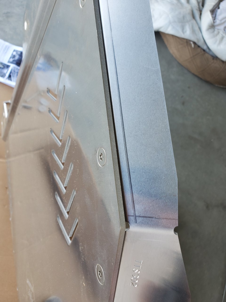

    For those of you who put a Talons Garage plate on with the TRD skid, what did you do where they meet at the front?

    Talons plate is sandwiched between TRD skid and frame. You need to bend the tab on the TRD skid to make clearance for the Talons to fit flush. Make sure to install the third Talons hanger bolt on the front before you reinstall the TRD skid. That bolt holds the Talons plate up on the front so that the 2 smaller bolts... best to use the security bolts... only support the rear of the TRD skid. Some of the other cat protector brands seem to not have that front hanger bolt which seems a little sketchy to me. Plus, with a setup like the Talons, when you pull the TRD skid for an oil change you do not loosen or disturb the cat shield at all.

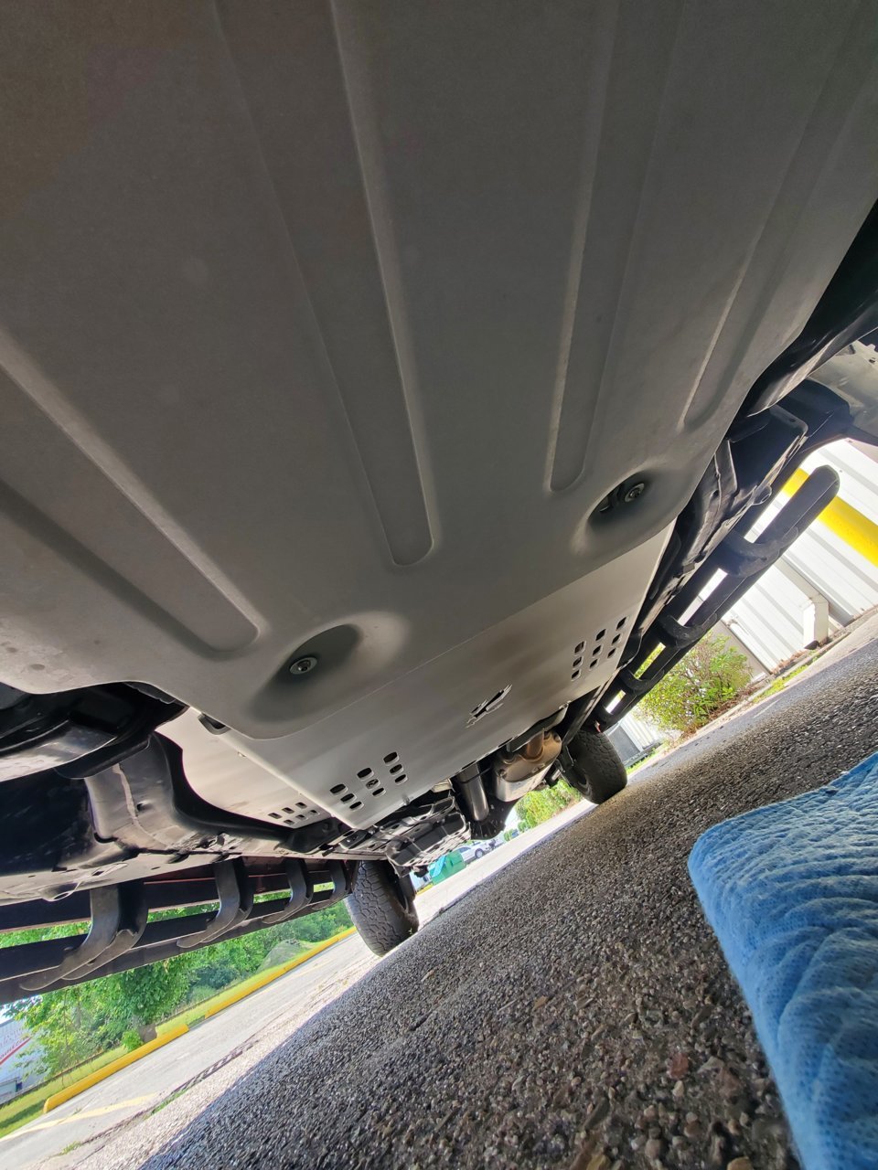

    Here is a photo of how they interact. Very easy install. Took half an hour. You do have to hammer down the little tab/hanger on the rear of the TRD Pro skid plate to make room for the shield to slide over. I didn't use the hanger bolt since it seemed like it would not allow the skid plate to sit flush to the shield. I will re-examine this though.
    My workflow was:
    Remove TRD Pro skid plate by loosening front 2 bolts and removing back 4.
    Slide it off and then hammer down the little tab.
    Re-install skid plate with bolts just engaged a few threads.
    Place the Talons shield between the skid plate and crossmember to hold the front up and support the back of it with your chest, leg, whatever.
    Remove one of the skid plate rear bolts and pivot the Talons into position, so the hole lines up (you use the hole and not the slot) and reinstall screw.
    Do the same on the other side.
    Now scoot to the rear of the shield and install the 2 bolts. It will be supported in the front and require minimum support in the rear.
    Then go around and tighten everything up.
    The Talons shield is very nice and fits great. Fast shipping too. I highly recommend it.
