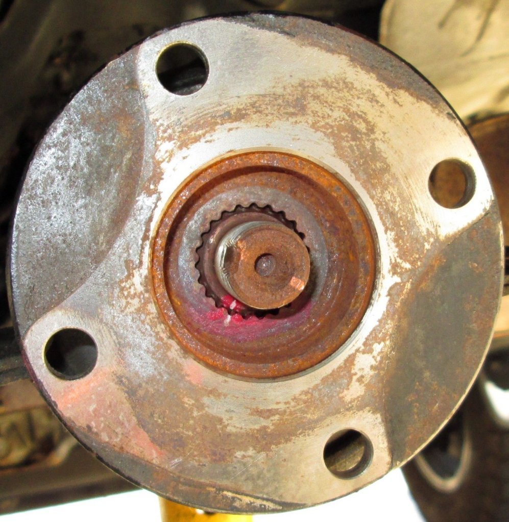

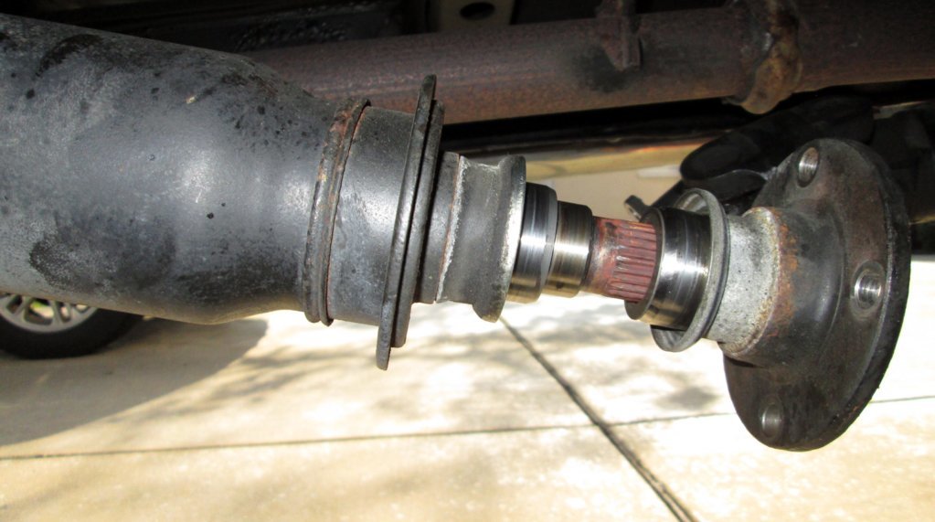

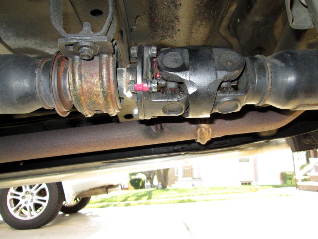

    This is a picture from when I did mine. The smaller diameter goes inside of the bearing and the two larger ones go into the seals on the correct bearing. On the one you bought there will not seals but it will work.
    You don't need to pull the driveshaft to replace it. Just remove the 4 bolts and put each half of the driveshaft on jack stands. Mark everything first. Very easy.
    I would check the u-joints before worrying about replacing them. If they are lubricated and don't have any play I would not fool with them.
    People get vibrations in these trucks and do all kinds of things and never get them resolved.
