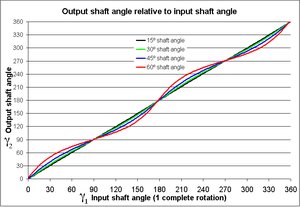

    Here's some takeaway from that video:
    You want the angles of the shaft coming out of the diff and the trans/transfer case to be the same. The diff and trns/transfer case should would be at the same angle to accomplish that. And you want the angle under 10 degrees.
    It easier with one piece drive shaft, with a 2 piece, its still ideal to have the angles the same at each end, but to do this the diff and trans/t case could be on different planes.
    Per my driveline guy, you don't want a 2 piece driveshaft perfectly lined up straight. U- joints work better with some angle in there. Thats what he said, but it makes sense if you have a straight spinning shaft with a break. It's constantly looking for a place to not be straight at the joint as it spins. Keep some angle at the center and you give it that place, potentially reducing vibration.
    If straight was the ideal, it would be a one piece shaft, with a longer single section of spin. And easier to whack out of balance. Driveline distance and ground clearance and reducing the length of any one shaft seem to be the driving forces for the designs.
