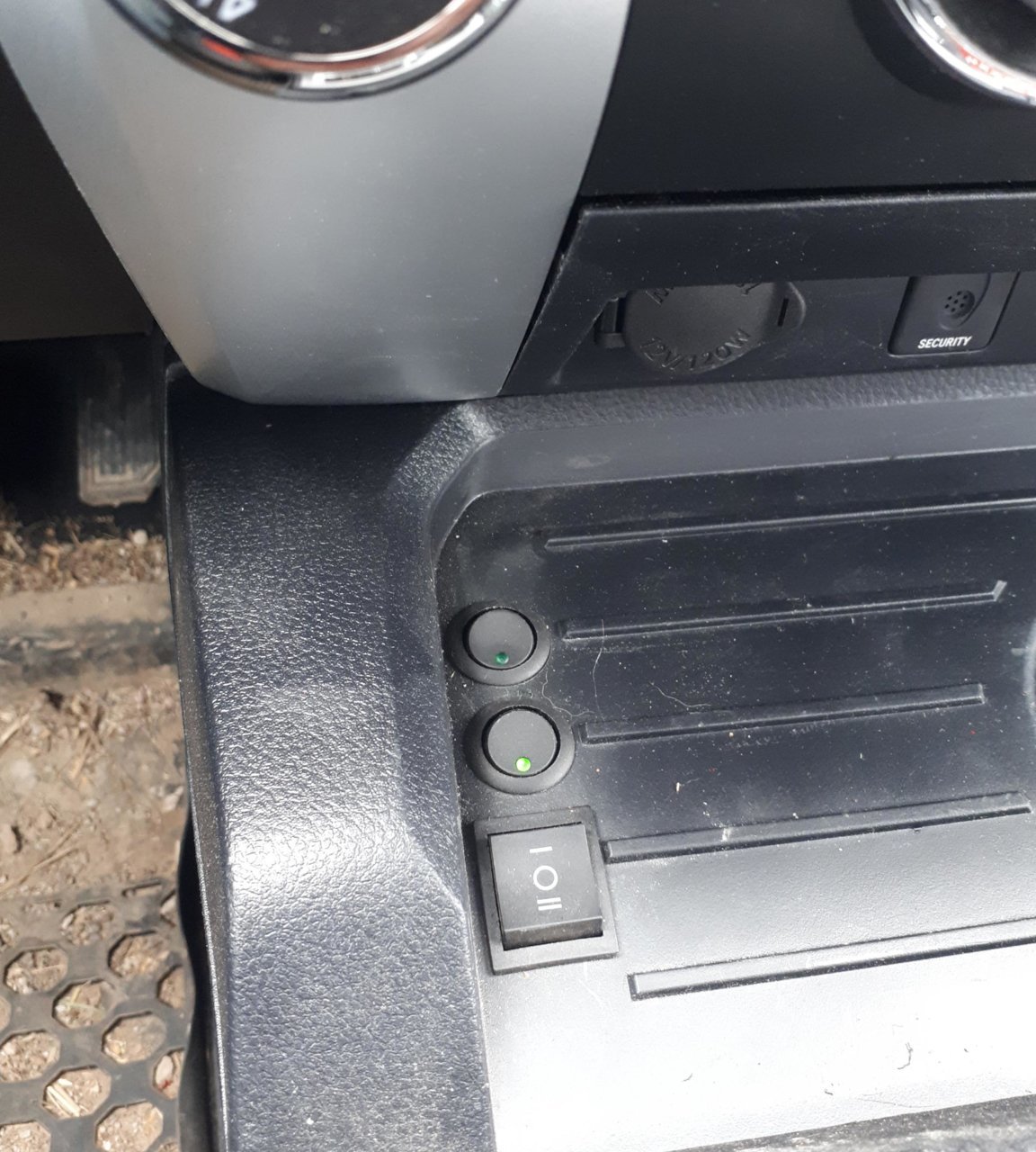

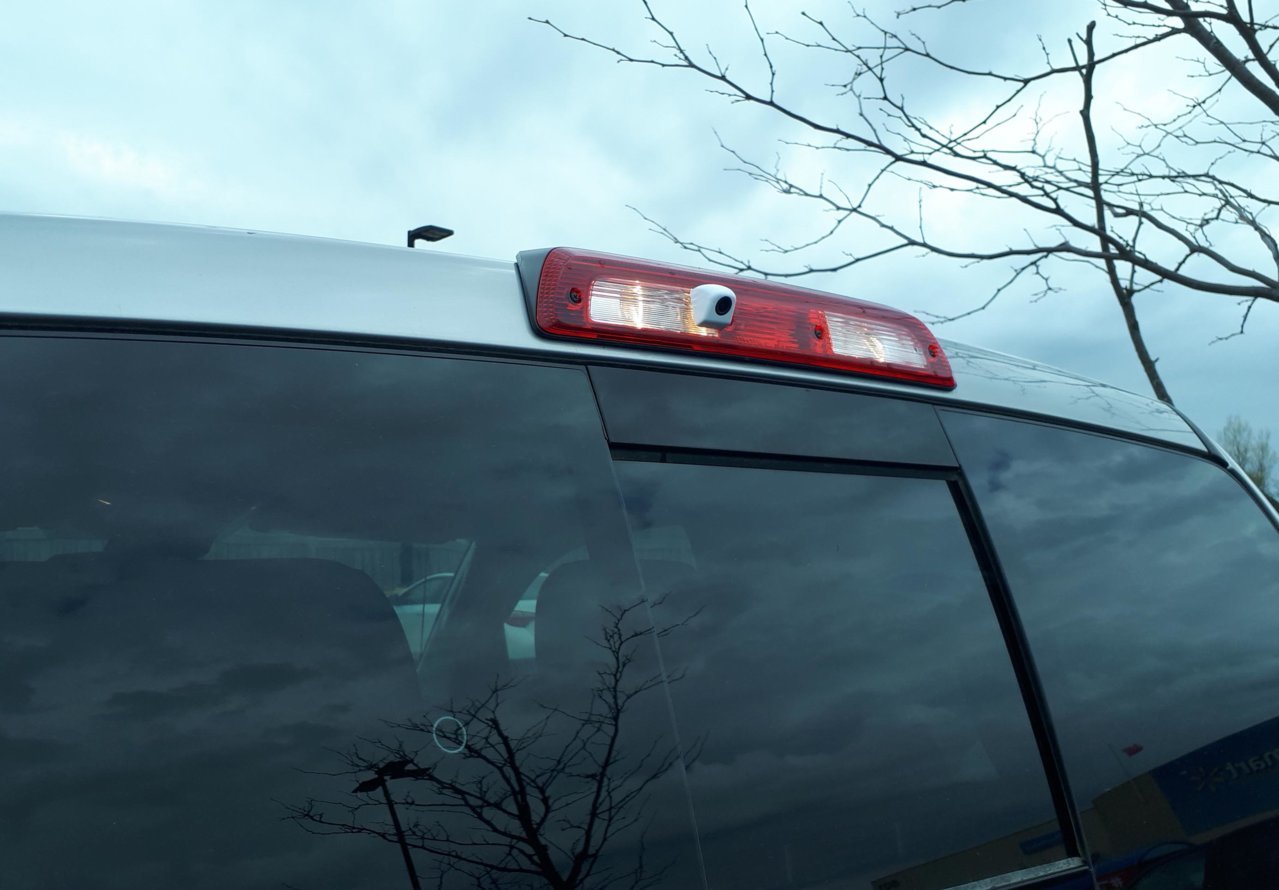

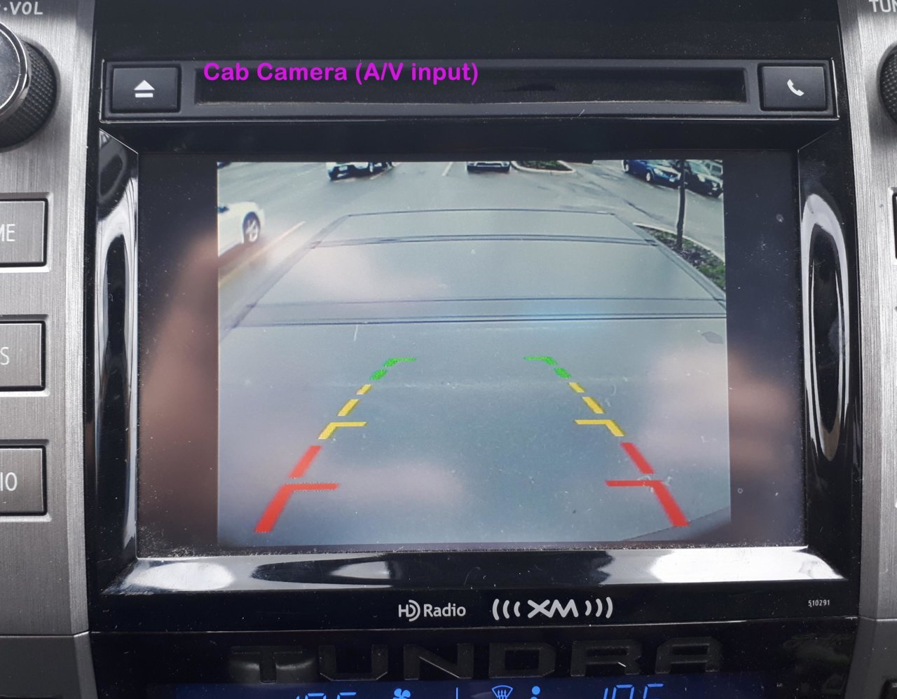

    I just finished hooking up a cab mounted camera on my 2018 Tundra Ltd. Camera is mounted on the 3rd Brake light lens with wiring running across to left hand cab corner, down and forward to above brake pedals. Used the 3rd party AV plug and play harness into the entune unit, added a switch to control power to the camera (so won't be powered unless i want it), added another switch to disable the reverse gear wire so I can use the new camera (otherwise the factory camera overrides the display). Added a switch for the speed sensor at the same time (so my passenger can program the GPS etc). As usual the second time I need to do this it'll be a snap (I plan on adding a front camera).

    Those two together give me a picture (it activated the A/V input option on the entune unit which is one of the 'audio sources' (like AM FM USB Sirrius). However if I switched into reverse the factory camera overrode the screen display. The Entune switches to the factory camera based on a 12v 'signal' into the unit (on the same 28 pin cable). So today i cut that input cable and installed a switch so I could, in effect, turn off the 12v feed when I want to see the box. In my case I want it to help hook up my gooseneck trailer. I have used a dpdt on-off-on switch so I can add a second camera (either on the front or more likely in the horse trailer) and switch between the inputs.

    It certainly does what I am looking for and looks like a clean installation. Good job. How bad was the job of wire routing inside the cab? I assume you pulled lots of interior trim. Any challenges to get it back together?

    Hardest thing is dealing with the head liner...try not to pull it down.
    I used a long zip tie (like 30 inches) to push from the 3rd back hole (after it was removed) to the side of the cab. Taped a string then pulled the wire.
    I have a double cab. There are a couple of bolts to remove on the 'vertical trim (2 pieces)'. the 'push in clips' popped out. some fell....probably should buy a couple to replace them but the trim is fine without all of them :).
    The sill pieces pop easily. The side panel by the emergency brake has 'nut' to remove.
    One thing is make sure the seat belt is free behind the trim. I didn't and then later found it was pinched and wouldn't retract or extent. Had to pull the trim off again.
