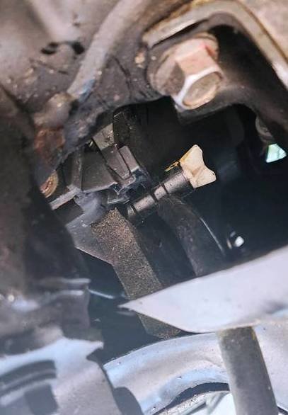

    I just had a look at my Tundra.
    Is there a method to open the rad drain without removing the skid plate?
    The handles on the drain are at a bad angle.
    Easy to connect a hose to it but can't get my hand up there to open it.
    The engine drain is a breeze with the wheel turned right.
    thx .

    I use a mechanics glove. The initial start is tight, but as soon as it moves a little (often with a crack noise that's worrisome with plastic) it turns easily. I've done this many times and never broken one on a toyota (knock on wood). Dodge's arrangement breaks on me every time.

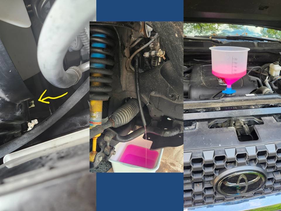

    I can't get my hand in there to get a decent grab on the small wing nut. I didn't want to remove the skid plate till the next oil change. So I went from the top - first pic. Long pliers let me get a good grip to just pop the seal on the nut, then I went underneath and used one finger to loosen.
    I have testing strips coming. I think it will be a good Acidic test of time (6 years) and low mileage. I bought my 18 Tundra new.
    I should mention that I took out 10 Liters over 2.5 gallons. The Toyota containers are 3.78 Liters - 1 gallon. Good thing I had an extra jug.

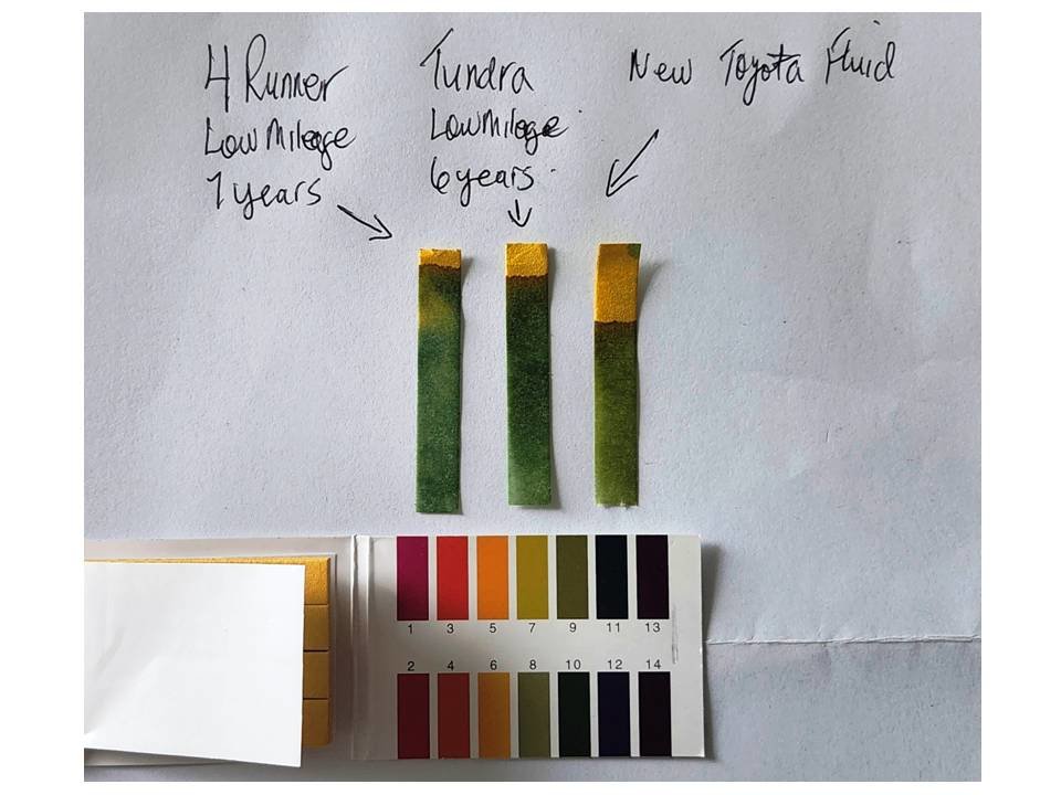

    Driver Grip Handle Borla Dual, Line X, ESP Underseat
    I was expecting different results.
    This simple test shows that 6 and 7 year old low mileage coolant is not acidic.
    These results seem to support what the dealers told me that coolant is affected by hot/cold cycles and not "time"
    How accurate it is I don't know.

    I would think an acidic solution contributing to wearing out the gasket, should show more visually widespread wear, instead of just that one area (spot) in the video, that created a path for the coolant to go into the cylinder?
