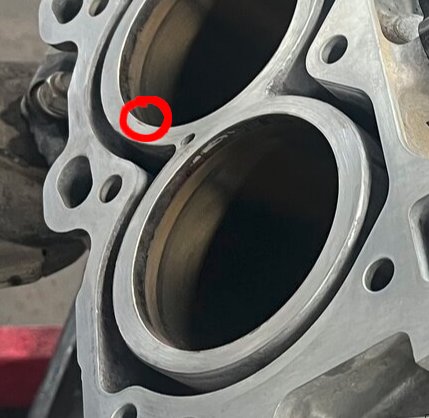

    Looking at pictures in this ih8mud thread: https://forum.ih8mud.com/threads/3ur-fe-rebuild-head-gasket-failure.1322078/ I think what I see is a cast iron sleeve separating from the aluminum. This happens because cast iron and aluminum have different thermal expansion rates. When locally overheating, the sleeve has no place to go but push up. Unfortunately the pics a not good enough to see if there are corresponding marks on the head.

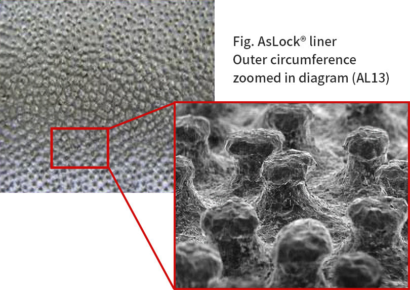

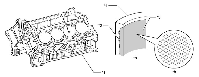

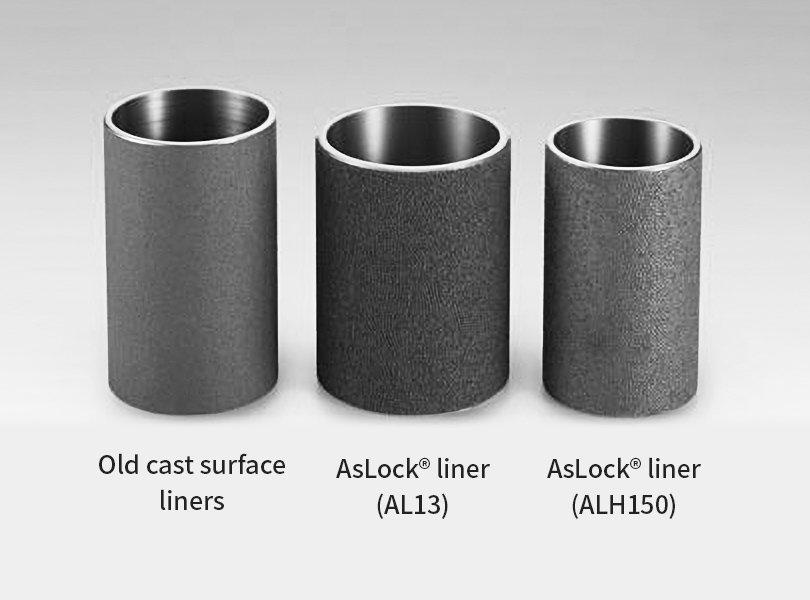

    A good observation here. However, the iron sleeve stops about 4 - 5 mm below the top of the deck, so it may be difficult to say exactly what that mark is. The sleeve is very well integrated into the aluminum casting, but that doesn’t mean an overheat/hot spot won’t damage things. If the liner were to tear away, which should be very difficult, the problem will reoccur, as no gasket will fix such an issue. The mark is certainly in the proper spot on the hot side of the cylinder.

    This is a smart design by Toyota.
    Yeah, the problem reoccurs in Volvo engines, and selected Ford ones, who inferred that design choice from Volvo. They cut a slot between cylinders for thermal expansion, that adds a weak point, which eventually fail. Engine tuners often put a shim into that slot to mitigate the issue, but then the head gets lifted in high power applications. I certainly found imprints on my cylinder head where cast iron sleeve was pushing the gasket's fire ring up.

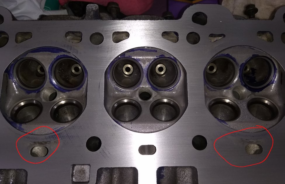

    I misposted another observation into another head gasket thread. Duplicating here.
    Another good illustration. This is my engine head partially skimmed. See dark depressions between water channels and fire ring?
    Same must be happening with 3UR. Also see cylinder sleeve imprint into the head. It was lifting it up and would eventually cause a head gasket failure.
    I vaguely remember that Tom Gilles wrote in his book about aluminum crushing inside itself in cylinder head in these spots, but I forgot what was the explanation, and someone took my book and never returned. Spot between water channel and fire ring is certainly a weak point in any engine.
