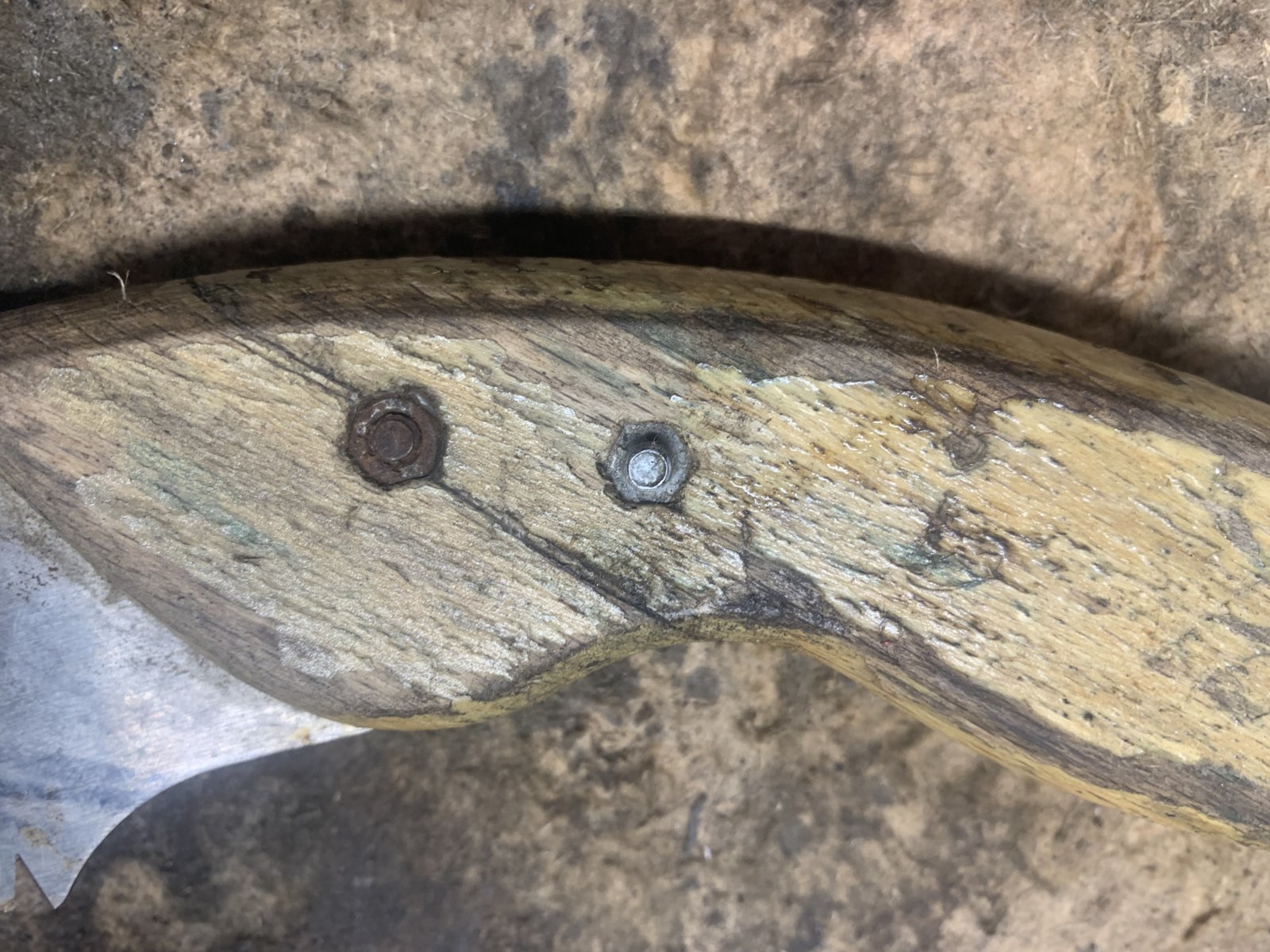

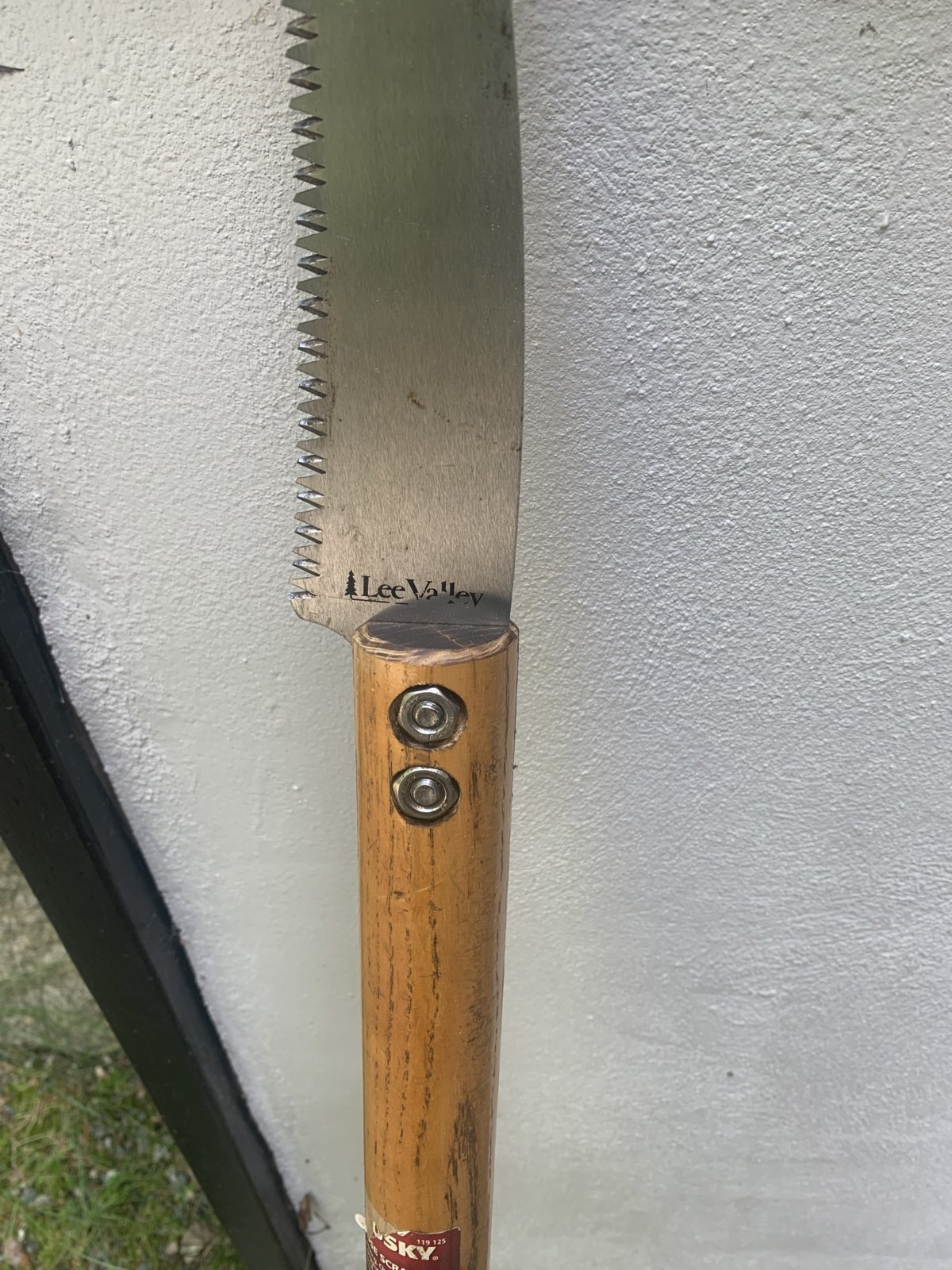

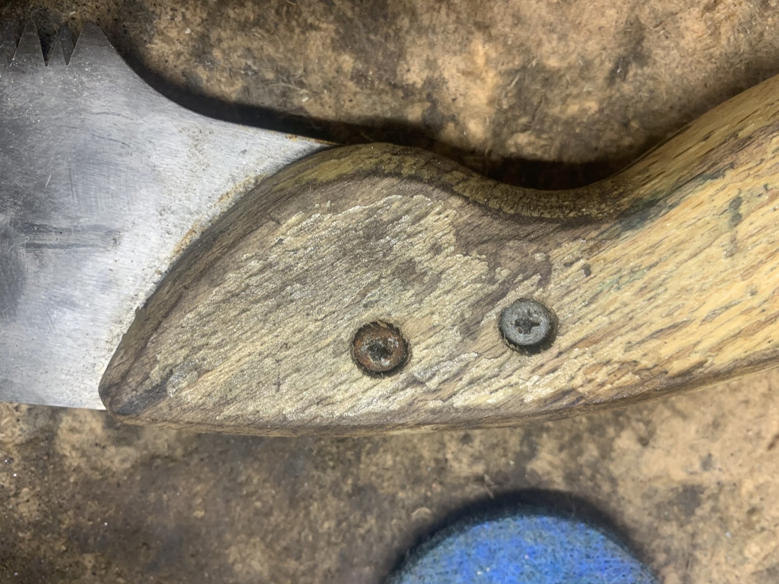

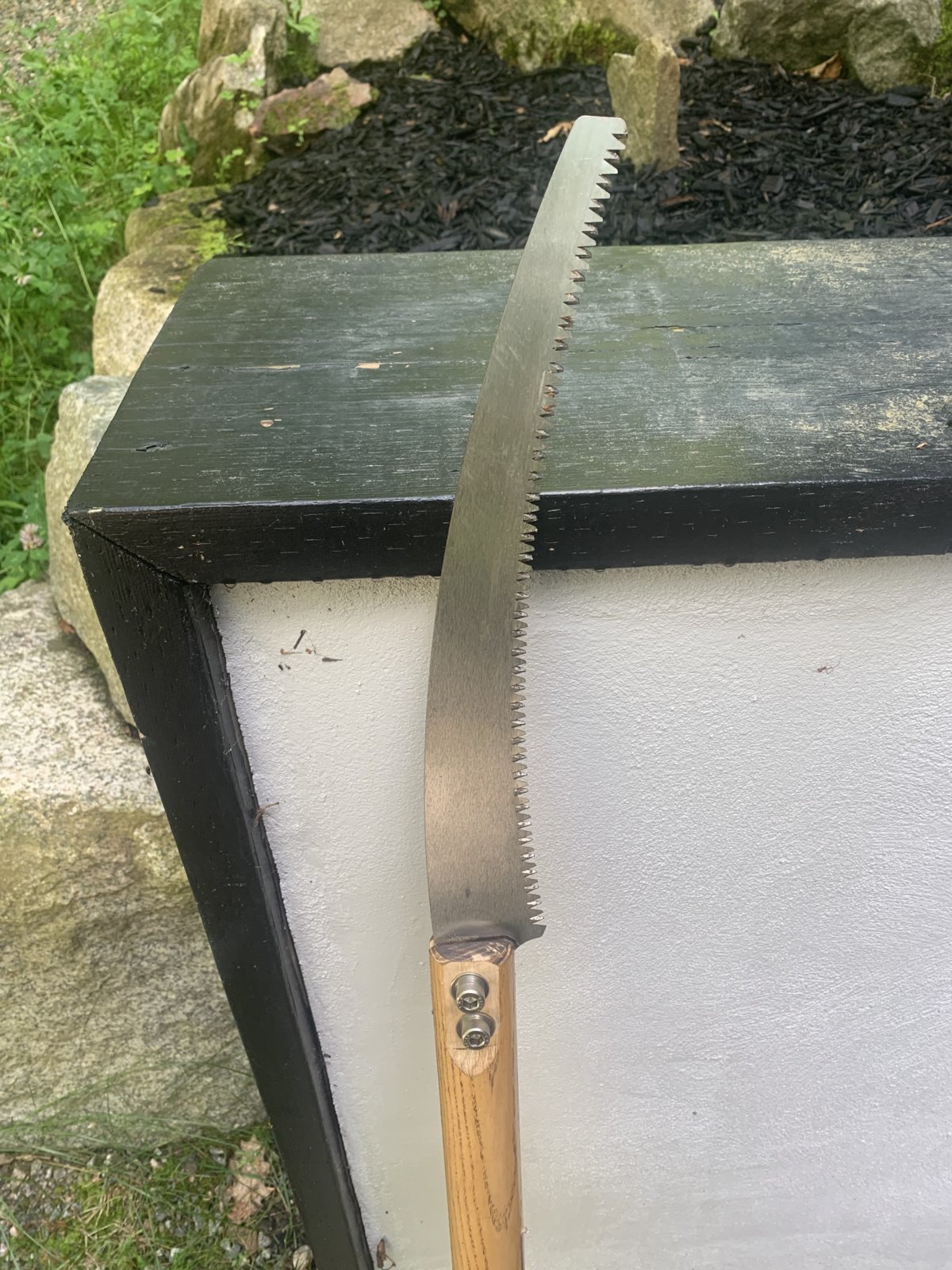

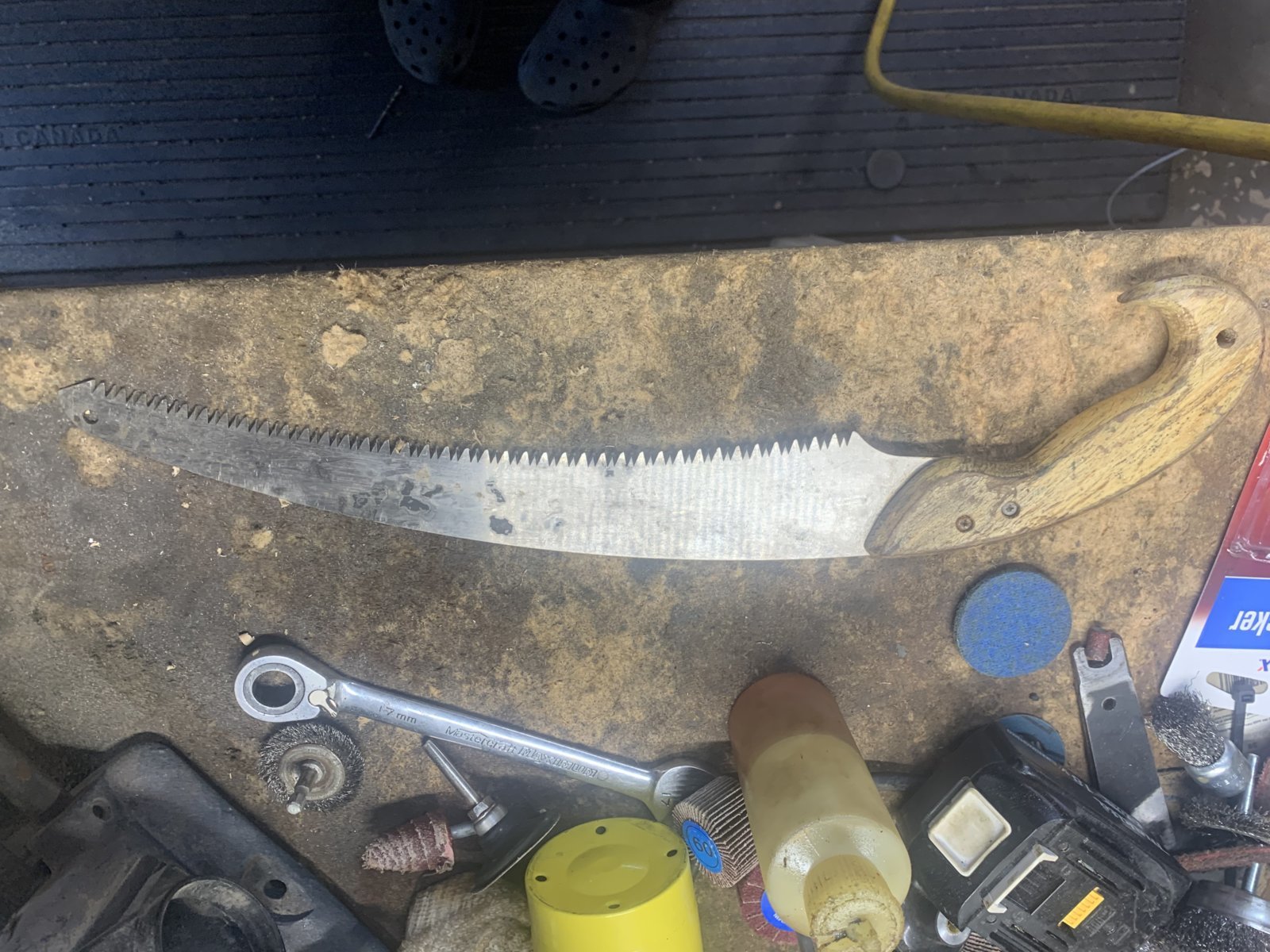

    So, it took me two hrs to fix my neighbours pruning handle/blade. He got it from Lee Valley here in Ottawa, and when he brought it back, they told him he didn’t buy it from them. Laughable, as it is laser etched with “Lee Valley”. He said he didn’t have that receipt, and in their system they found all his receipts except that one and two others. Lol!
    I ditched the tiny 1/4” screws/bolts and ground out the holes in the blade for some SS M8 bolts. That sucker will never come loose or break. Again, so tired is pi$$ poor quality/engineering all in the pursuit of the almighty $$$.
    This is my mid-level “Japanese” pruning saw that I also got at Lee Valley. Look at those tiny screws/nuts. Crazy!

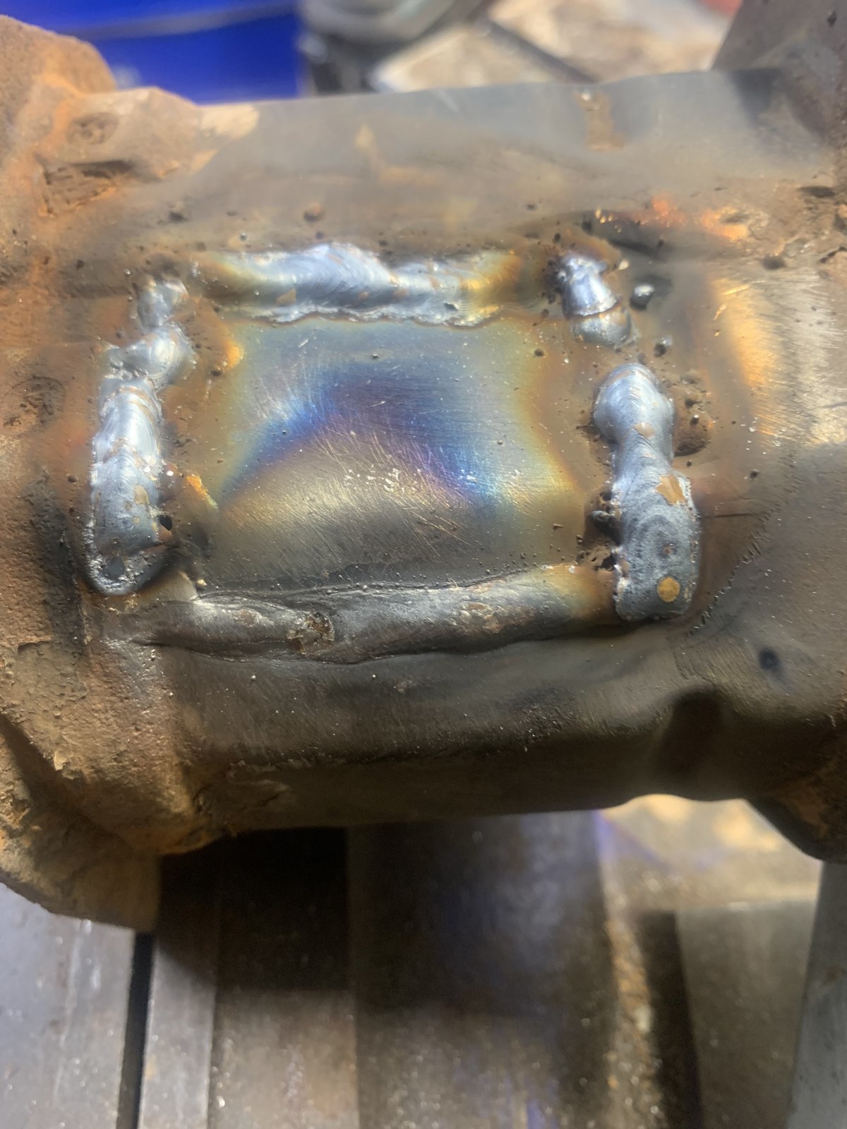

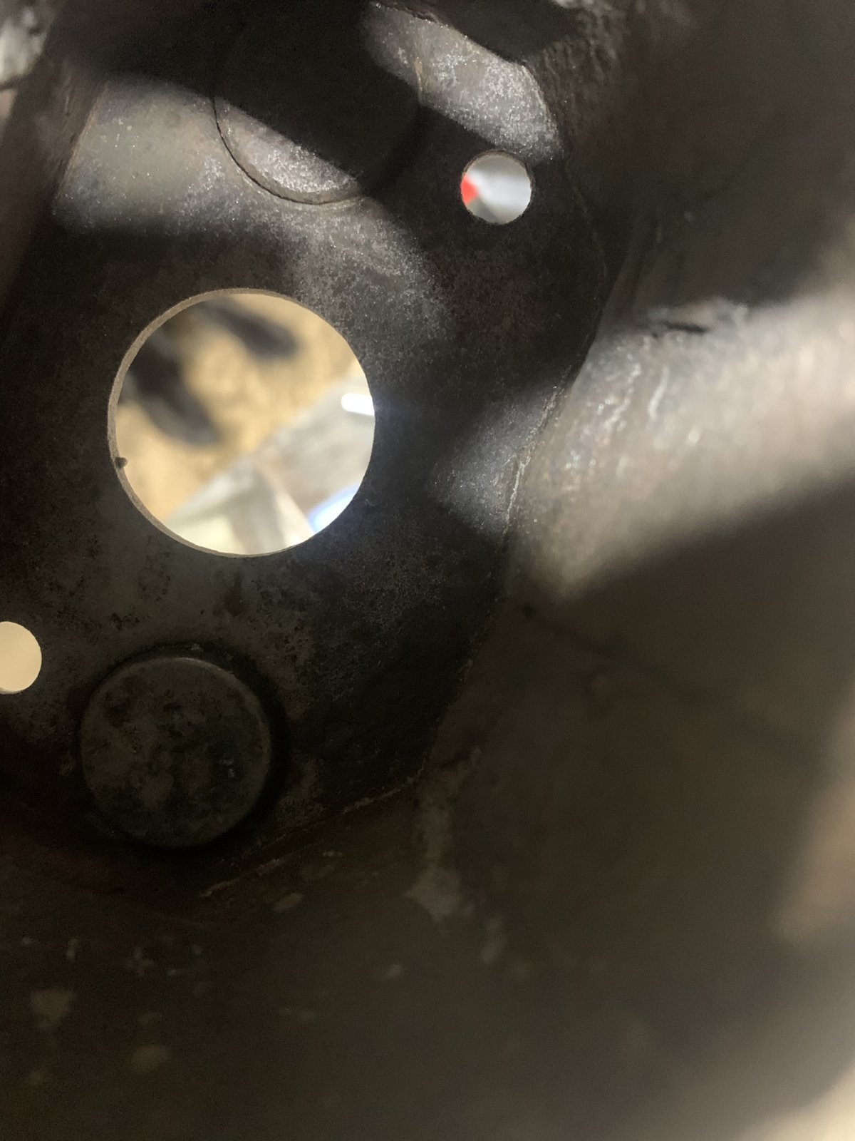

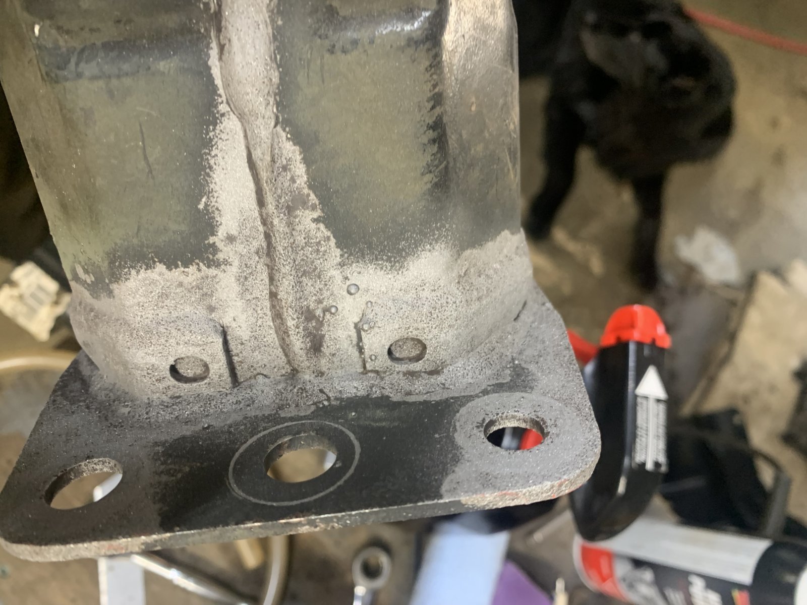

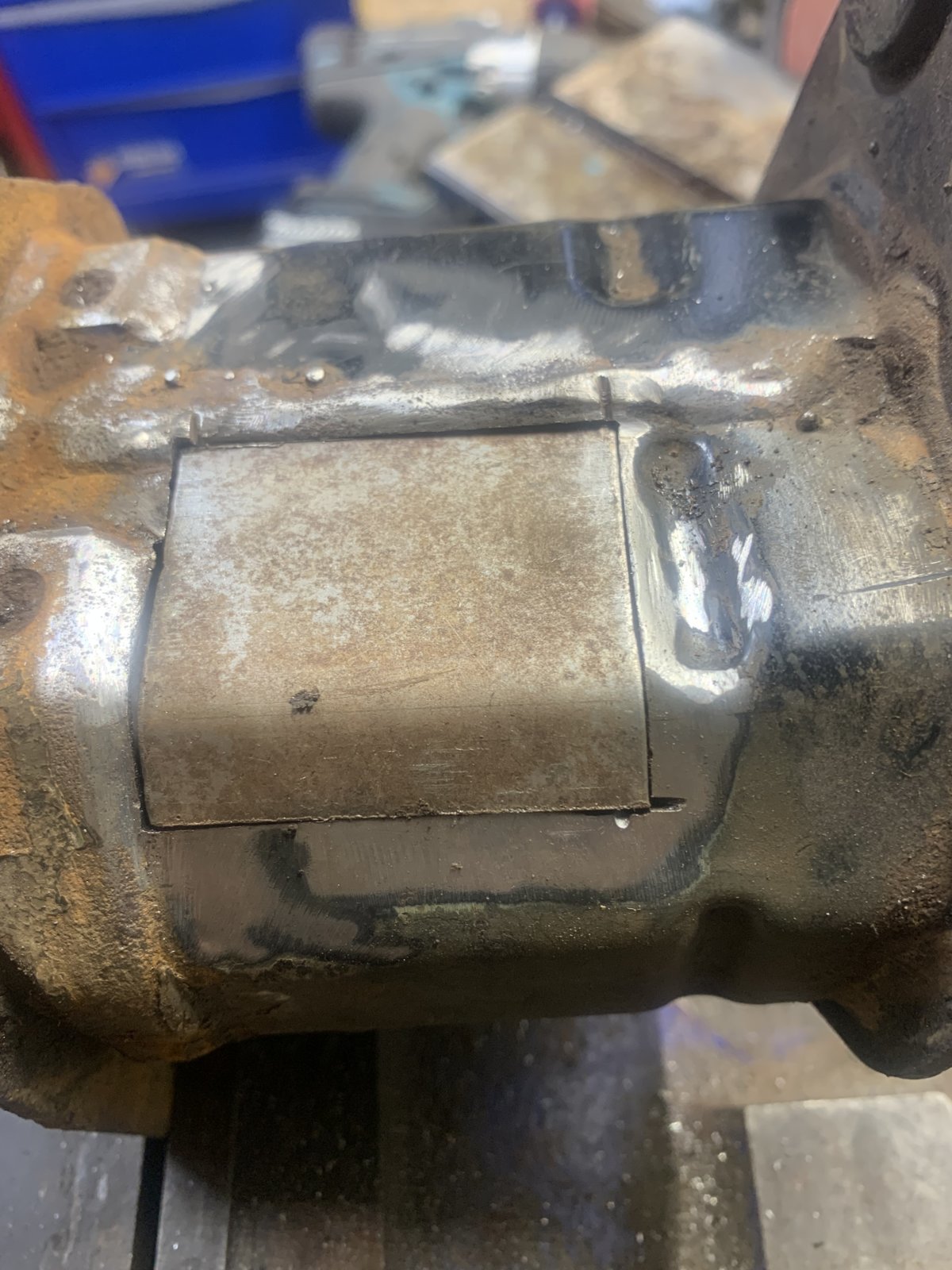

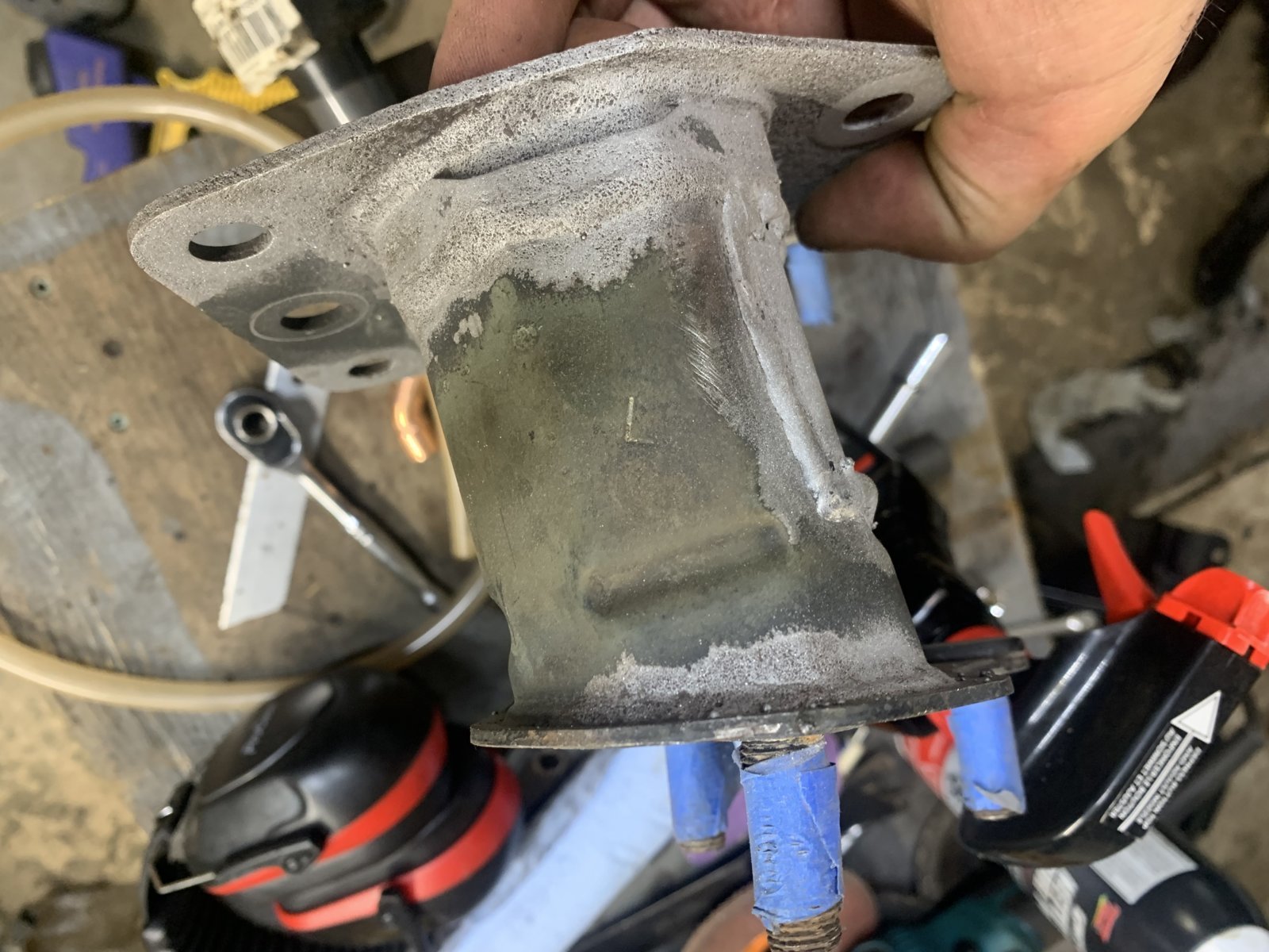

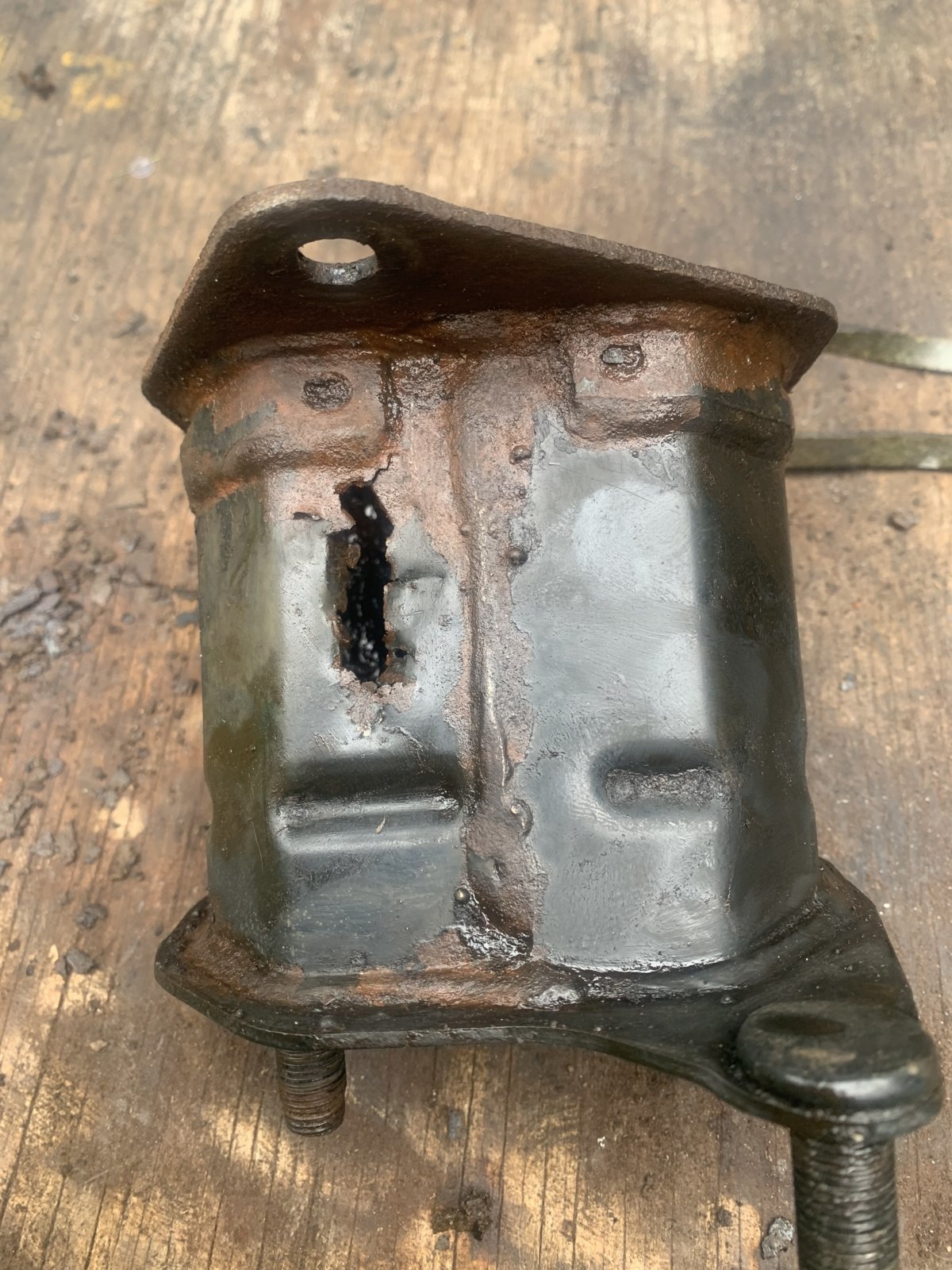

    Not sure how this happens as both ends are closed when bolted up. Will cut out and patch what I can. Have to go into town, so day is shot. At least the have wave us over with.

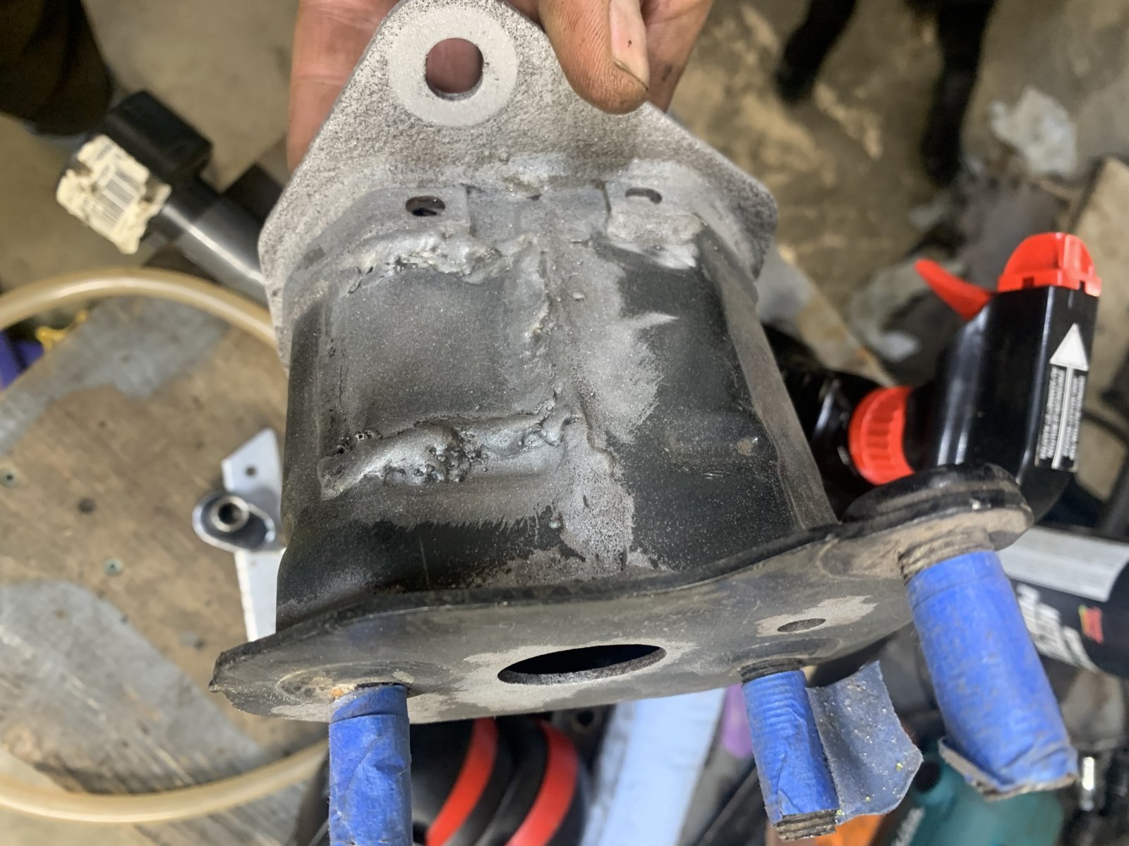

    Patch made of some 12 Ga.

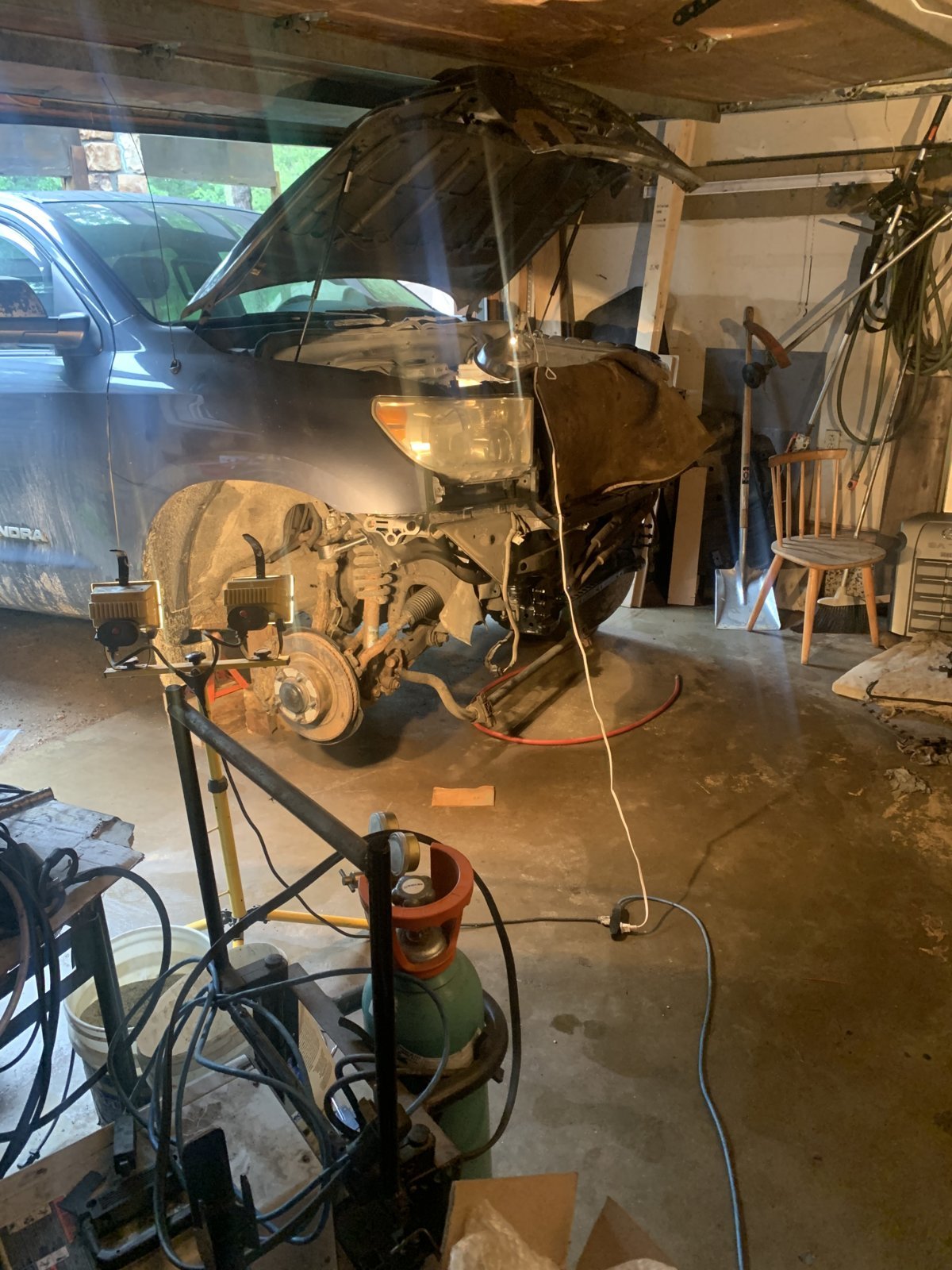

    Just going to leave weld)s) as is. My biggest problem with welding is seeing where I’m going. Not that I’m any good, but if I could actually see the part/weld direction, my welds would be a lot better. I don’t need corrective lens or anything like that, it’s just that it is too dark. I’ve tried 2-3 cheap welding helmets, and no difference. I really need to get a top tier helmet.

    Try getting a bright backlight. I have the same problem and need readers. So I set up a
    bright lamp so I can see around the weld puddle. Seems to help me

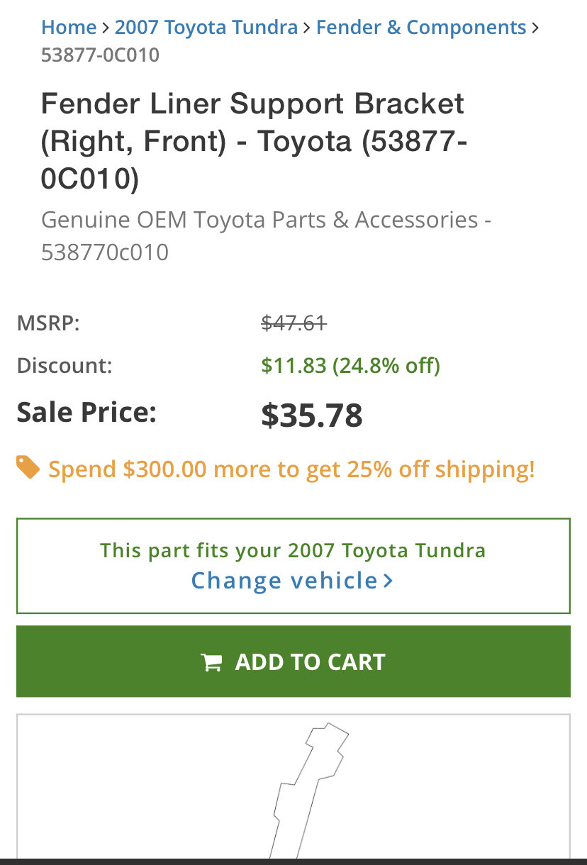

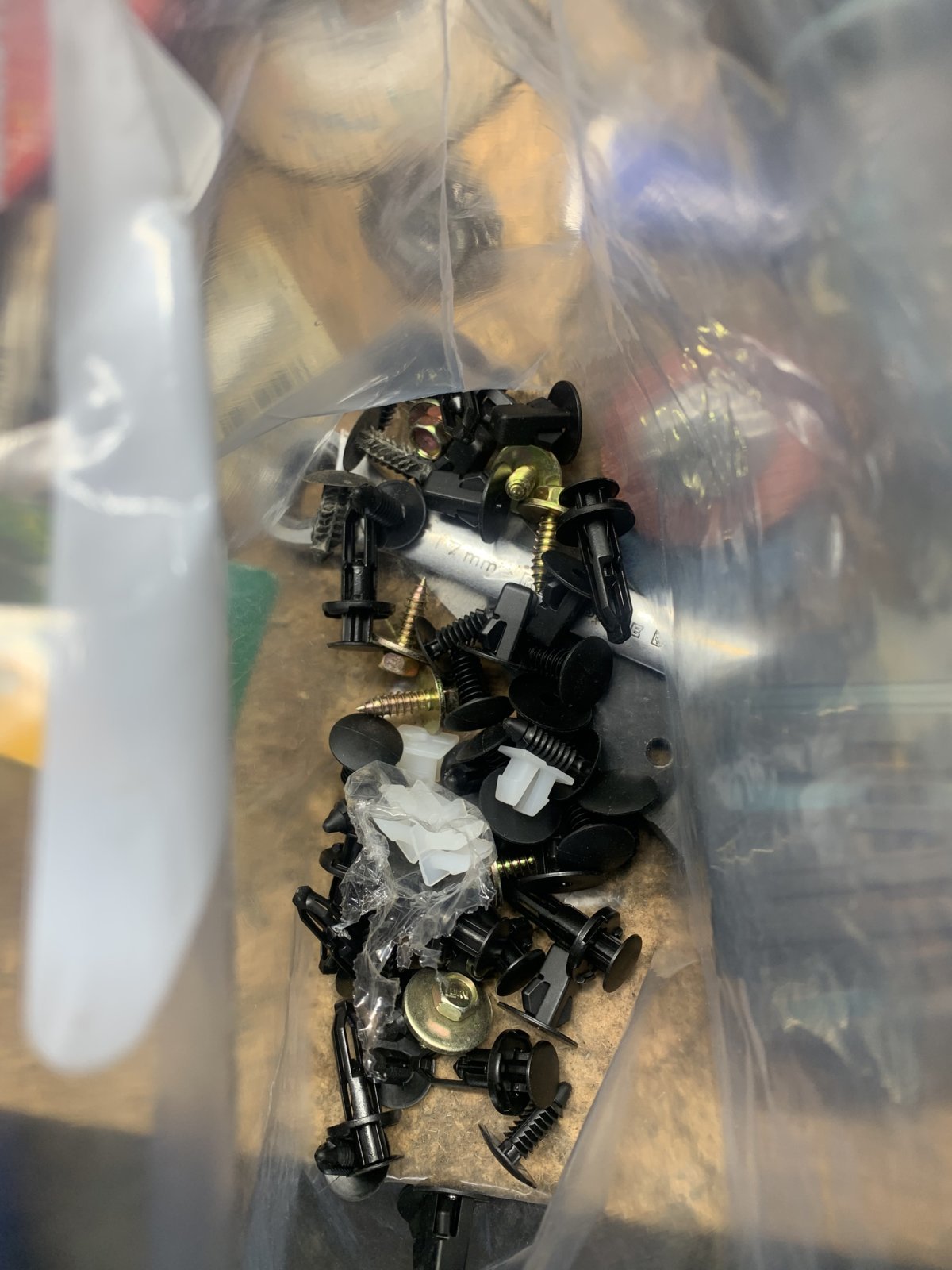

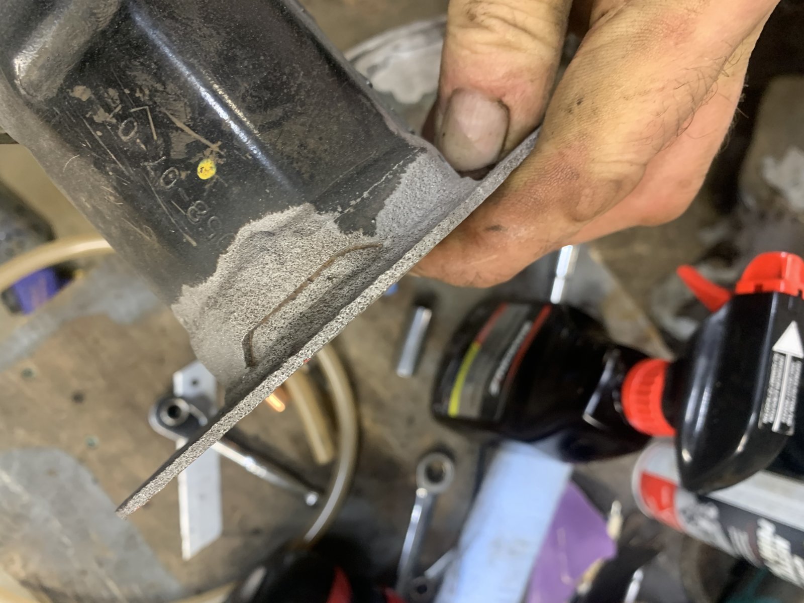

    Scored all this at the dealer. Lol! It’s just crazy regarding the amount of different styles of screws, plastic plugs, and clips used to secure the front bumper, and lower wheelwell guards. I’m still missing some, but this will get me going. Also asked if they were affected by the massive cyber attack on the CDK system used by dealers, but he said they use Reynolds?, and so no issue.

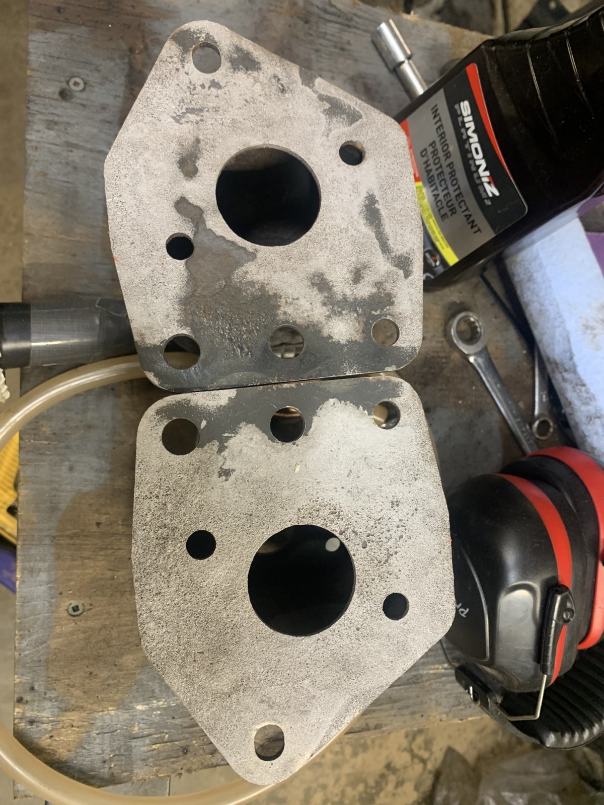

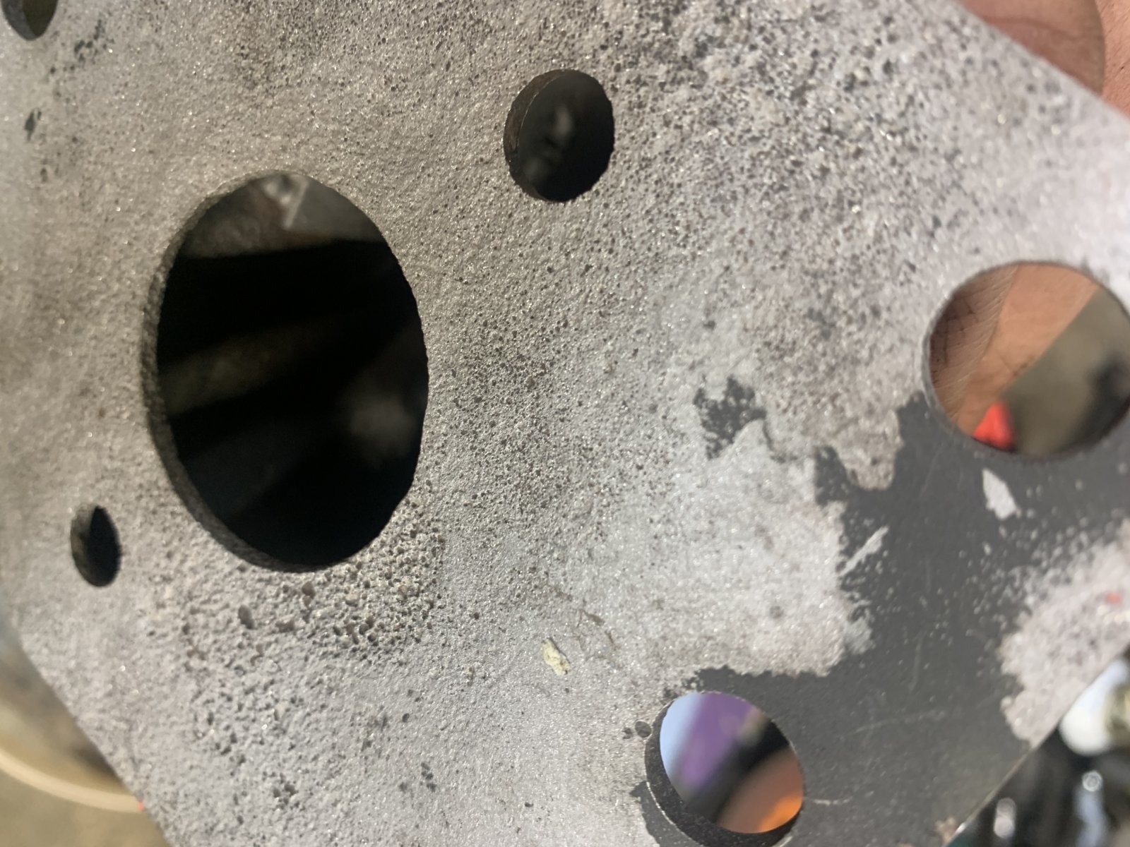

    It’s now raining out, so going to put the bumper brkts in my blast cabinet. Will only do the rusted areas and as much of the interior surfaces as I can reach.

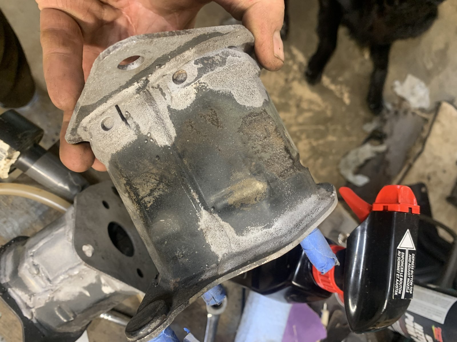

    Even though the HF cabinet is a bit hockey, it does get the job done. Remember going down to Watertown, NY to pick it up as at the time it was about half the cost of the PA one available here in Canada.

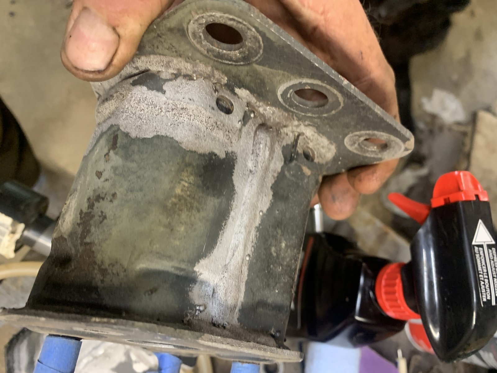

    Even the insides cleaned up a bit, although hard to see much.

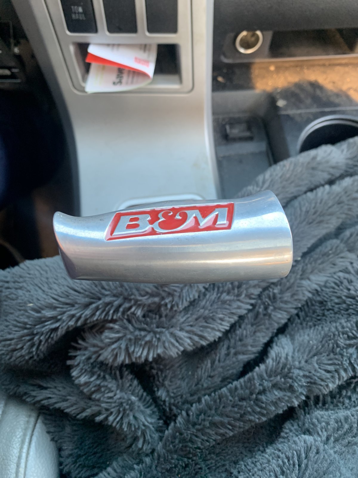

    Didn’t start re-assembly last night. Decided to fab up the adapter after supper today to mount the B&M shifter handle. Will have to make some type of decorative piece to cover up the adapter.

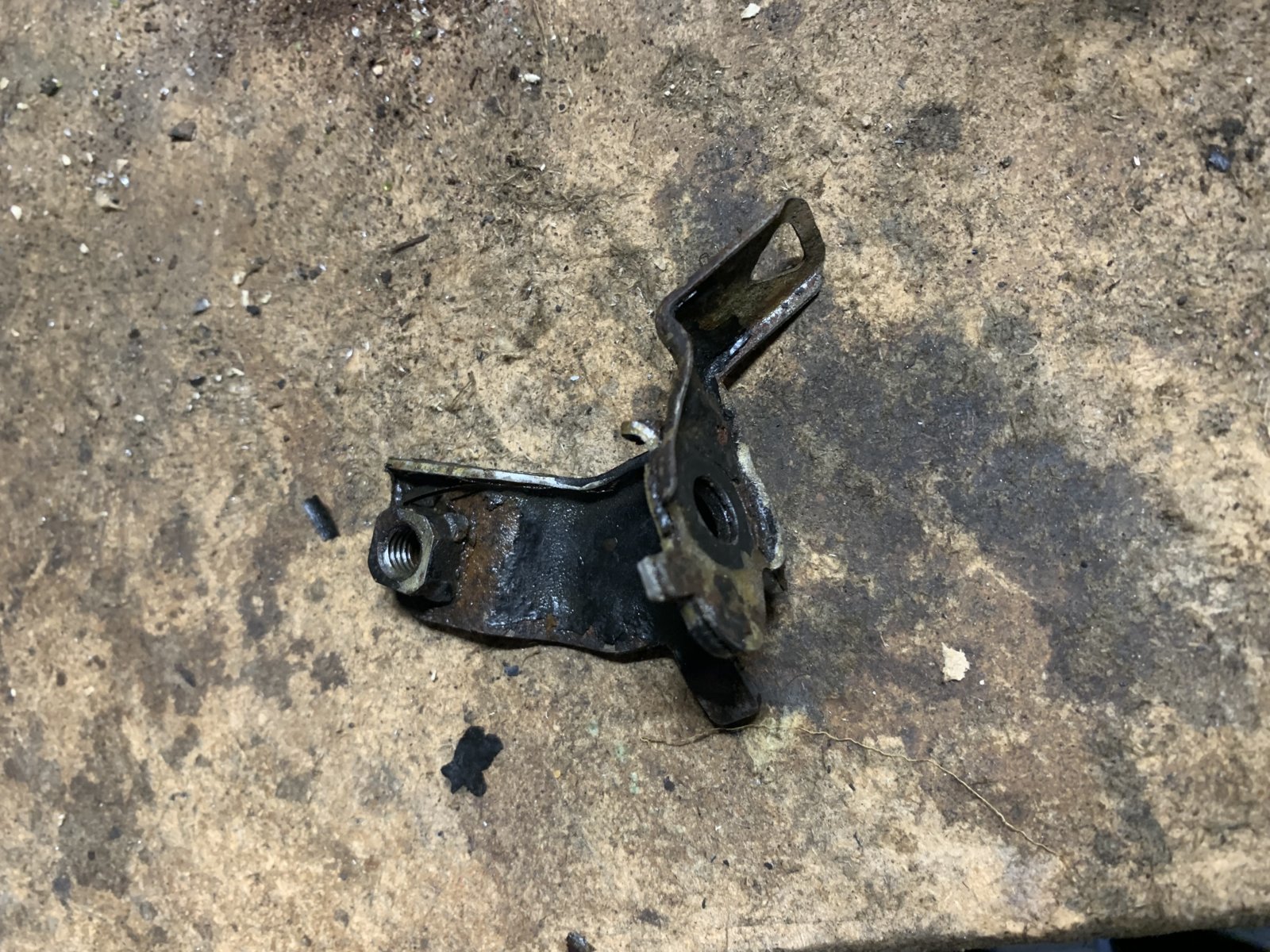

    Power just came on. Had just torqued all the bolts/nut for the alt, and now cannot find the two small brkts that hold the alt harness. This kinda stuff literally drives me bat $hit crazy. Was placing all that stuff in a oil pan, and nope those two things are gone. Have no idea where I might have put them. This is a problem when something like this drags on for weeks. At least for me I always have serious issues trying to find stuff.

    Getting there. PS pump installed (was a pain lining up the thru-holes). Still haven’t located the two brkts, so tie-wrapped up the electrical harness. Serpentine belt installed along with thermostat. Next up is the rad. They double boxed it which I wasn’t expecting, but guessing that is normal.

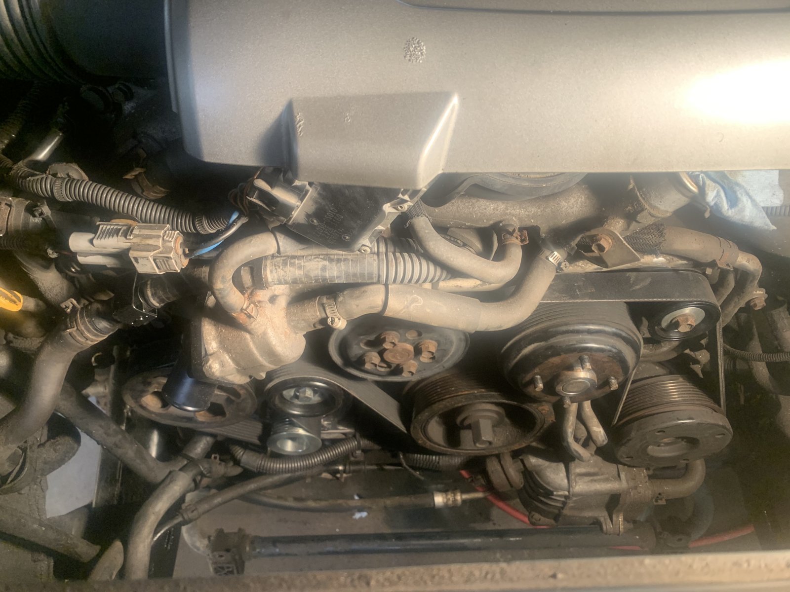

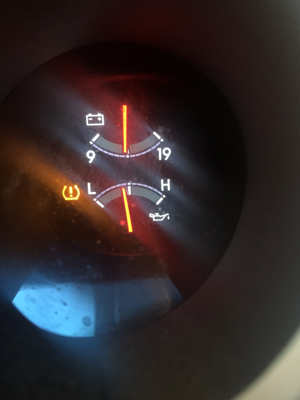

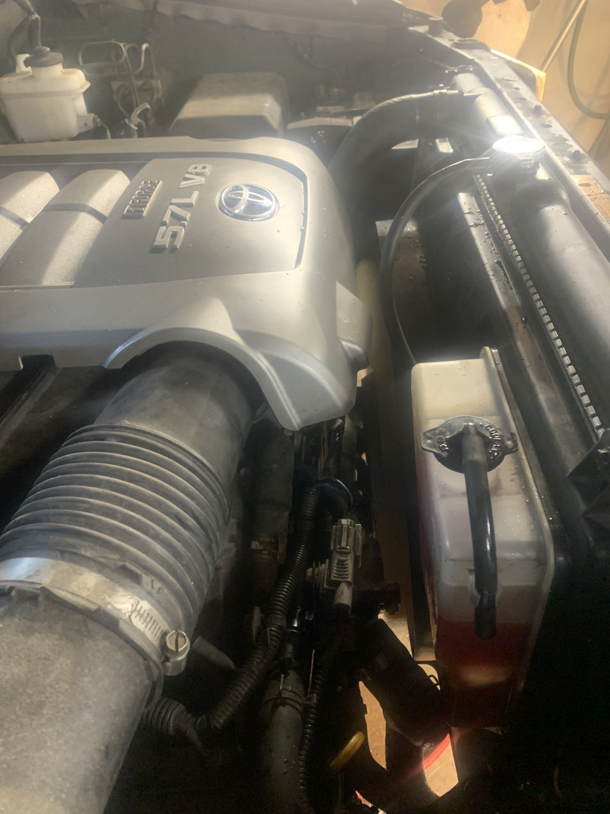

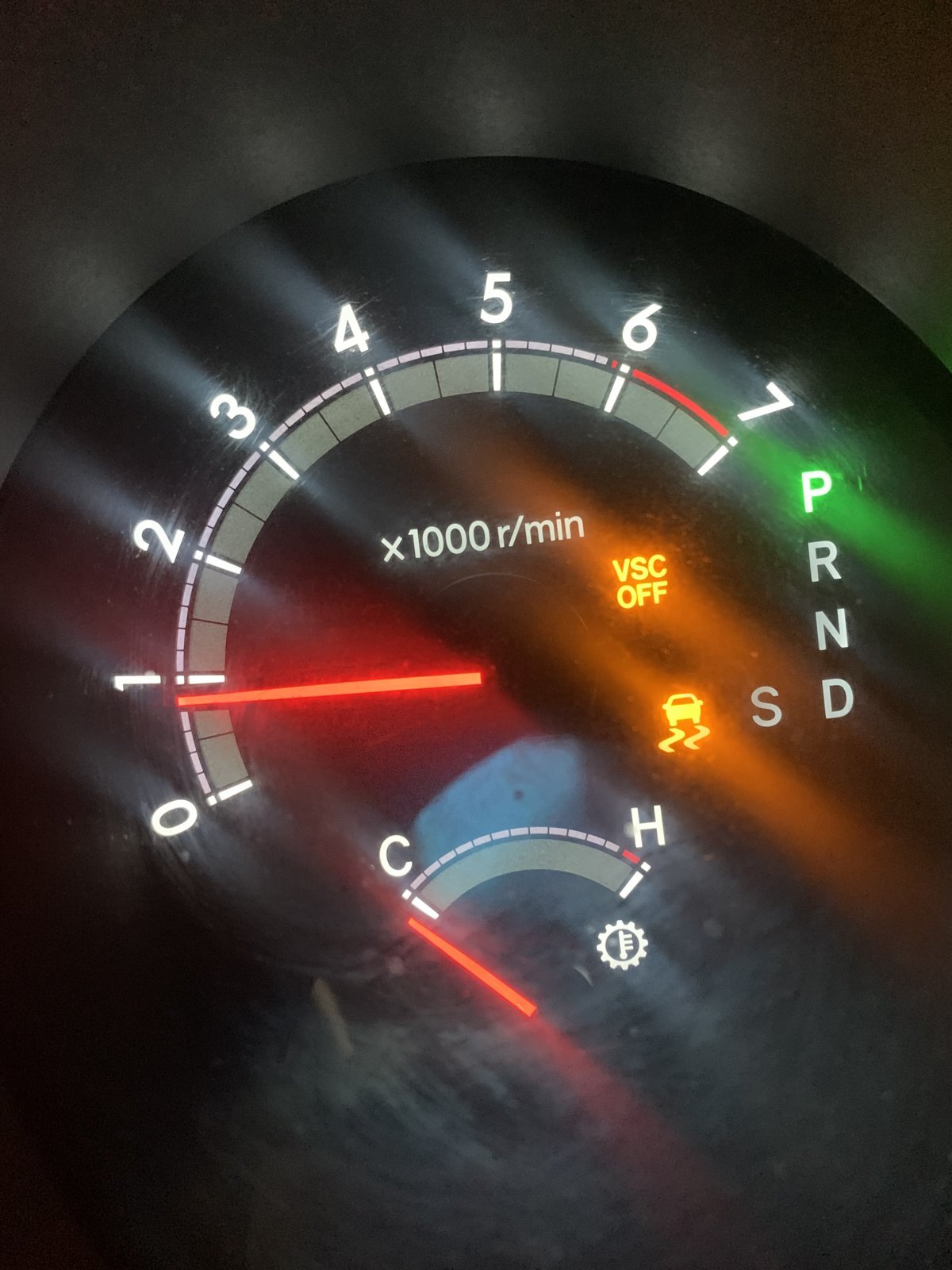

    Well, miracles do happen. She is up and running. Charging good, no rattles, no leaks. Will need to attach the front bumpers, and wheelwell liners tomorrow. Getting the nuts started for the fan hub was probably one of the most frustrating tasks I’ve ever come across in all my years of working on vehicles. Can’t get my hand in there to get them started, so had to use the open end of the ratchet using a small piece of shop towel to keep the nut from falling out, and then hoping against hope I could get it started. First attempt had the hub on crooked, so back off the two nuts that I managed to get on, loosen tension on the belt to try to get the fan pulley to try to sit proper vs sitting canted as soon as the tensioner is let go, and the belt pulls the pulley crooked again. The studs are just barely long enough to get the nut started. I dropped the fan several times initially because again the studs are too short to keep the fan hub on. It marked up the new rad pretty good, and I was really worried that it might have pierced the rad. It was a total $hit $how. Ended up cutting a piece of cardboard out of the box the rad came in, and used it to slide between the shroud and the rad to help protect it.
    This will be my last Toyota. I’m totally fed up with how everything is so absurdly designed making servicing a total nightmare.
    A few pics, but not much to see…
    Got the 4Hi/VSC flashing lights again. I figure it’s moisture in the connector/circuit.

    Found the one brkt that bolts to the alt. Was in a container of vinegar along with the lug bolts. Oh boy, I thought I had blasted and painted it. D’oh! So, off into the cabinet and then primer/paint. Will likely fab up a new brkt for the missing one. Talk about misadventures. Still raining…

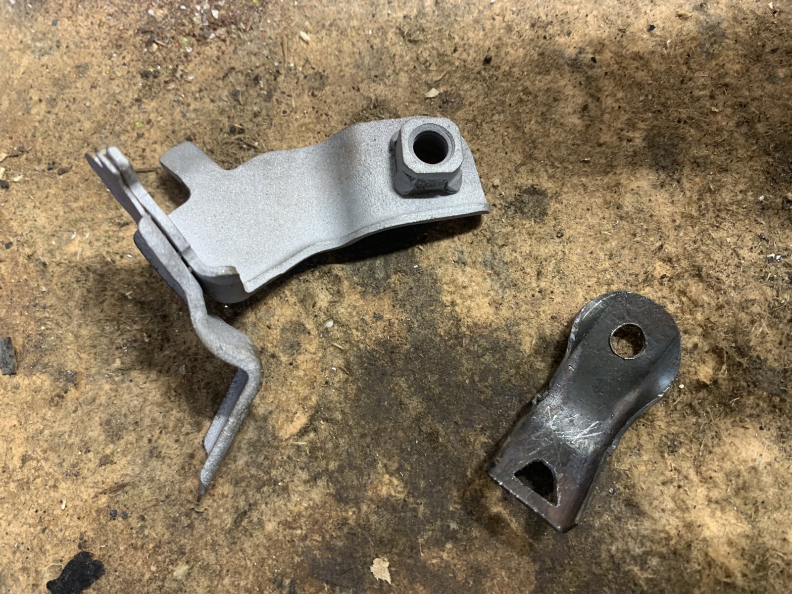

    Media blasted, and new brkt. Should have made a new one from the beginning.
