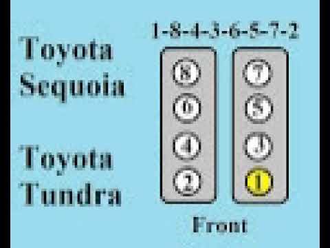

    Even tho your 05 is a Sequoia, it’s firing order is same as Tundra. Prove it further if still insure of answers here and unplug driver side # 1 cylinder ignition coil and see what code appears.

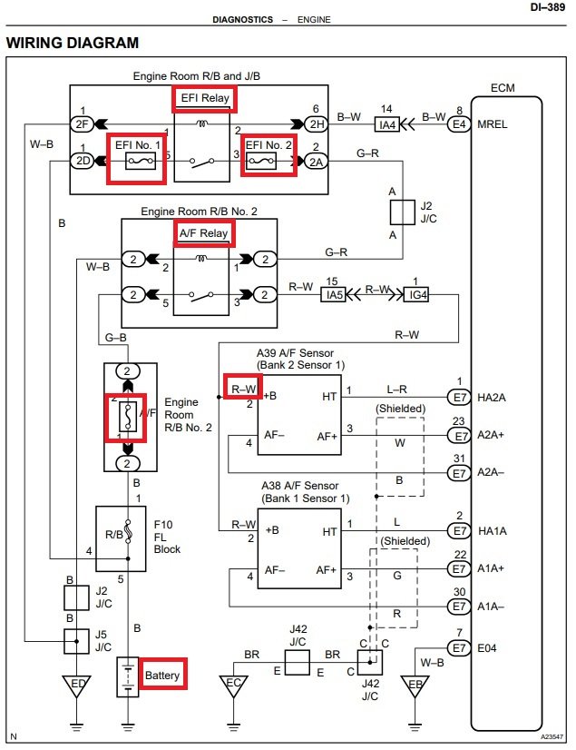

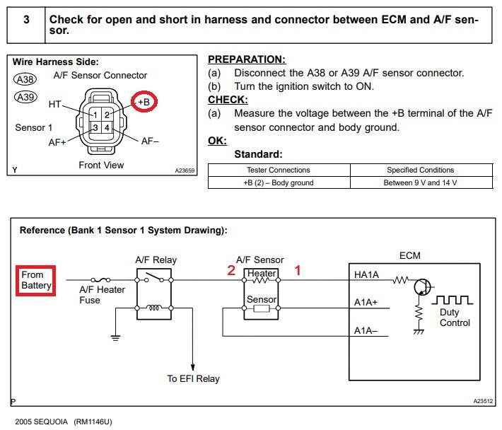

    If your Sequoia is like our Tundras, checking pin 2 of the A/F sensor is difficult but doable. That said, I would suggest unplugging B2S1 and check for 12vdc to GND at pin 2 of Bank 2 Sensor 1 with ING ON/EG OFF. According to an 05 Sequoia FSM and EWD, pin 2 of B2S1 is Red-White in color.
    If no 12vdc at pin 2 of either sensor, the items to double check that would prevent lack of 12vdc at pin 2 of both A/F sensors are EFI Relay, EFI No. 1/EFI No. 2, A/F Relay and A/F fuse. You can only hope it's not the ECU side of A/F sensors.
