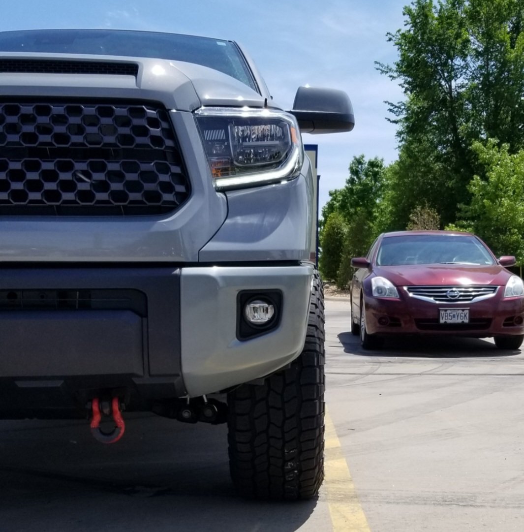

    Alright op. I'm gonna go out on a limb here and recommend the bilstein 5100 adjustable front shocks. Inexpensive. CAN be a diy with some simple tools. Adjustable (when not on the truck) from basically stock height to about 2 in lift. And superior to what you are currently running.
    You can always tweak, add shims, or spend more later but it will give you some options in the mean time. Also i don't get the impression you are going to be doing any serious off roading.
    When looking at wheels look for offsets in the 20-30 range. This is the sweet spot with out trucks to get the best clearance when upping tire size and avoiding the hit a bump and tire rub scenario described above.
    And with lifts under 2.5 inches you don't necessarily need to replace the UCAs.

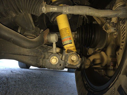

    Bump stop spacers. Any spacer level/lift worth buying will have bump stop spacers included to keep the shock from bottoming out, and extra clearance for bigger tires. They are also available separately if piecing together coilover shims, or fancy coilovers. Been awhile but had a set of Bilstein 6112, came with bump stop spacer. The LT kit on my truck has bump stop spacers also.

    They also make bump stop extensions to help offset the increased suspension travel. Lots of meat will fit in the wheel well. Tires rub when the wheels are turned and many times only at close to max. Therefore in order for this to occur, while possible would require you to hit a substantial bump hard enough to offset the suspension lift while your wheels are turned pretty significantly to one side or the other. Even then the first place people gets 'rubs' are generally on wheel well plastics. That's assuming you havnt chosen a 'bro dozer' negative offset in which case you might contact your fender.

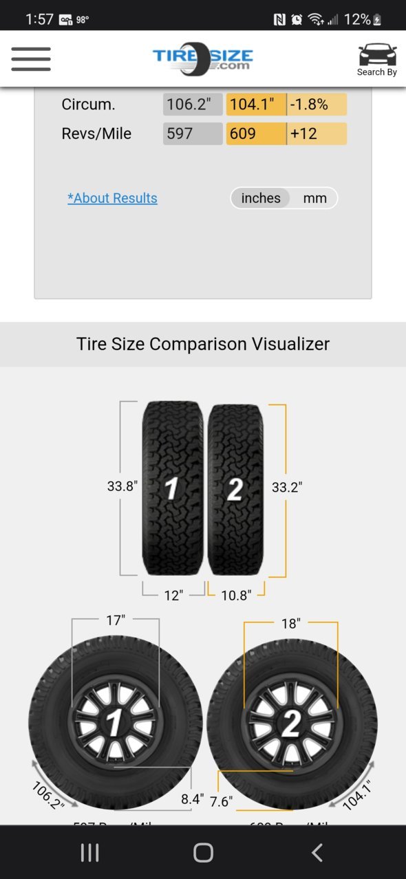

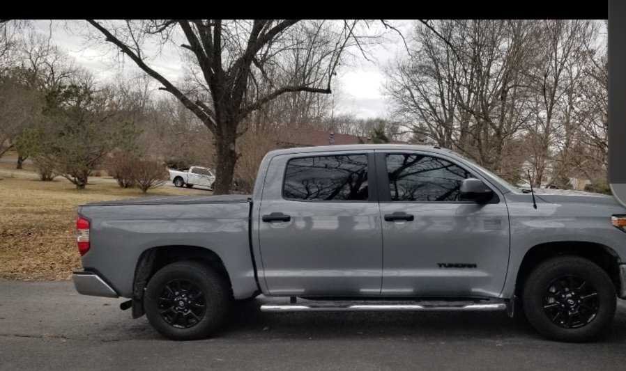

    So here is some reference:
    Stock 18, stock size tire vs 17in wheel slightly larger tire adds 12 rev/mile Screenshot_20220722-135718_Chrome.jpg

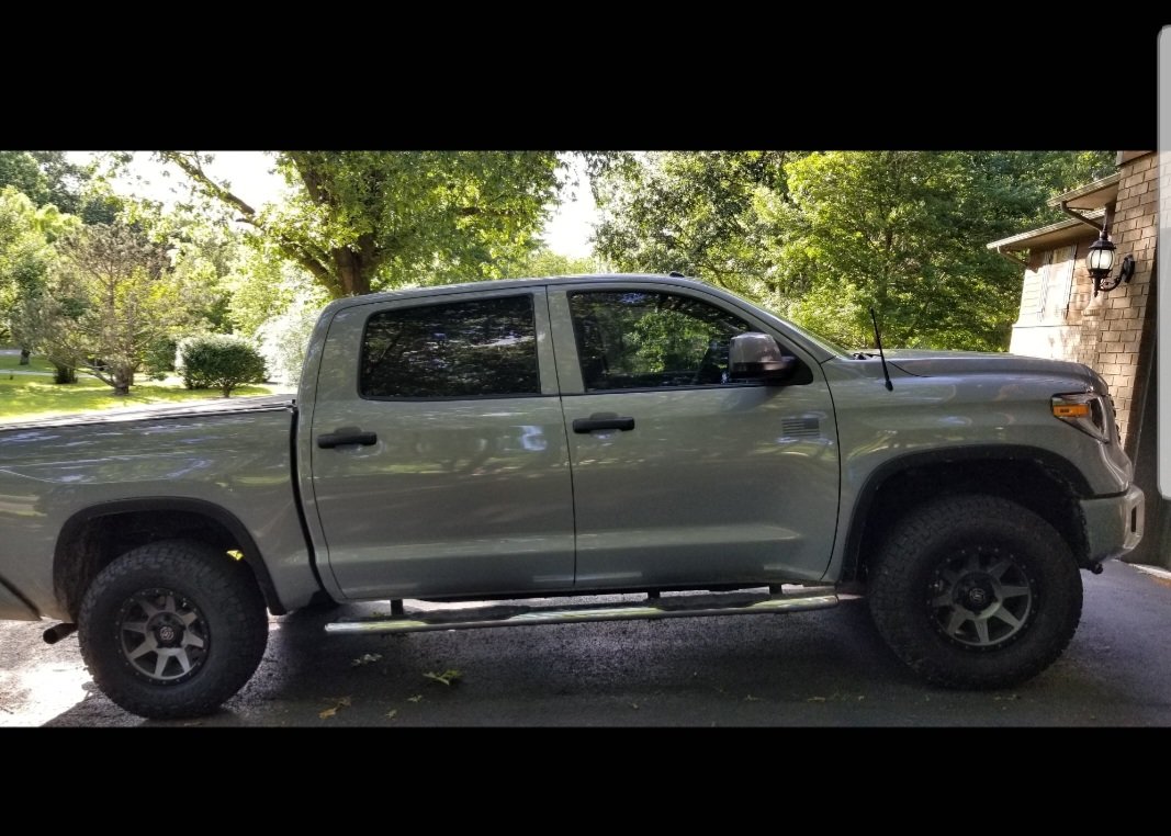

    Here's the real life before and after including a 2in lift in the front and 1in shackle in the rear: Screenshot_20220722-140520_Gallery.jpg Screenshot_20220722-140213_Gallery.jpg
    The wheels are 8.5 inches wide, have a +25 offset and here is the 'poke'Screenshot_20220722-140233_Gallery.jpg
