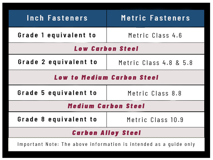

    Just a generic reminder for anyone, grade 8 standard is not the same as grade 8.8 metric. Metric also has a 12.9 grade and those are usually allen head fasteners.

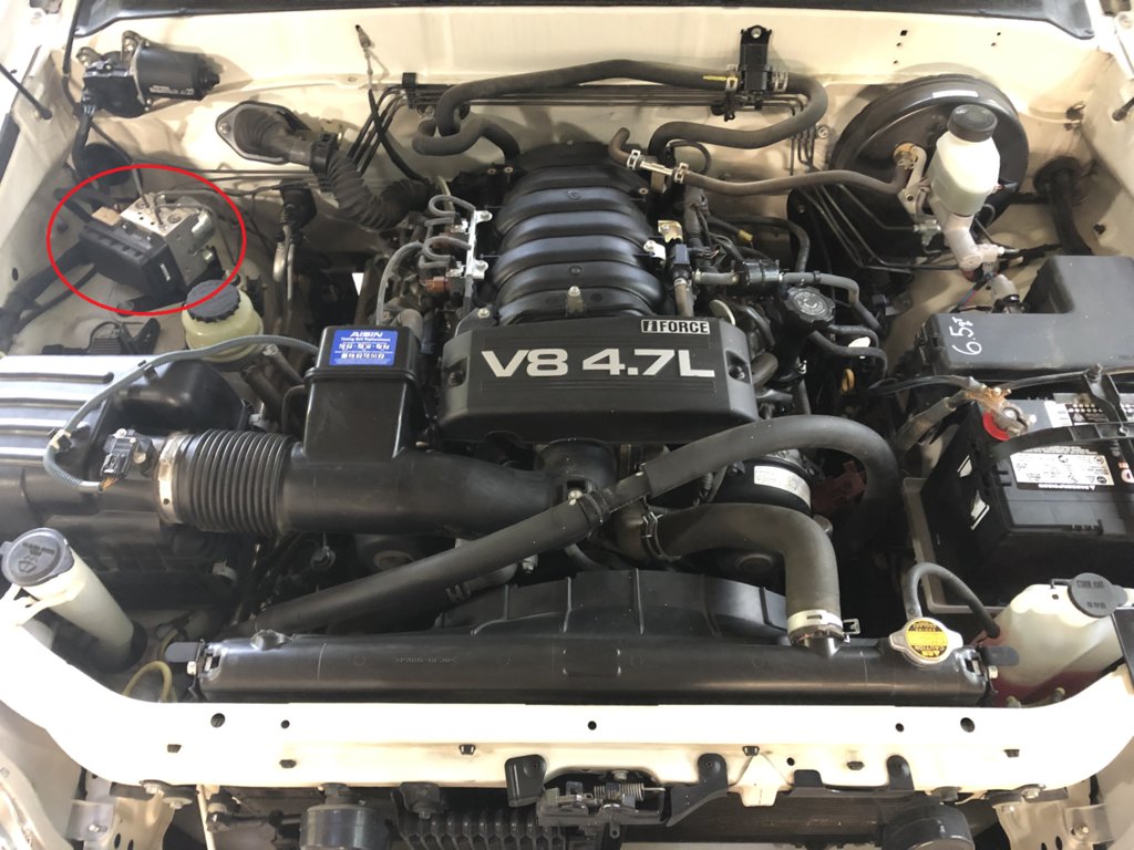

    Loyal yard had a compatible non- abs spindle off a 4runner, and I could have sworn I checked and my truck was non- abs so I purchased it. Just to realize tonight mine is ABS. Is that possible to run a non- ABS spindle on an abs truck?? I'm assuming it will leave that ABS line with nowhere to go, but will that be a problem?

    Your ABS light will be on in the dash. ABS can't necessarily function without a functional sensor at all 4 wheels. I'd hunt down an ABS knuckle.

    Oh okay. I just ordered an ABS one so good to know it’s the best route.
    I do already have an abs light on I think the abs wheel speed sensor isn’t attached on my rear left wheel so maybe it wouldn’t have mattered but whatever.
