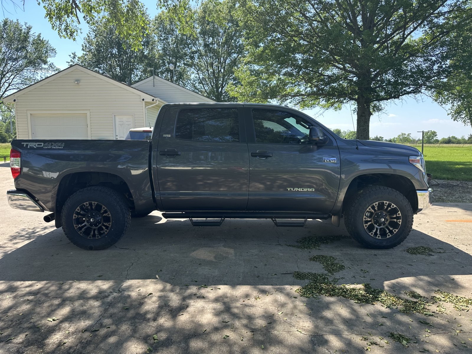

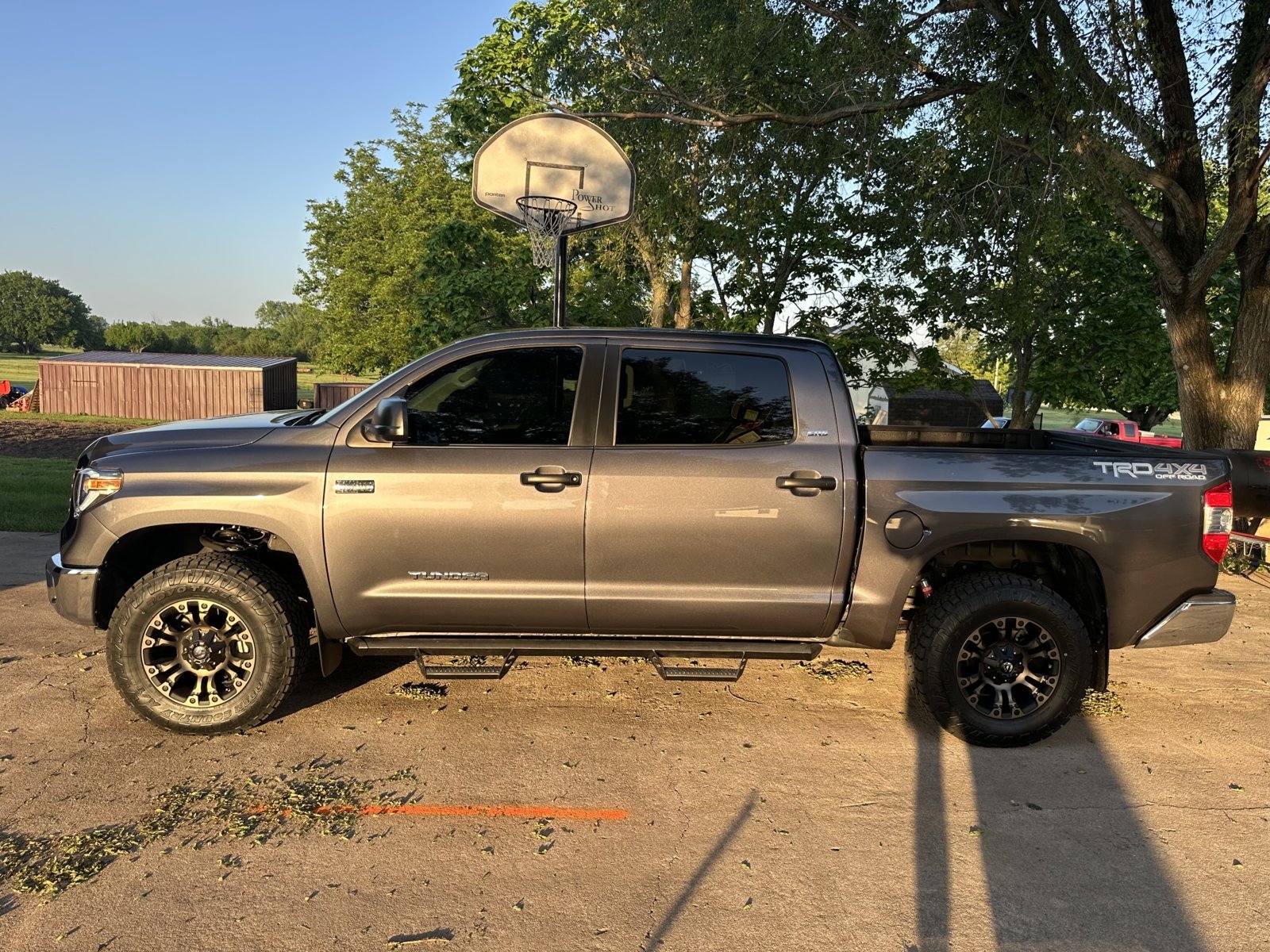

    Eibach suspension,wheels and tires
    Eibach stage 1 suspension at 2nd from highest setting which I believe is 1.9 inches. Toyo open country at/3 275 70 r18. Fuel vapor with +20 offset. Removed little flaps behind front bumper because of slight rub

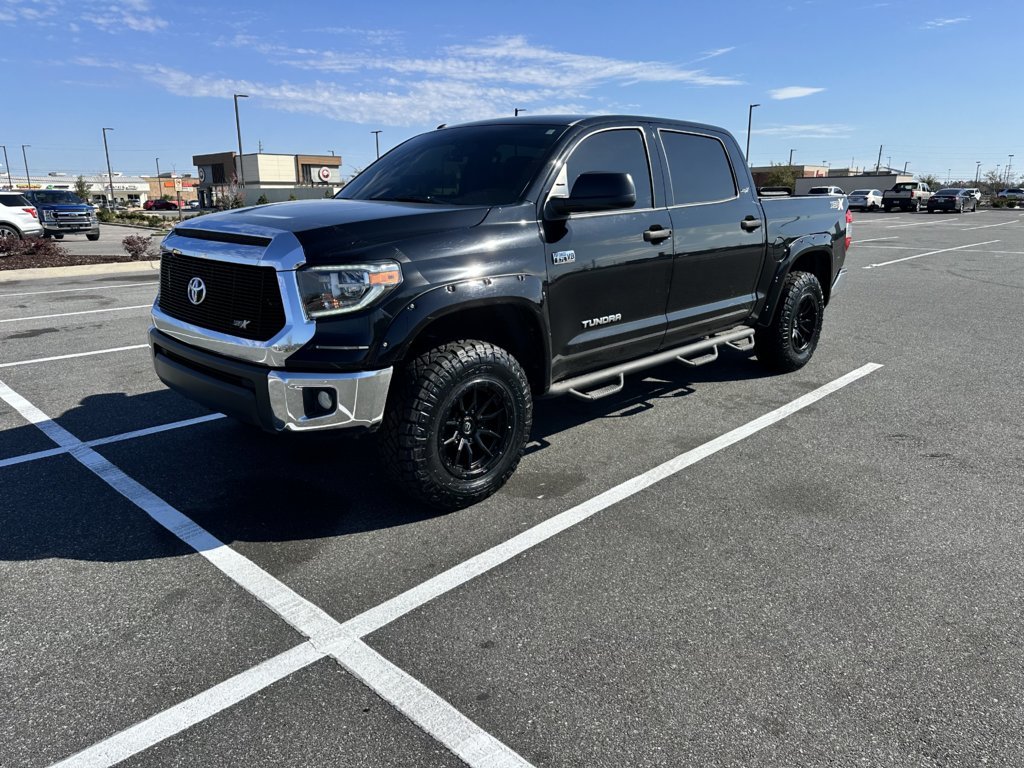

    Just got these 275/70/R18s installed

    Hi is this on stock suspension? No rubbing or trimming? I just got a 2020 sr5 4x4 and the stock tires on them are 255/70 18 and was wondering if I can upgrade to 275/70 18 with no additional lifts or leveling kits

    My 2018 stock is 275-65-18. You can confirm but I bet yours was too originally Many people go 275-70s on stock. Scan through this thread and you’ll see a bunch of examples
    Edit. I stand corrected. Looks like 255 was also a stock option. Hmmm. I guess because my sr5 had or package I had 275-65. Both are 32”. One narrower of course

    I’m running 275/70 18s with my truck leveled with bilstein suspension. Otherwise stock.. I’ve seen others do it.. worse case you might have to trim a bit of the plastic under the fender but shouldn’t need any major modifications
