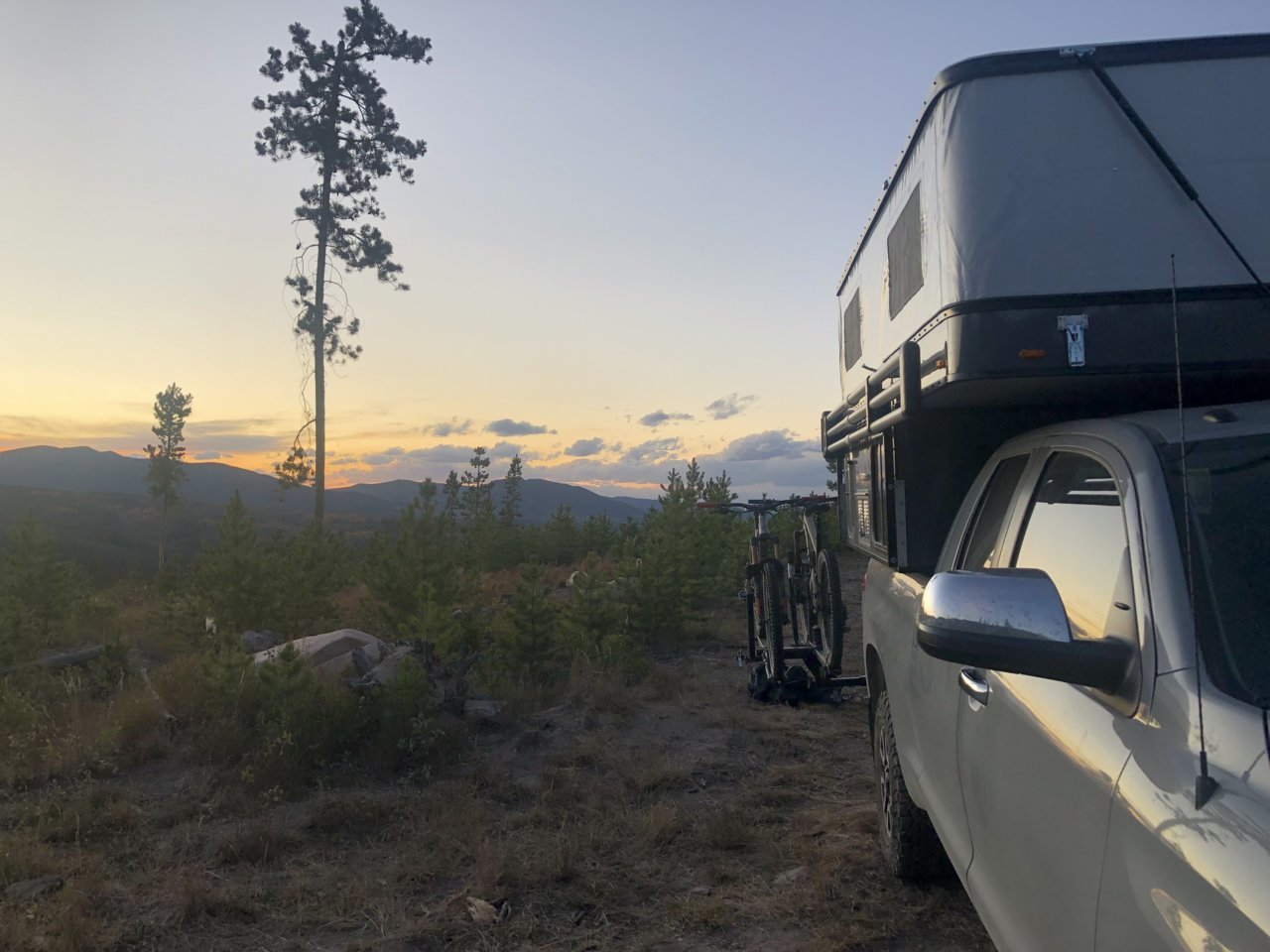

    I have a 19 4wc hawk on my 19 DC limited and couldn’t be happier. Air bags are a must. Additionally, you will need E rated tires, anything less will be cut if it even sees a rock. Let me know if you have any questions on campers or the rig. I spent months looking into the dream build. I have a few more upgrades in the mail the and I’ll likely post a full build thread going over both the truck and camper.

    @RideorDie Do you know what your truck weighs with the camper on it? Been going back and forth with them, but I can't get the weight numbers to work out. With the Raven model and extras I want on it, it comes in at 1450 lbs. Nice looking set up.

    I am actually taking it back in to be scaled this week with the camper on and wet. My truck weighed~5300 If memory serves correctly prior to camper and camper weights 1450 dry. Once I get back in town I can give you actuals of pre and post camper. Honestly the truck is handling the weight just fine. I don’t feel undergunned in the breaking or engine department. I am going to consider putting stiffer suspension in the front and the sway bar in the back but those are just wants...not needs
