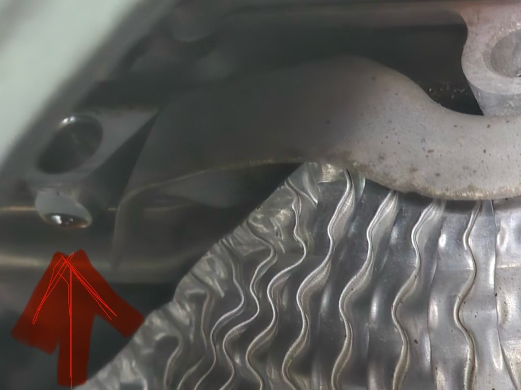

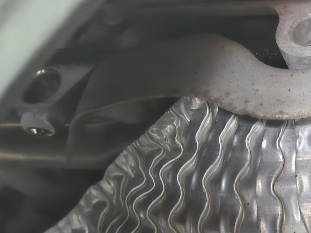

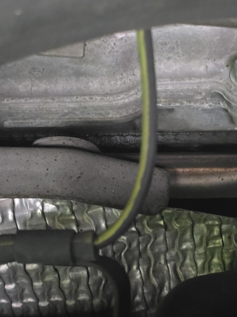

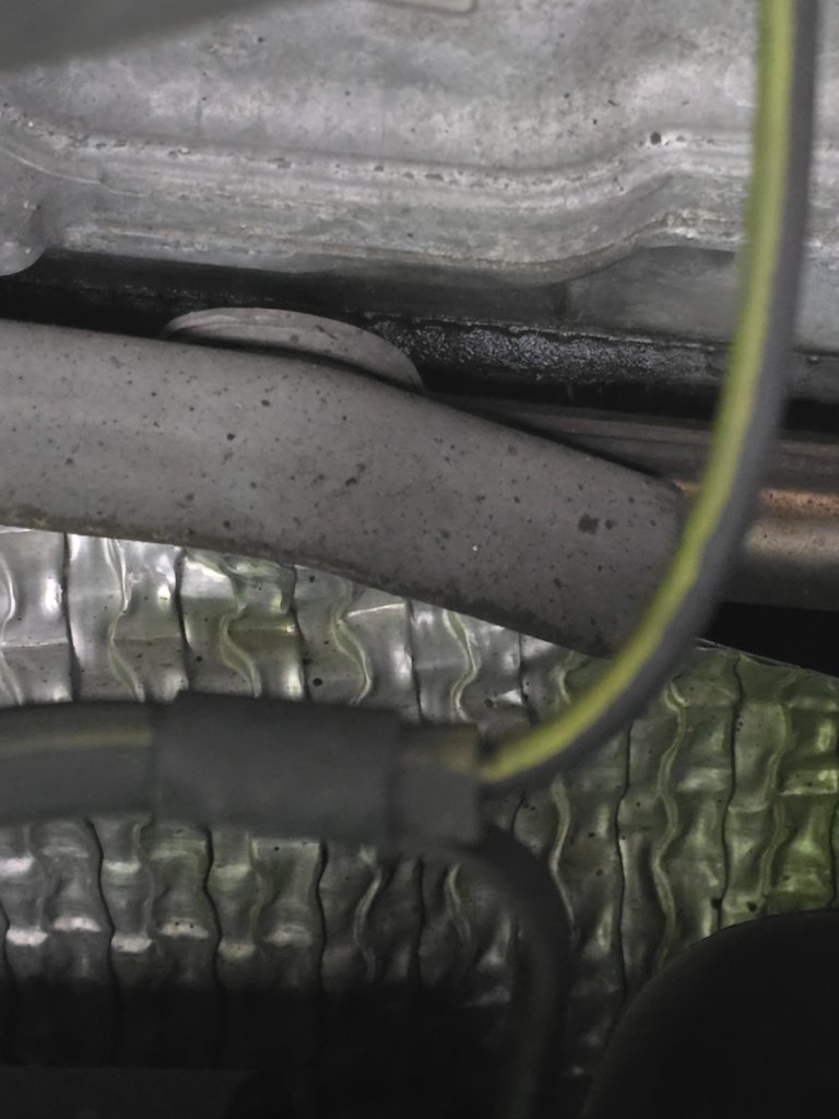

    Not looking good here. Only 32k miles on my 21 nightshade limited. Right driver passenger side.

  2. Aug 26, 2024 at 4:13 PM

    Feb 24, 2016

    Bummer.
    I would get it in right away for warranty coverage. With what is going on with the 3rd gen's...it will be all hands on deck for engine replacements.

    2021 Black Tundra limited Nightshade Edition
    Truck sounds and runs the same? Debating about trading it in but so many issues with the 3rd generations too

    Taking it in tomorrow. Hopefully the techs there know what they are doing.

    Anyone have more photos? Would like to throughly check mine. Thanks!

    I am not even sure I can see oil in OPs pictures

    This droplet looks like the worst of it. Good chance just a switch to 5w30 would stop it from leaking/slow it to being not noticeable (and result in less wear metals in the oil). Maybe I’d have it fixed under warranty, but I definitely wouldn’t pay thousands to fix it.
