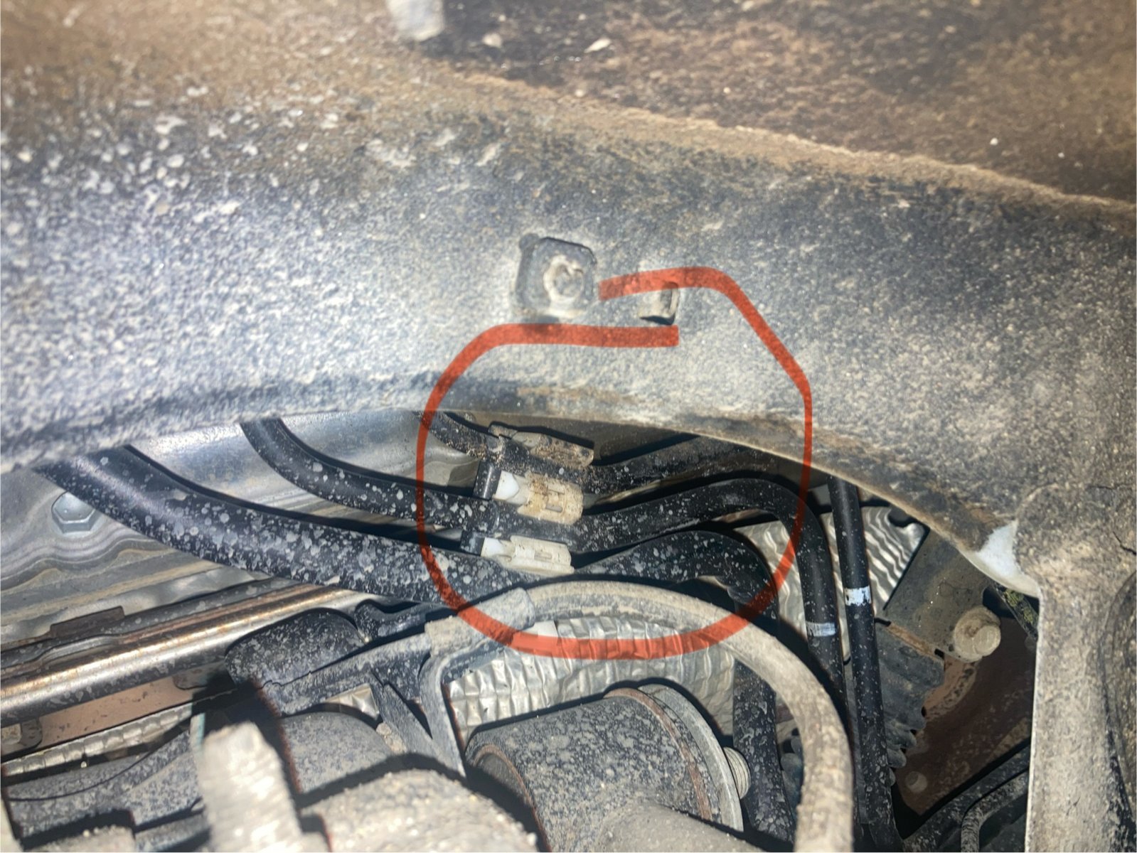

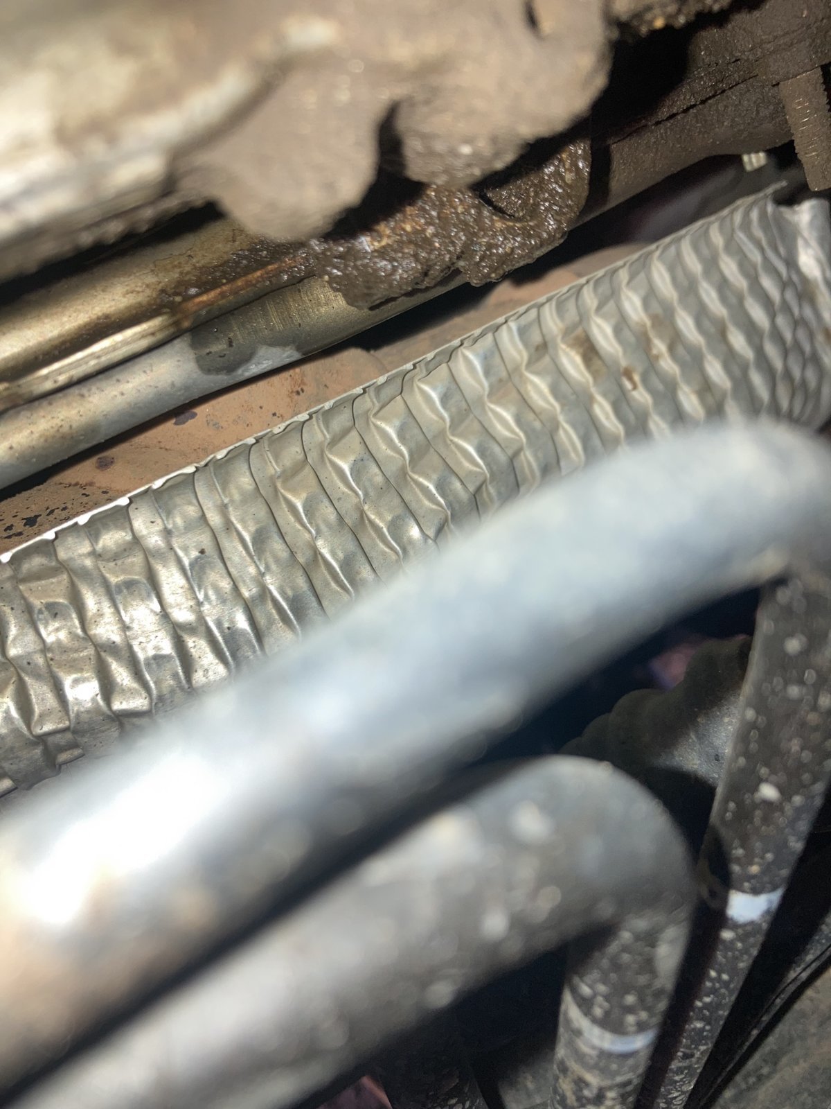

    2018 Tundra 5.7 owner here. This thread had me searching my front wheel well’s this morning.
    Found this on drivers side just behind I think are the brake lines. Same spot on passenger side is dry. Thoughts? Sorry for the bad pics. Phone has a trash camera upload_2024-2-1_13-36-22.jpgupload_2024-2-1_13-36-22.jpg

    Yet something else for me to keep an eye on. I’ll be getting a new timing belt in the spring as I have no idea when or if it has ever been changed. I now have 285K kms (178K miles).

    You get one or the other. Either timing belts (4.7), or cam towers (5.7). But not both.
