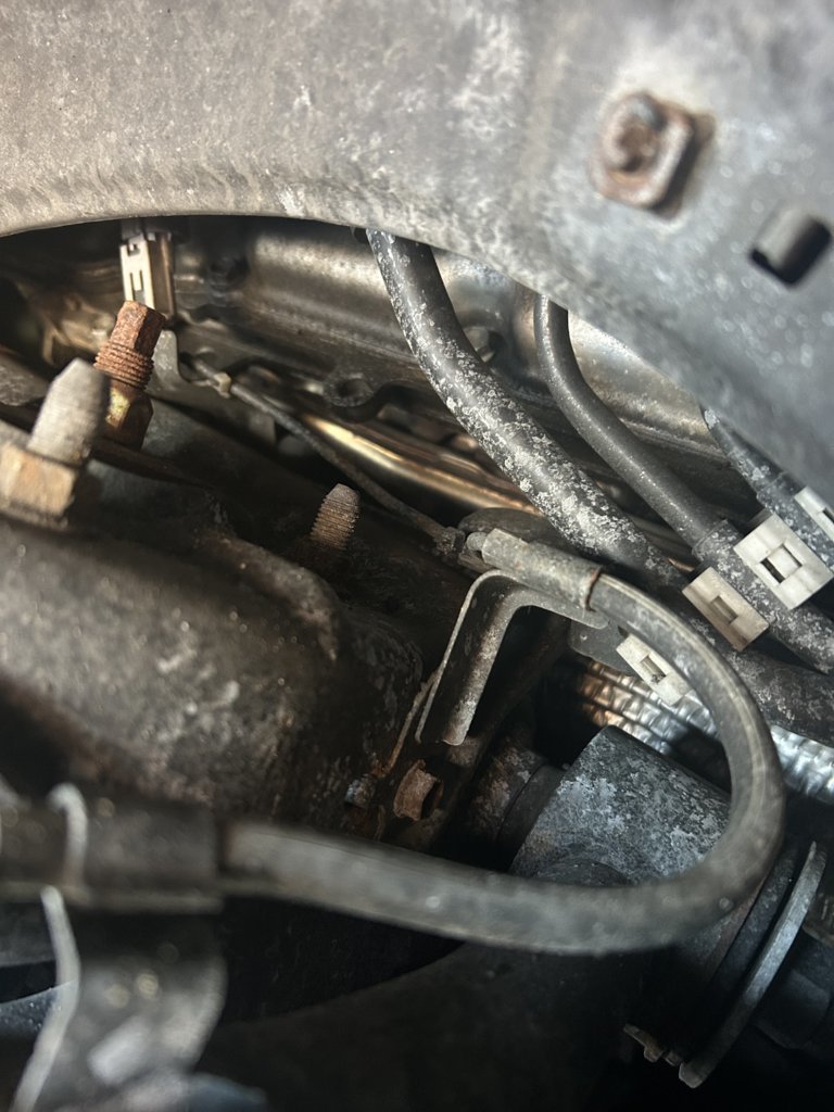

    Started the truck to warm it up this morning (remote start); went out to drive to work and noticed a distinct smell of burning oil from the driver side as I opened the door. I was in too much of a rush to inspect but I suspect I may have the cam tower leak.......2019 with 195k miles. Will inspect closer this afternoon / evening when I can get home.

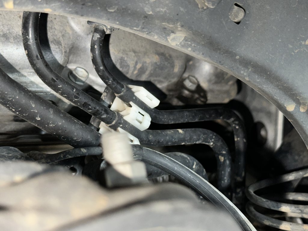

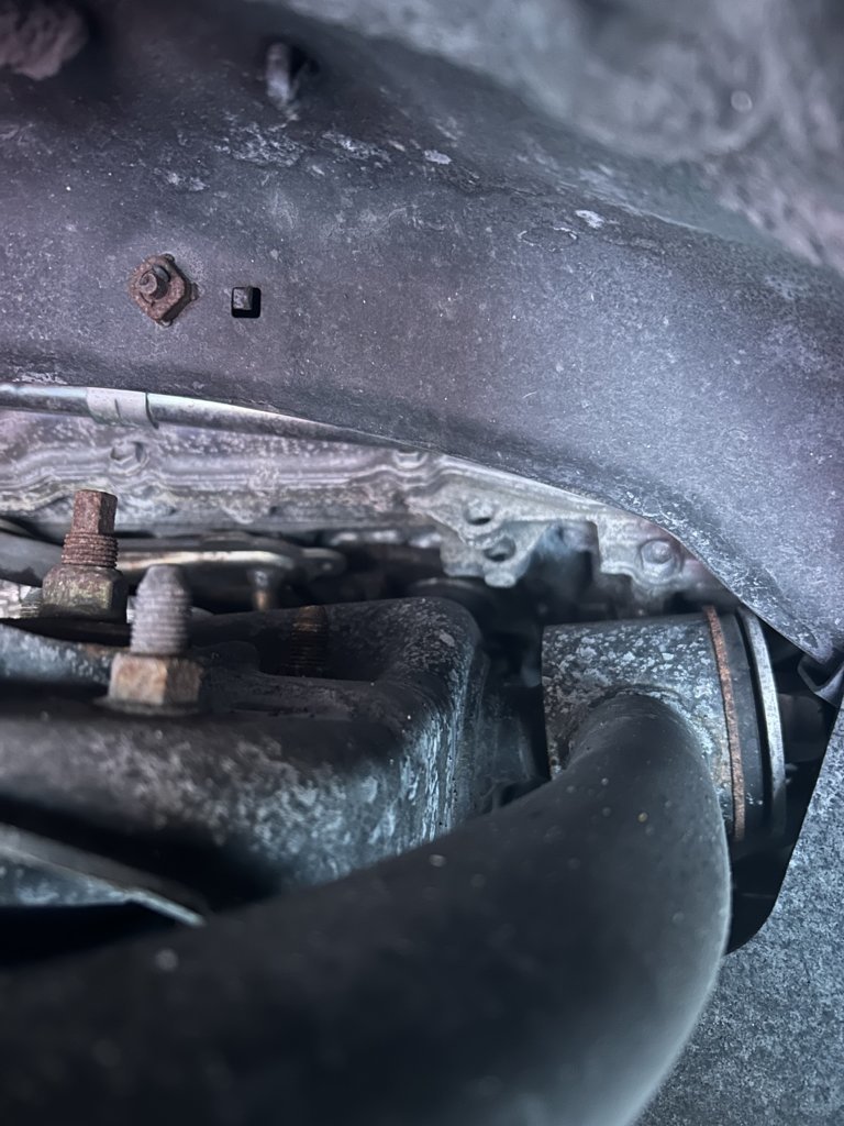

    I think this is the dreaded leak, no?
    drivers side:
    passenger side:
  17. Feb 10, 2025 at 1:30 PM

    Yes. I went with an HD gasser this time for the increased payload, and I really wasn't interested in the TTV6 (especially with all the issues). I agree with you on the looks, as well. :D

    What leak? I hope you're not referring to the white residue? Other than that, it looks clean to me.

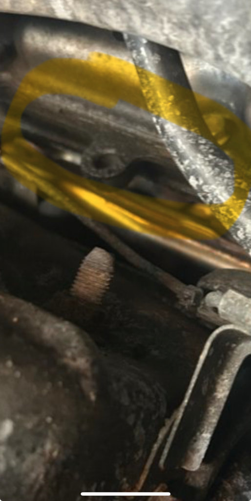

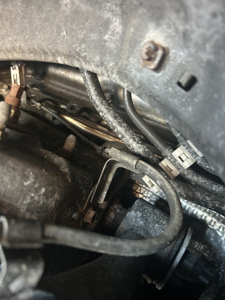

    Is this it?

    It may be. And I say that VERY loosely. If it is, it's ssssoooooo minute, I would not bat an eye.

    I am thinking of wiping it clean and seeing how long it takes to seep / weep again…..

    Here's one way of clearly identifying if it's leaking: clean all the area thoroughly with brake contact cleaner, drive it for a week or so, then reassess. If you see fresh oil leaking then there you go...you have a leak.
    That's what I did and what I thought was a major leak turned out to be a very minimal leak that had built up throughout 16 years of ownership. So, I moved on.

    This is it after the clean up; definitely had a lot of oil residue and road grime. We will see if it returns
