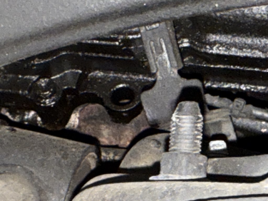

    2010 Tundra 5.7 117000 miles,just wanted to post pics to confirm my suspicions.
    Wasn’t leaking when I bought it 11000 miles ago,passenger side only.

    It probably was leaking but cleaned off before you bought it.

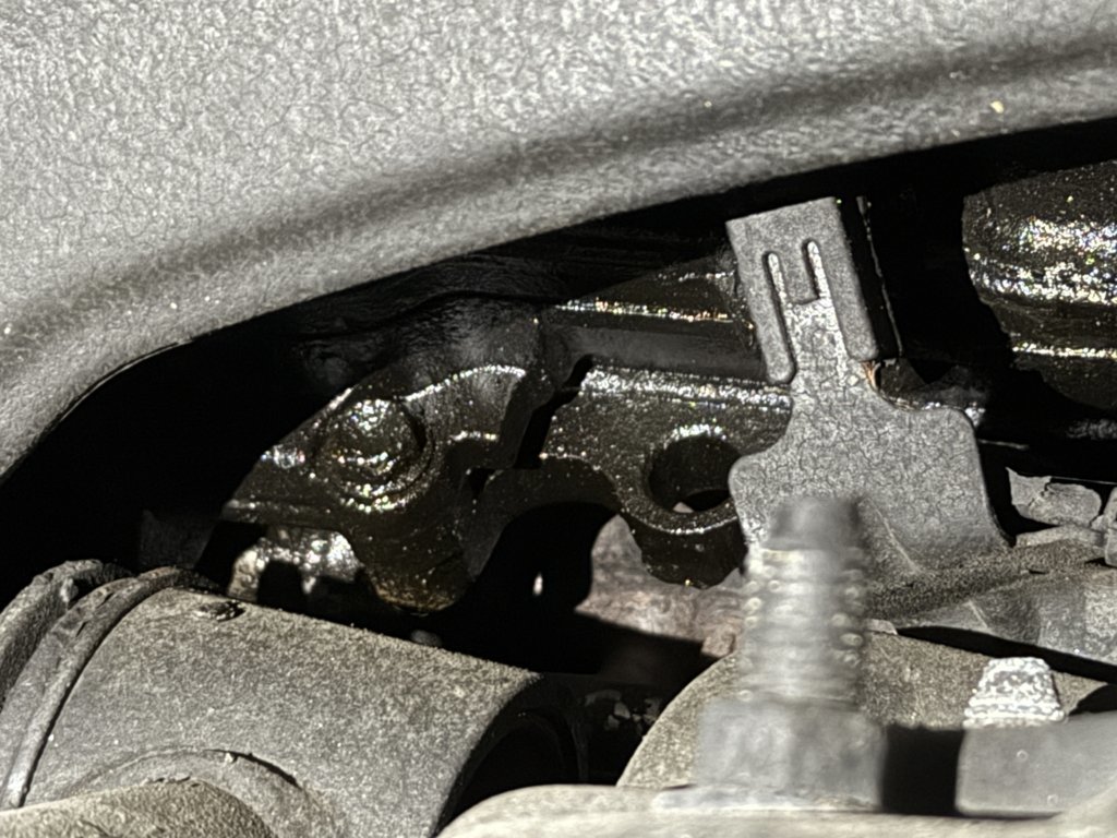

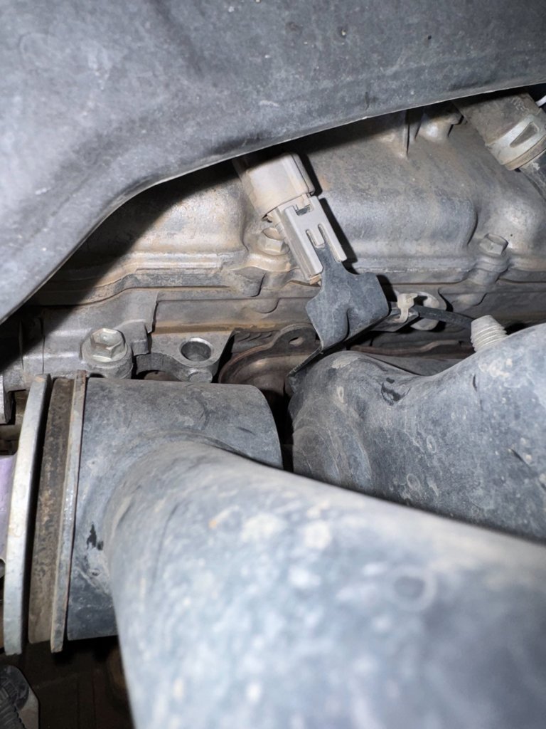

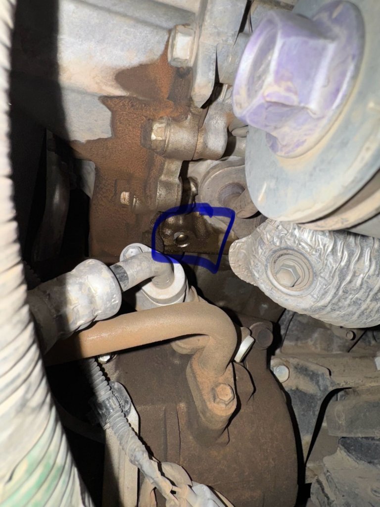

    Soooo... I was doing a post trip inspection as I usually do after any romp in the mountains and I stumbled upon this leak on the drivers side. There is a LOT of crust in this area and some fresh oil that smells new. I don't think this is the cam tower because of how low it is... but I wanted to ask here first if anyone had any idea what this might be.
    Truck is a 2021 with 40500 miles. Oil changes every 5k since new. Does not lose enough oil to make a difference on the dipstick at any point between changes and I don't smell anything when the truck is running.
    Seems minor to me but the excessive amount of crust all over the place has me interested in chasing it down.
    First pic is where it seems to be leaking from. The fresh oil is circled in blue. Second pic is the cam tower seal that looks dry to me. Passenger side is fully dry.
    Is this a Cam tower leak?

    That looks to be at the bottom of the heat. Probably the timing cover leaking
    JrJrOffroad likes this.

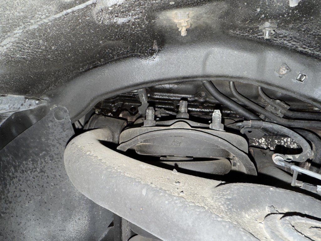

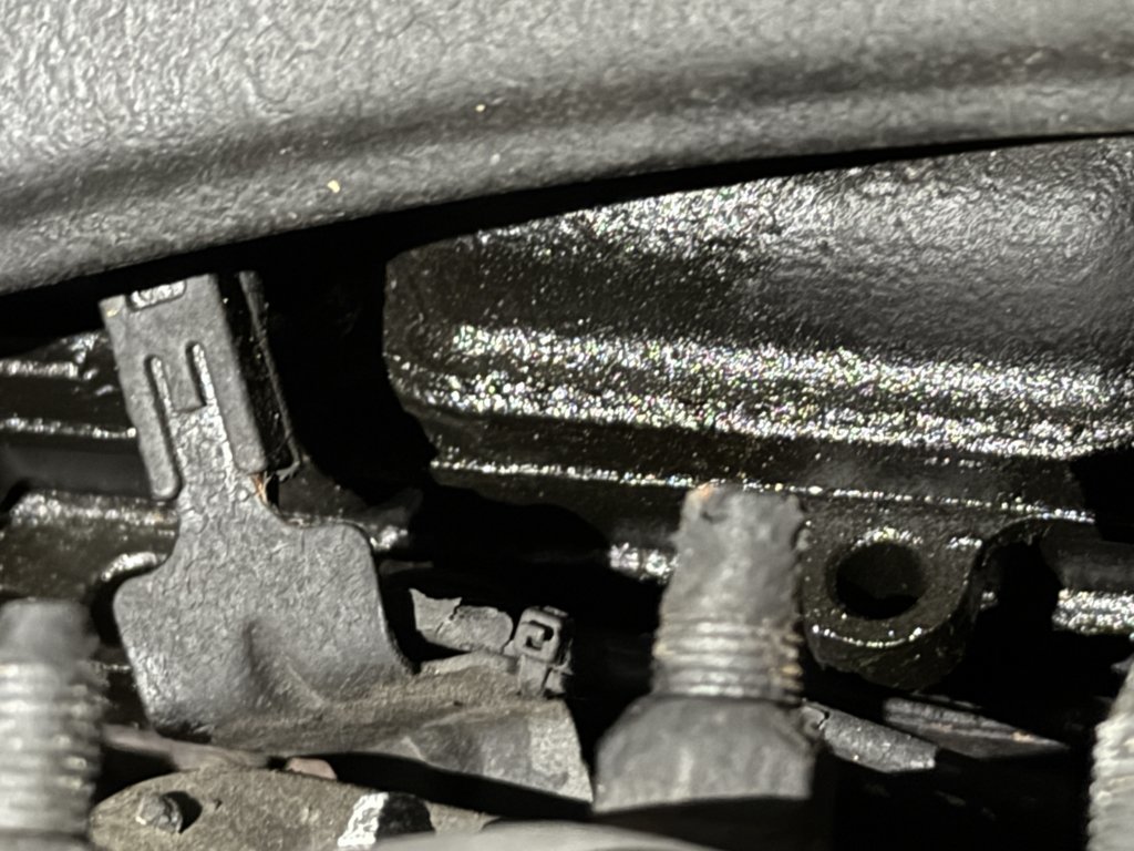

    I’ve been experimenting with the idea of buying a tundra for years. Never gone through with it for various reasons.
    a 2015 with 120k miles showed up locally so I went to check it out. I took a peak behind the front steering wheel and saw a boat load of gunk. The previous owner had an immaculate service history.
    This seems like a lot. Is it the cam tower leak or does it look like it’s too much for that?

    The cam tower may be leaking there, but it looks like there's oil coming from higher up as well, possibly from the valve cover.
    GhostStrykre[QUOTED] likes this.

    it certainly does look like there's moisture up higher on the cover rather than just the seam. i'm assuming the valve cover would be a simpler fix?

    Yes, if it just needs a new valve cover gasket that's 100x easier than resealing the cam tower.

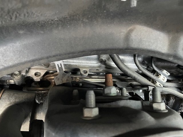

    2012 with 121,000 Miles. Looks pretty clean to me. Truck has extensive service history, doesn’t seem to have ever had this fixed tho! Maybe I got a “good” one. IMG_2694.jpg

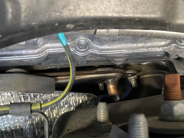

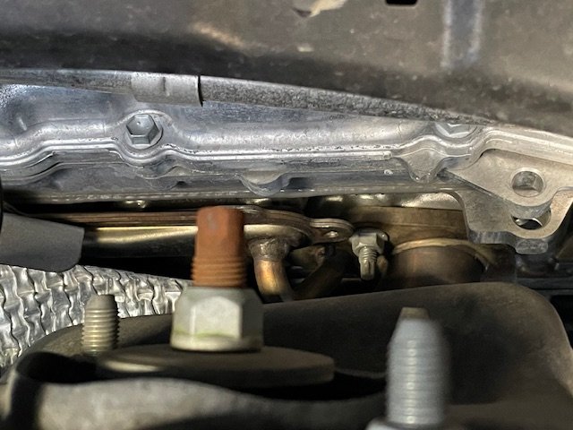

    2019 with 40k miles. Think I'm good for now. I see a little gunk built up but not enough to be concerned about. Will keep checking every few months.
    Passenger side:
    Driver side:

    Looks good! :thumbsup:
