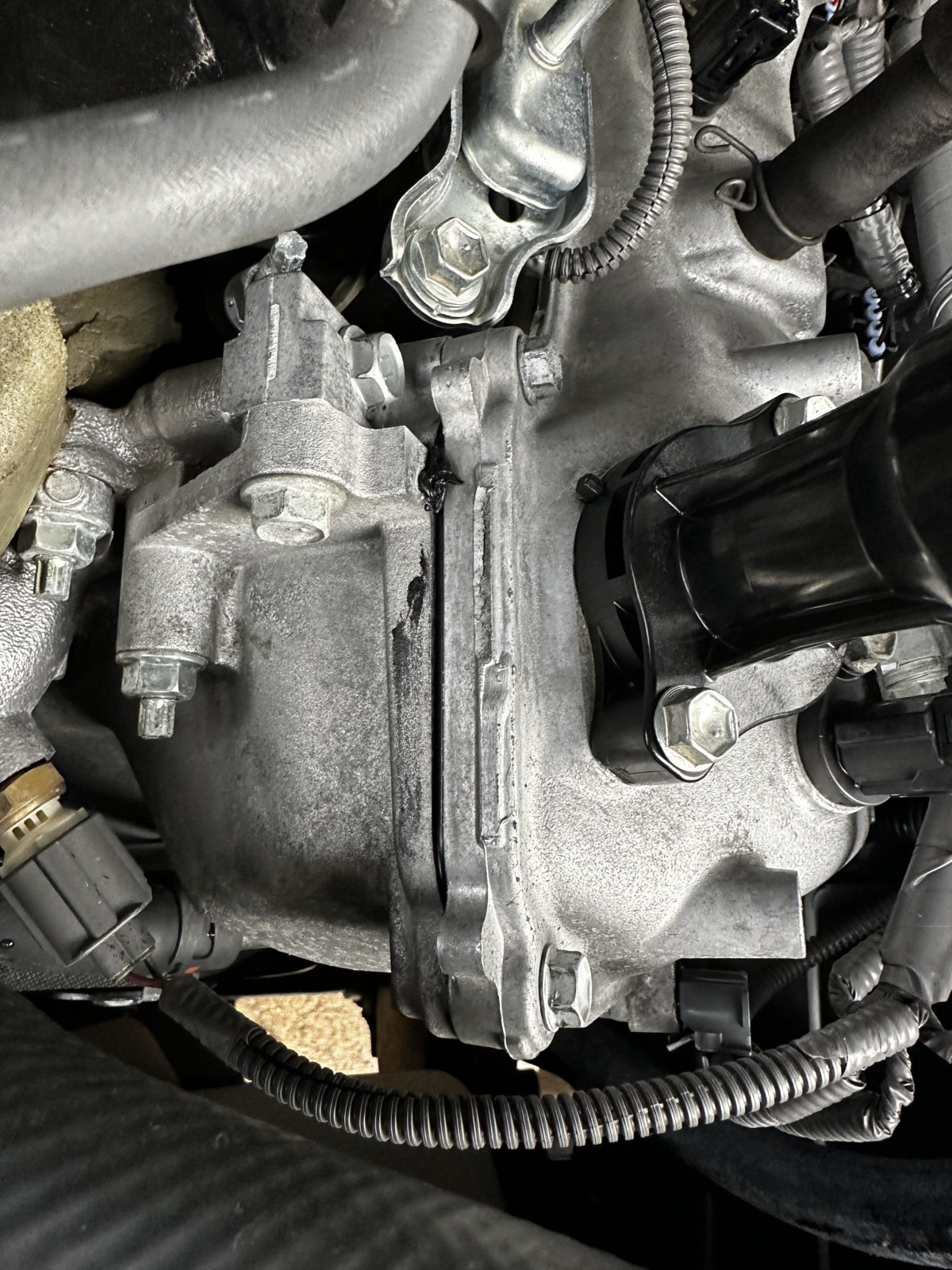

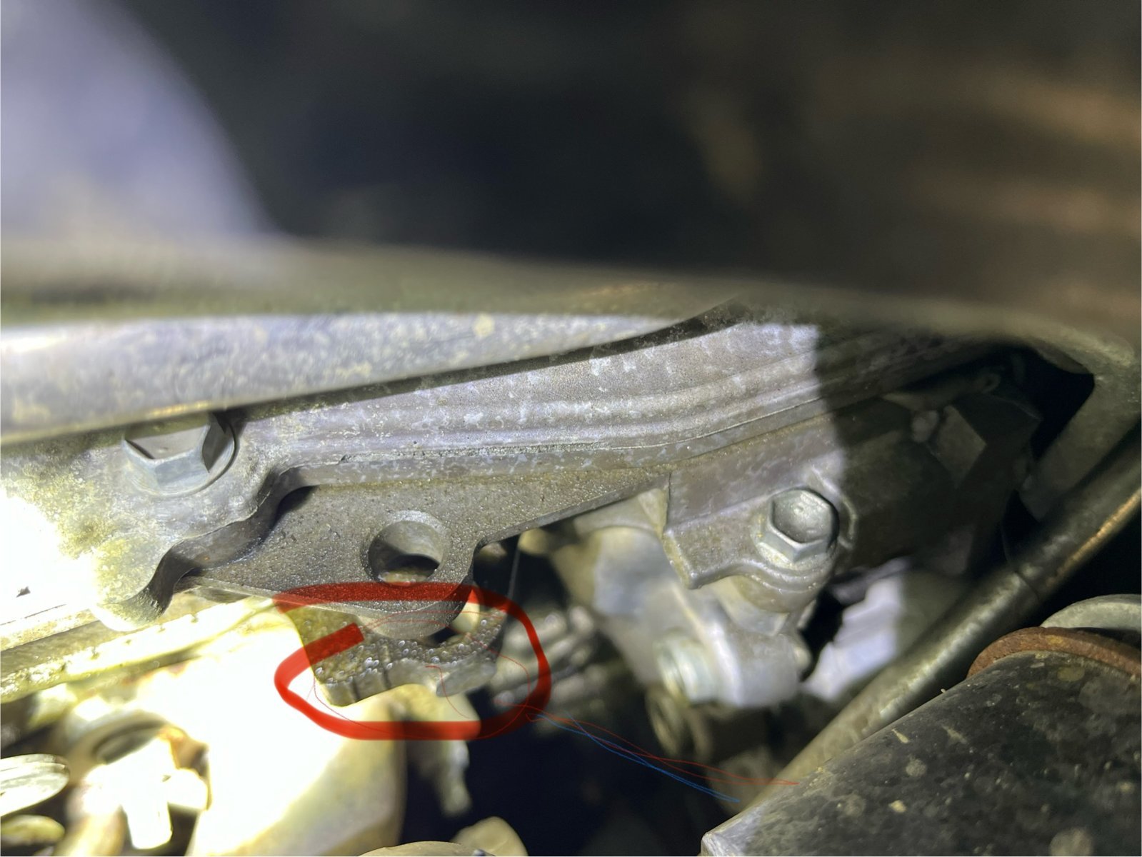

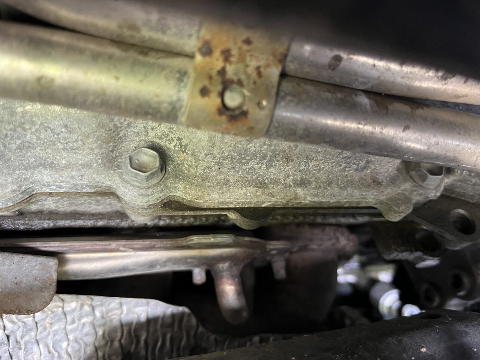

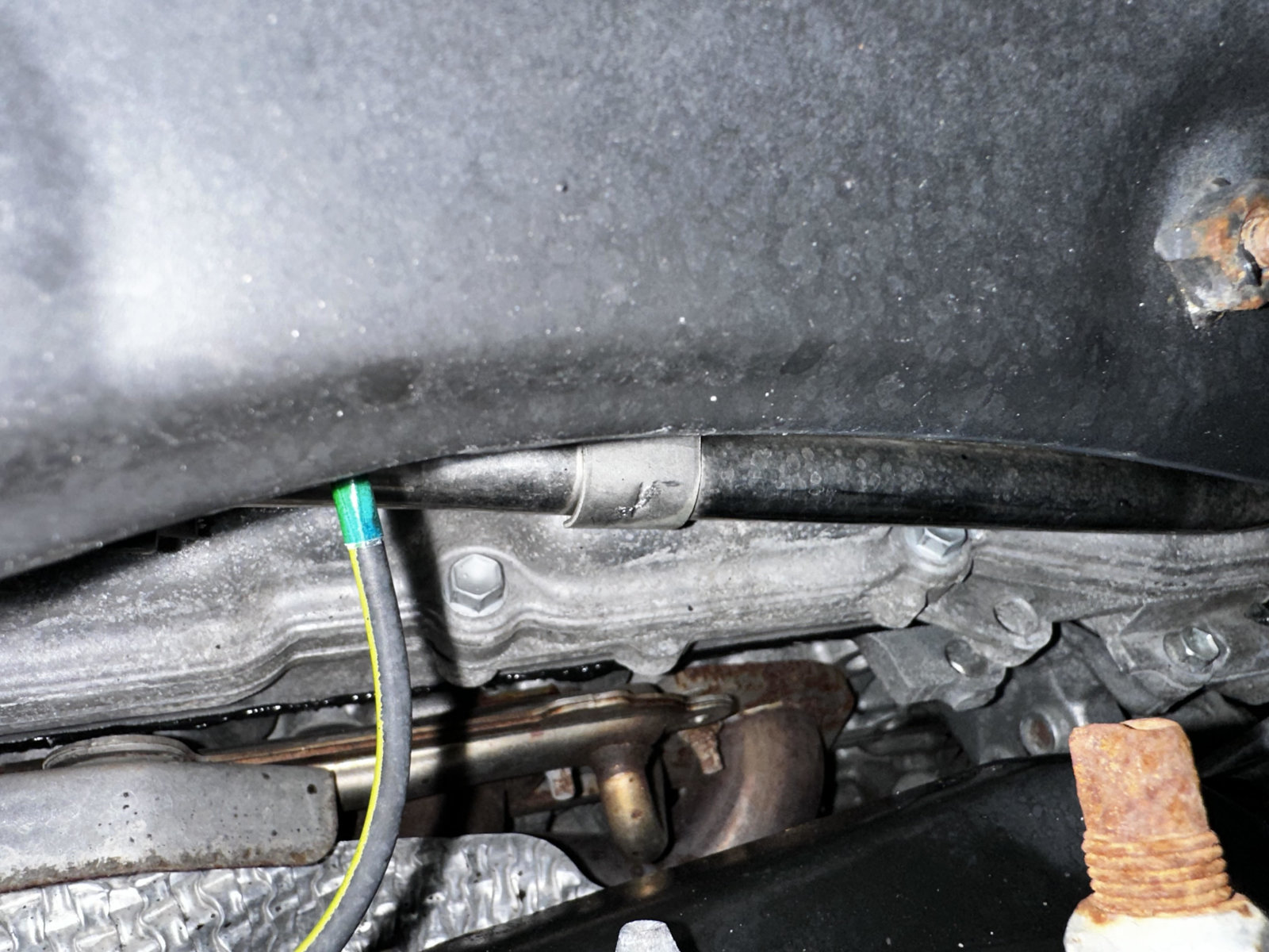

    Got a ton of help on this forum and want to share my experience if it helps anyone out. I purchased a used 2021 SR5 tundra 4x4 CM two months ago and had both cam shafts were leaking. Local toyota here in Ohio who is excellent took care of it and here are the pictures afterwards and the invoice of what was done. Would love to hear any mechanics chime in if the job looks good and nothing was missed.

    Looks like a pretty clean job to me!

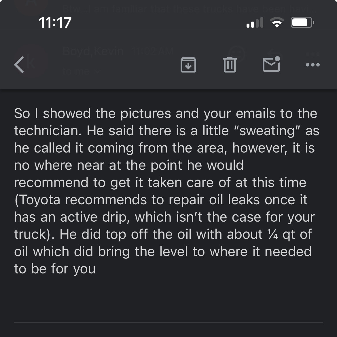

    Toyota tech completed their inspection. He sent me a video of the inspection and did not notice any oil anywhere. I emailed him back and provided details exactly where I saw it….w photos of paper towel dabbed w oil…& they sent me the below reply….sounds like I need a second opinion cuz no truck should be “sweating” oil

    Sweat and leaks are merely semantics now. If your issue is covered and they're resisting, seek out a dealership willing to advocate for you. Often, resistance comes from the service shop, possibly due to low compensation, and from Toyota itself, concerned about financial losses. It may be a tough negotiation. Consider mentioning your intention to involve a lawyer.
    I encountered a similar situation with my Honda Pilot, where they balked at performing a major engine rebuild covered by warranty, citing semantics. After my lawyer sent them an agreement outlining their accountability if the issue resurfaced post-warranty due to their refusal to address it initially, they promptly agreed to fix it.

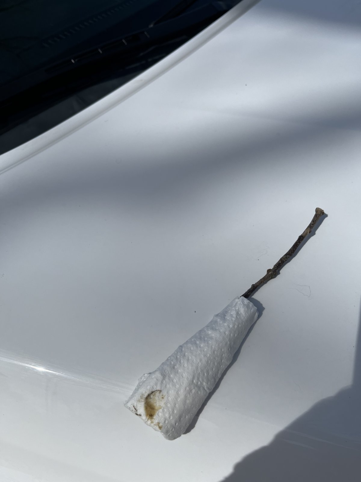

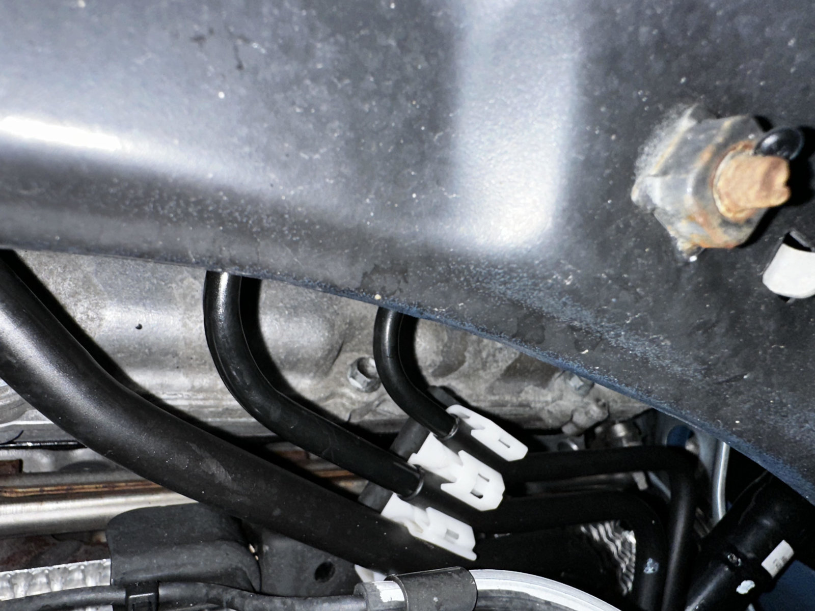

    In this photo, is that small circular flat piece collecting oil? That's where it will drip off. Mine seeped for long enough to collect there and drip.

    Yep. That’s where I dabbed the paper towel. I could see a small droplet of oil hanging there so I collected it on the paper towel

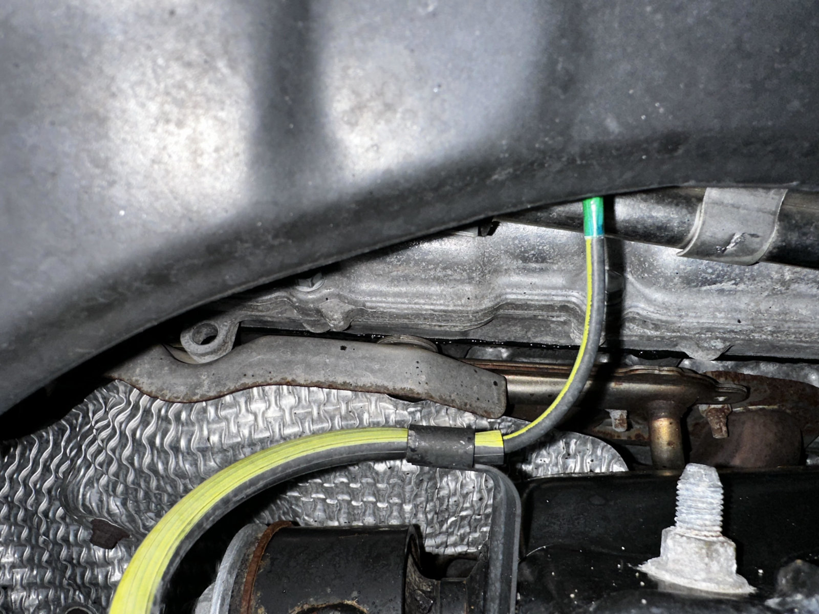

    Nothing observable on the heat shield yet…but I didn’t pry it back to look behind it….but here is the receipt narrative…which strangely is different to his previous email that tech stated it’s “sweating”….so something seems off with them. I told him I have a third party extended warranty and he said they don’t accept those….they only do Toyota warranty….& if it persists…call around to other dealers to see if they accept the third party coverage. And…originally I was informed it would be a $130 inspection fee…but he said since they didn’t do much, I didn’t have to pay the $130. So…I guess I just have to keep an eye on it and if it continues I have to shop around to see who will accept my extended warranty….i can’t believe this is not a recall if it’s so prevalent!
