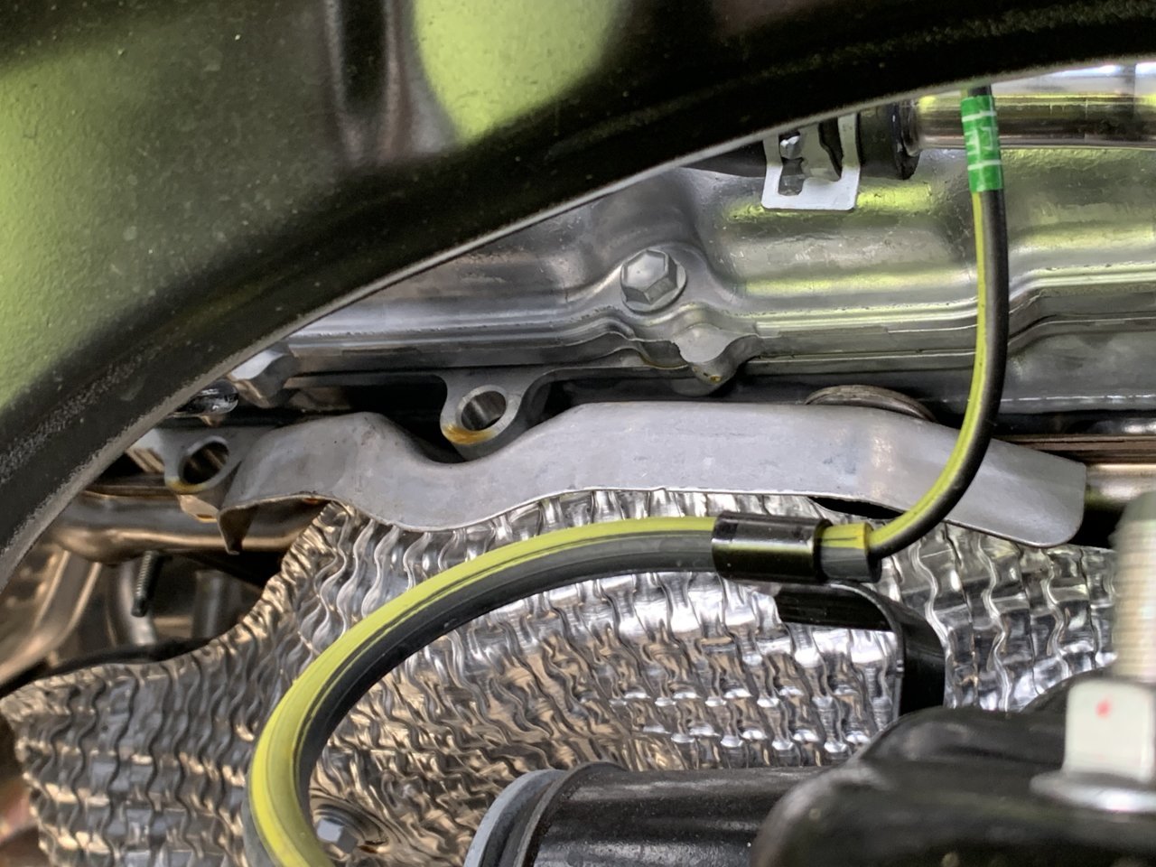

    I guess this is the thread to post this in. Took my 21 Tundra into the dealer because I seen smoke and an oil leaks. 700 miles on this truck…
    I was told today it was just a valve cover gasket but I have my doubts now.
    Currently 10 pages deep into this 90 page thread. Ugh

    Request that they do the dye to pinpoint the origin versus them doing the valve cover gaskets off the cuff (if that's their first suggestion). When I had mine looked at, they did the dye and told me to put 1k miles on it; I made an appointment for the following week (1k miles my butt...). To my eye, that does look like it could be the cam tower, but the dye method should be able to pinpoint it.

    Looks like a cam tower and a valve cover leak from that picture. You can see towards the back where the cam tower is leaking and then looks like a drip coming off the fipg itself. Just ahead of that you have a spot just above the manifold that looks like the valve cover leaking.

    @Callmedave You could let them do the valve cover gaskets, and while you’re there go ahead and have them schedule a time to do the Tower . Then ask them why they want to do the valve cover gaskets twice.
