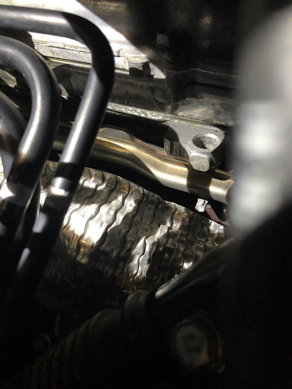

    Looks pretty dang clean...

    I have been paranoid of this common leak ever since I noticed this forum for cam tower leaks. I went to the dealer as well and they stated no leak; However, the driver side appears a little wet in the area of the FIPG. The passenger side is bone dry so obviously it is something. I just spray some dawn dishwashing soap on it and rinsed off the existing sign of any moister and will monitor it. It sucks for sure that we even have to worry about such a minuscule thing such as sealant that should hold up in this area. I personally would not prefer they open up my engine to do this procedure. It may cause more issues later. Fingers crossed.
