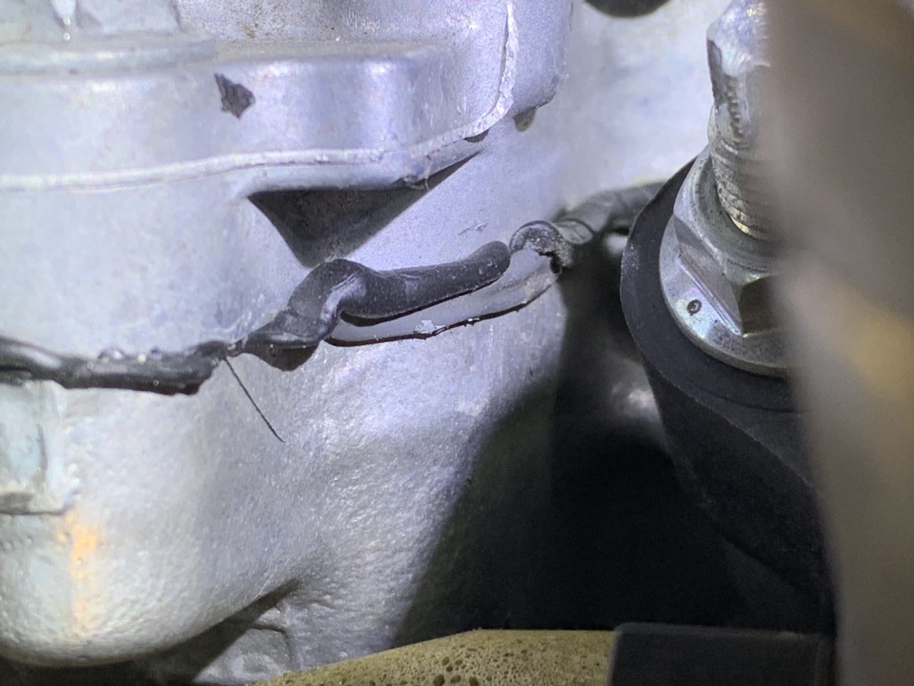

  16. Nov 14, 2020 at 11:53 AM
    #2416
    Jowee206
    Jowee206 Tundra
    Feb 24, 2020
    #43077
    8
    Seattle
    2015 tundra cm limited
    I had my cam towers seal replace on both side at the dealership under warranty. 8 months later the drivers side started leaking again after investigating. I also notice a leak on top where the fuel injectors are. When I looked at the cam towers on the upper part. I noticed a factory seal and the new black seal that the dealership just added without stripping the old seal. Looks like a shitty job. Now it’s leaking from the top and bottom. As for the passenger side. Same ! The new black seal was on top of the factory gray seal. Now I hope it doesn’t leak like the drivers side. My truck is in the shop now hoping they will do a quality repair this time and make it reliable again! I also requested a different technician!
    Drivers side upper cam tower with leak
    Passenger side upper cam tower
    Drivers side lower rear cam tower leak
    This pick was the first sign of the leak. Taken in February 2020
    k0diak8o8 and equin like this.
  17. Nov 14, 2020 at 12:47 PM
    #2417
    TheBeast
    TheBeast The Beach
    Apr 27, 2016
    #3246
    12,579
    SoCal
    2012
    wth, that was a shitty job from the technician.
  18. Nov 14, 2020 at 12:48 PM
    #2418
    glowblue
    glowblue From time to time
    Mar 28, 2019
    #28267
    1,940
    Brian
    VA
    2021 Tundra SR5 —> 2021 F-250 XLT
    Damn that sucks. Looks like shit, I wonder if they didn’t clean off the old sealant and just gobbed the new over it? I’d be pissed as hell!
    Blue Thunder likes this.

  20. Nov 14, 2020 at 3:28 PM
    #2420
    Jowee206
    Jowee206 Tundra
    Feb 24, 2020
    #43077
    8
    Seattle
    Yes it does suck glow blue! You’re right ! The technician didn’t remove the old factory seal. He just added the new black seal. The dealership never saw the leak from the upper part of the cam tower! So they just replace the valve and said cam tower wasn’t leaking. When I went back to get my truck. I had to make sure and point it out to the servicemanager. Now my truck is back inthe shop for another few days!
  21. Nov 14, 2020 at 3:49 PM
    #2421
    glowblue
    Mar 28, 2019
    #28267
    1,940
    Brian
    VA
    Fire the A-hole who did the “repair”!

  23. Nov 14, 2020 at 4:07 PM
    #2423
    glowblue
    Mar 28, 2019
    #28267
    1,940
    Brian
    VA
    That explains everything....:annoyed:

    Washington
    What dealership!? I bought my rig in Bellevue and if I need the repair I don’t want to take it there.
    I agree with the others. Looks like the tech just used the sealant as caulk and didn’t actually take the engine apart.
