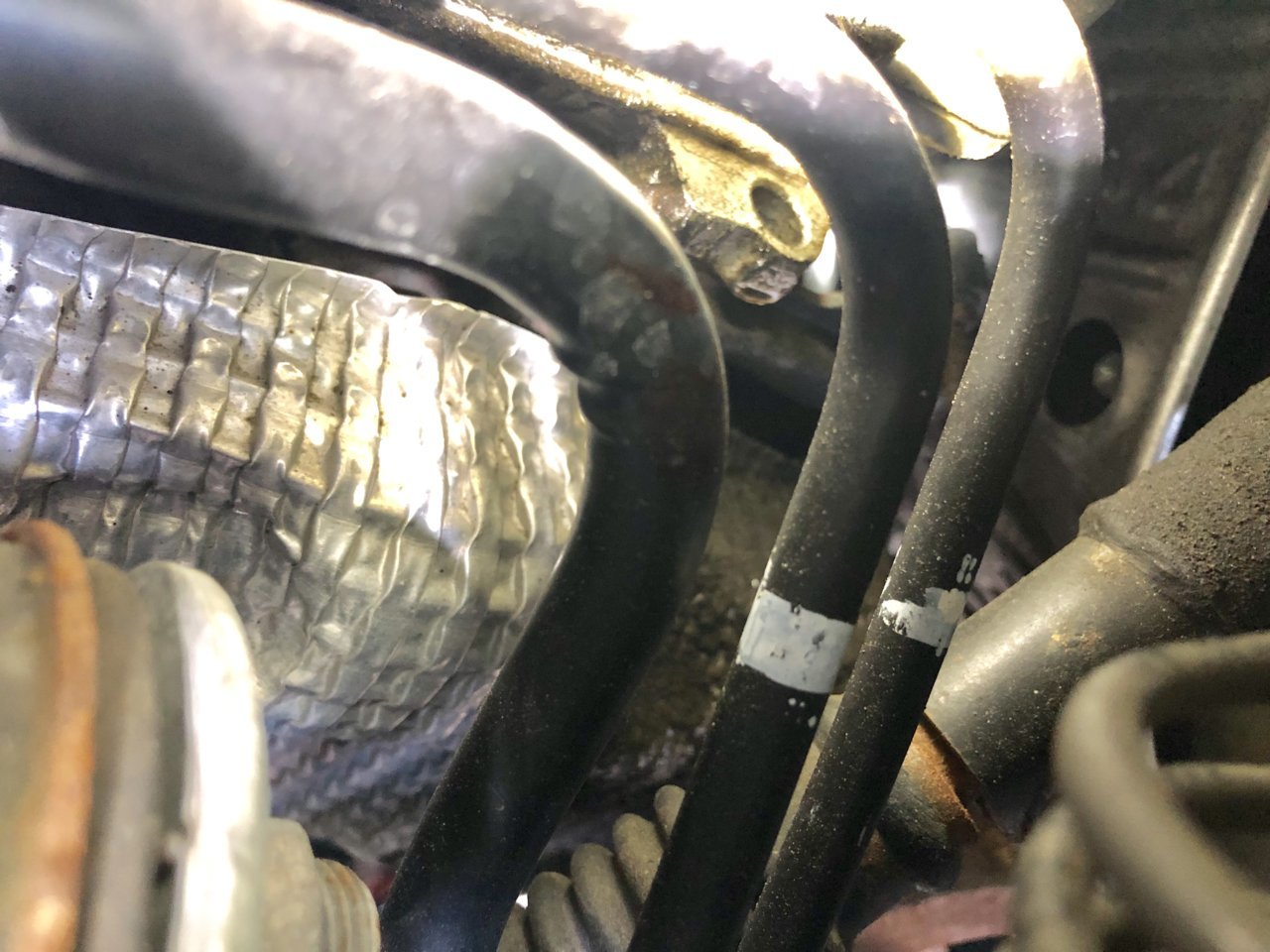

    Camper shell, LED lighting VLEDs, Front Camera, Pro Comp wheels. Trd HID LED headlights. ESP storage rear seats.
    does anyone here have this issue with a 2014 + 4.6
  30. May 11, 2019 at 10:31 PM
    #1770
    Spadoo
    Spadoo New Member
    May 11, 2019
    #30423
    8
    Livermore, CA
    2016 Tundra Platinum
    New here. Just bought my first Tundra (2016 Platinum), after owning two Tacomas and two 4runners.
    Sure enough, I noticed a leak on my driver side 10 days after purchasing it from my local Lexus dealership in Pleasanton, Ca. I’ve owned the truck for a total of 17 days now and put 300 miles on the truck. I believe the leak was cleaned up prior to sale. Had my mechanic (who specializes in Toyota’s specifically) look at the truck for an hour before purchasing it. He didn’t see anything wrong with the truck. Brought it back to him after smelling a burning smell and noticing the leak. He confirmed the cam tower leak and said he specifically looked for that.
    Bringing the truck back to the Lexus dealership on Monday to have them take a look. Will see what they decide. Also opened a case with Toyota immediately after finding this thread. I’m hoping since it was a very recent purchase, they’ll do the right thing...especially it being a Lexus dealership. If not, I’ll raise hell and run the issue up every chain at the Lexus dealership and Toyota Corporate.
    Also, spoke with my service advisor at my local Toyota dealership. He confirmed this to be a common and well known issue.
    Hard to get a picture, but from under the truck the leak is very visible.B6995D69-5705-47B1-A71B-A9852AC505EE.jpgAB2C182D-7A35-465D-A70F-F3207A2DFDEA.jpg
