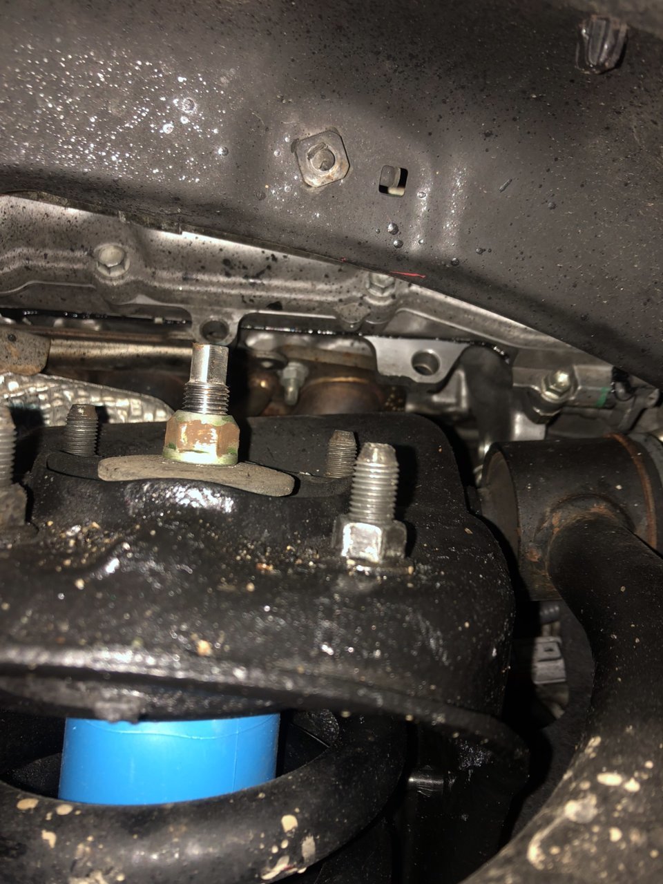

    Here’s the passenger side of mine, the pic of the drivers side didn’t turn out.1B462960-E1C3-41FD-BEF9-052B58E4A880.jpg

    Looks good, hopefully no issues going forward.
    I would submit copies of your receipt and any info you have on this matter and write a letter and mail it to corporate Toyota, you shouldn't have to pay for something they have dropped the ball on.

    I agree totally, I just may do that. The service manager did give me a free oil change next time. Lol. You know the funny thing that bothers me is that my dealership acted when I told them it was leaking and they acted like they never heard of the tundra cam tower issue before. But when they found out that Toyota corporate wasn’t going to do anything about the leak and that I was paying for it they said oh we’ve done plenty of those, your truck is in good hands. Just hate the playing of games, shoot straight I can take it.
