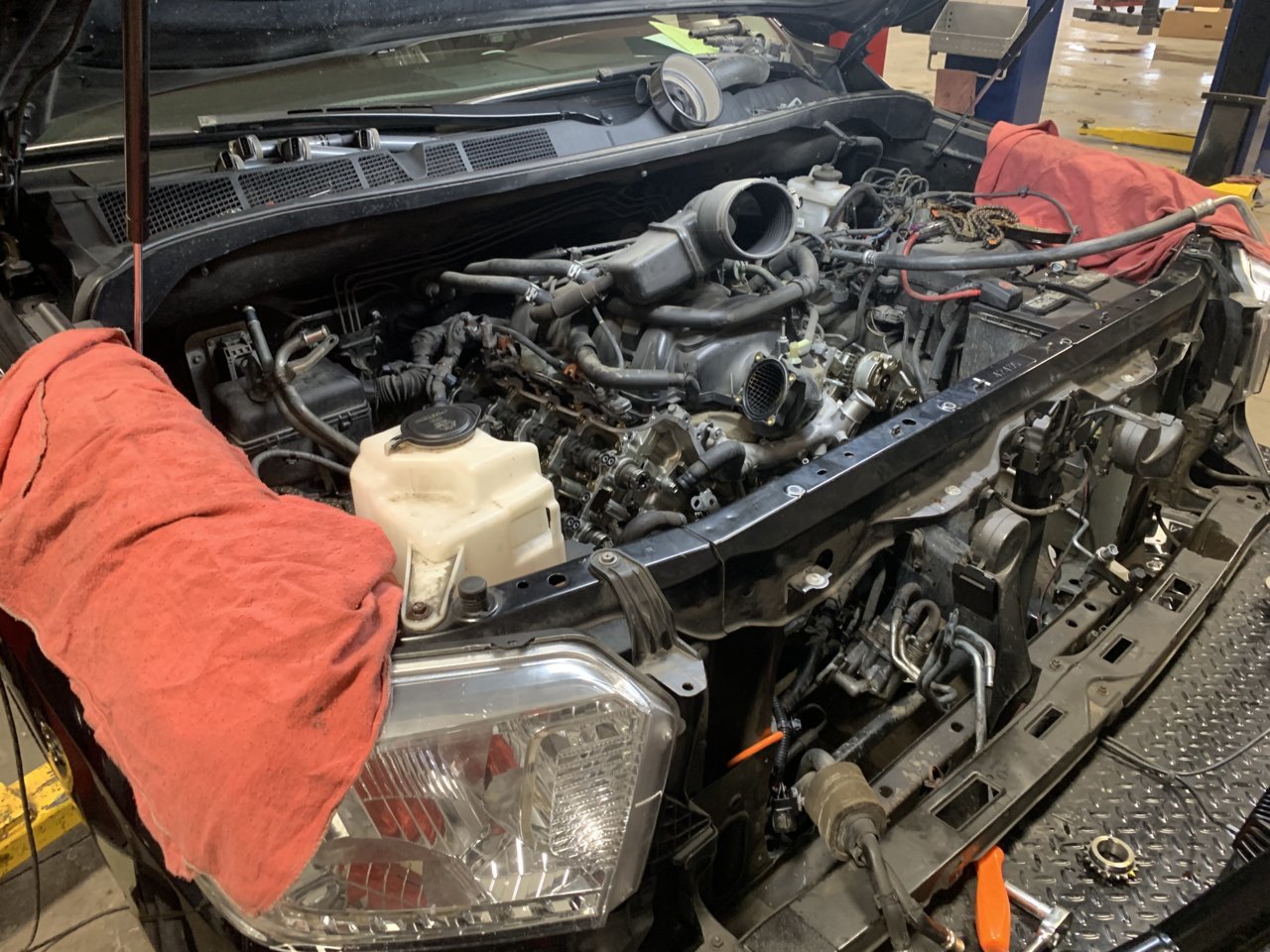

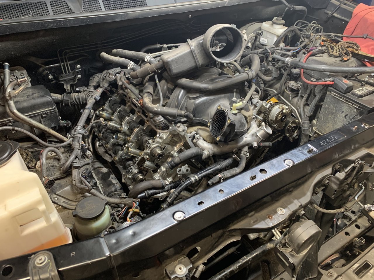

    Thought I would share a progress pic. Truck went in Monday morning. Supposed to be 2 day job. Master Tech seems to be very conscientious. Pulled radiator to get more working room. Hopefully it will be done by cob Monday. I did ask tech if anything should be replaced while it was broken down, and he said everything looked good.

    yep..it's pretty extensive tear down..

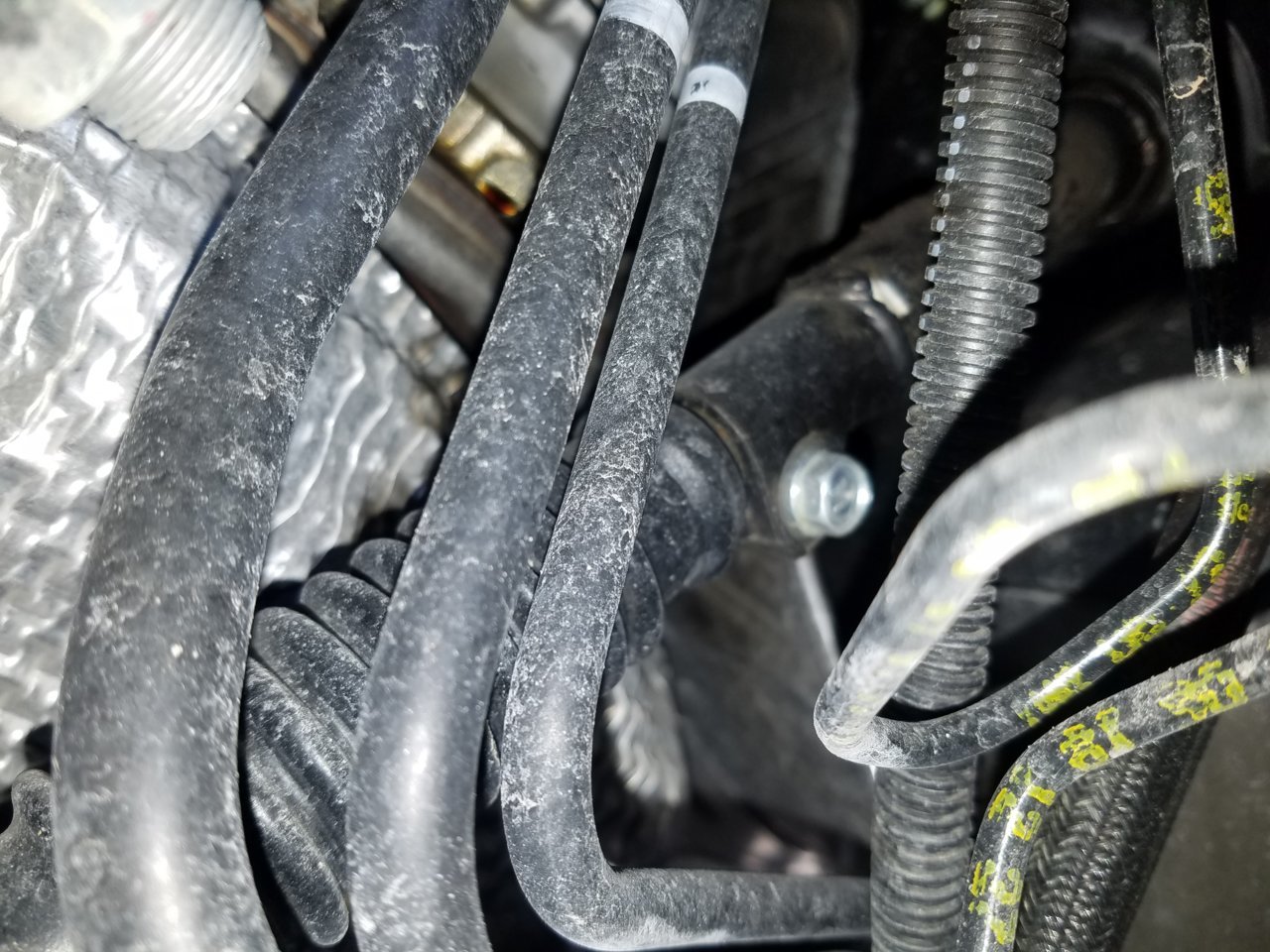

    I got 19k on my 14. Took it in for an oil change yesterday and asked them to look at the pass side. It was dirty and they had to confirm it. I could barely tell it was there. They ended up not changing my oil and made an appt for Feb 12th for a couple days. Said may as well not change the oil now because it would be covered under warranty work. I wouldn't have done anything had it not been under warranty and I probably wouldn't have worried about it.

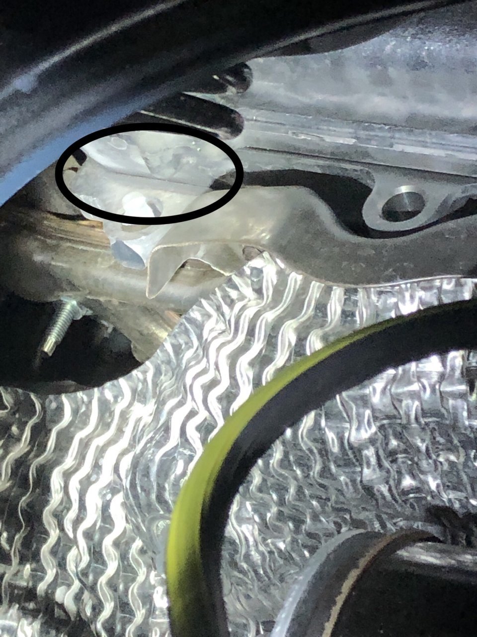

    *update. I'm at the dealer right now. My service tech could verify the Cam tower leak and he also had another service advisor take a look. They are pulling it in right now to have a tech verify and then it sounds like they will get the ball rolling. Hopefully the tech doesn't disagree. More to come.

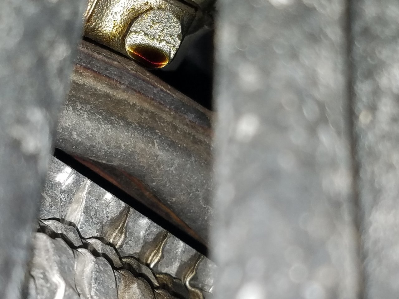

    2018 Tundra CM limited here. I have 7500mi and the drivers side has a very slight weep that can only be seen if you run your finger over the rear (where everyone’s pics are) when cold and get a slight amount on your finger. Would never know unless I found this thread. There is definitely more FIPG on the passenger cam tower than the drivers.
    They aren’t touching mine unless it’s dripping on the exhaust. :)
