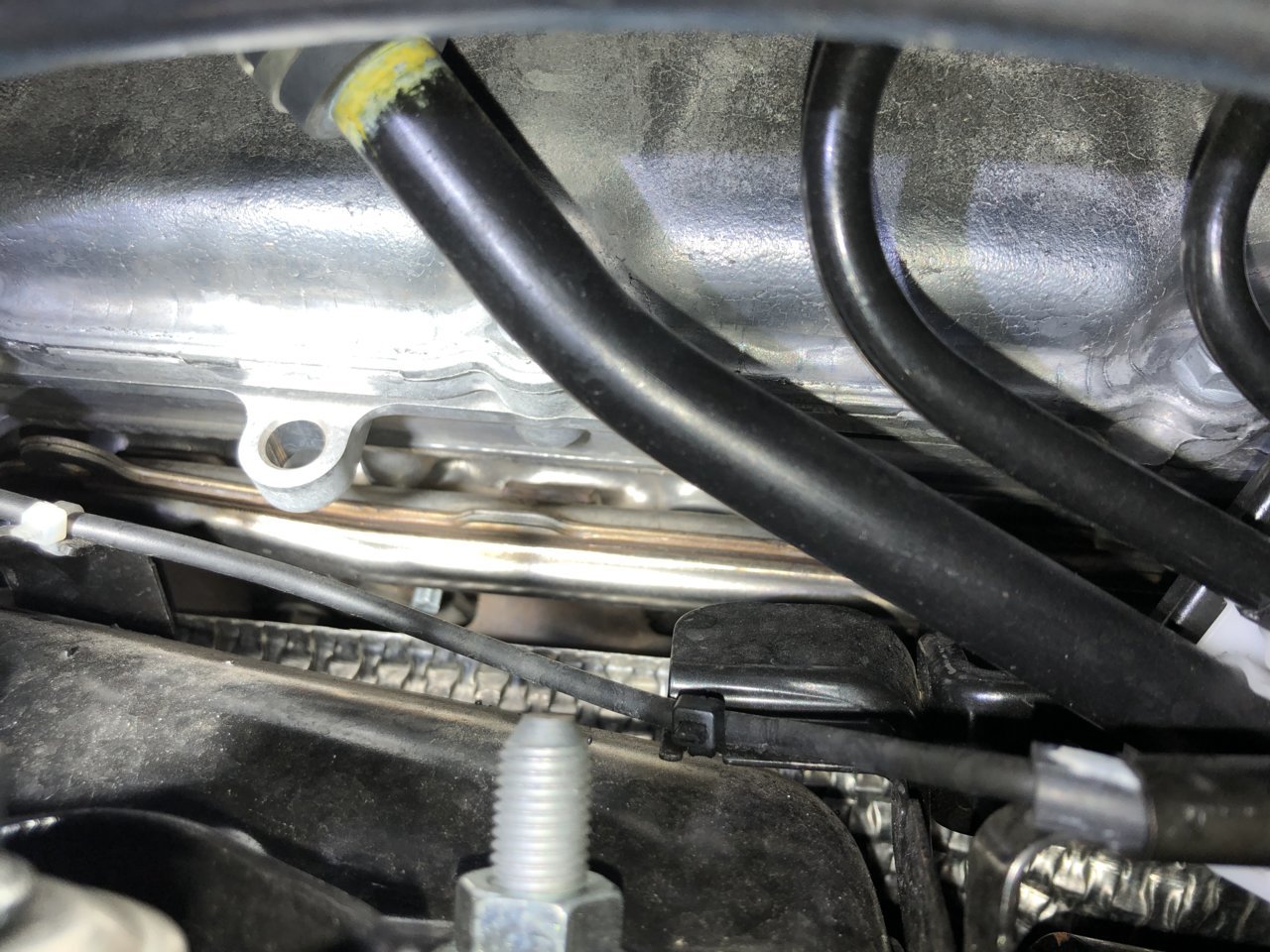

    This is my 16 with 55k-ish miles
    Does that help any?
    georgiey22[QUOTED] likes this.

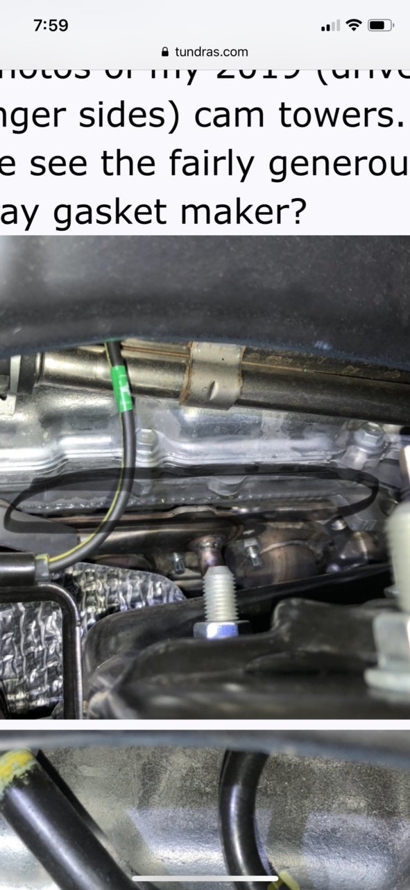

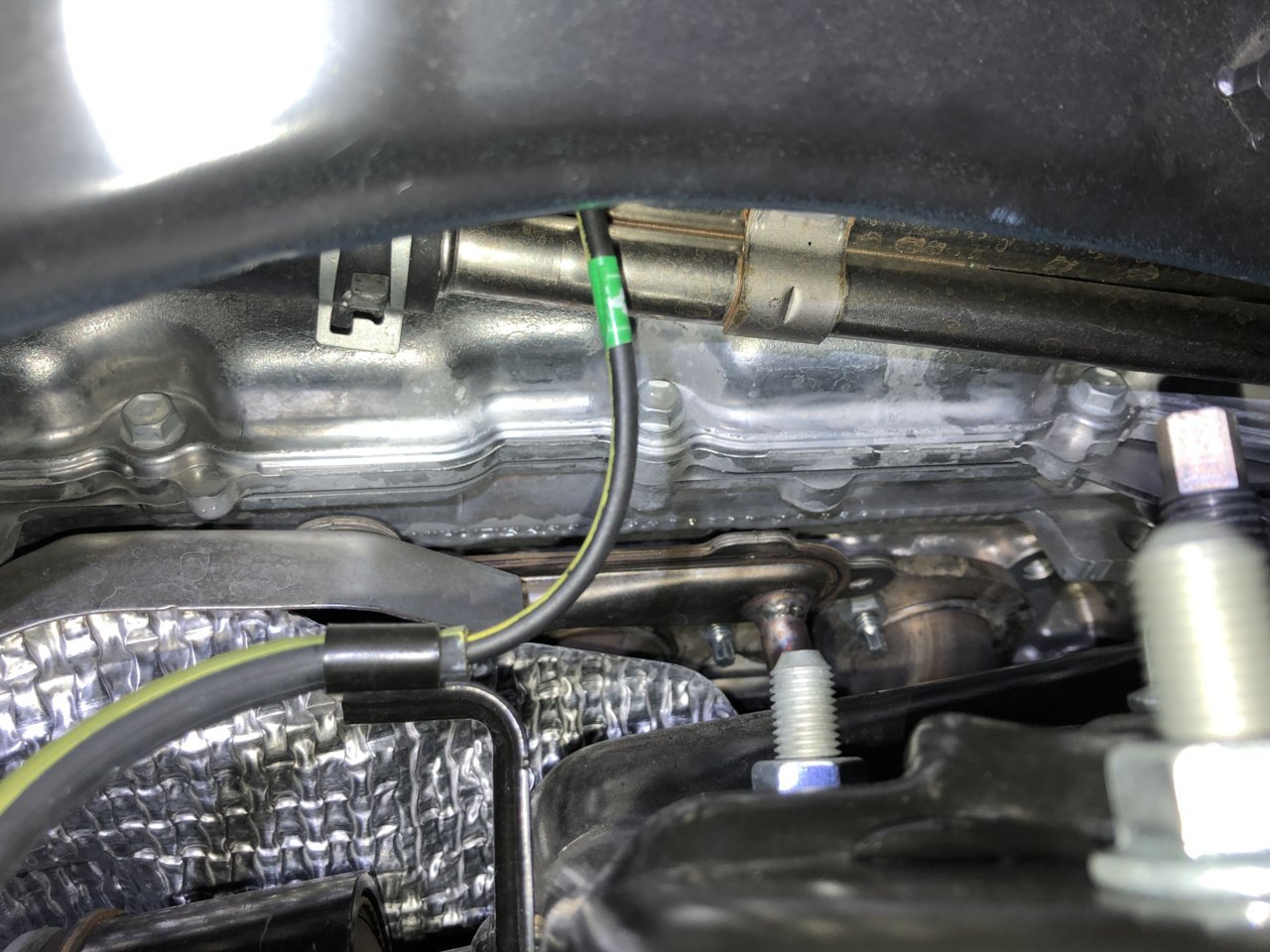

    Here are photos of my 2019 (driver and passenger sides) cam towers. Can anyone see the fairly generous bead on gray gasket maker?FA13817E-F31C-4083-BF6C-19C4177ECFF4.jpg 018FEF75-AF14-4052-B63D-007BE086D470.jpg
    OR18TRD likes this.

    I’m prudent with my maintanence and do it all myself, usually. I’ll keep an eye on it but would ask for other ‘19 owners to post some photos to see if this is consistent. Also, even with the additional silicone, if it is cheap silicone, I could still see leaks. Who really knows?

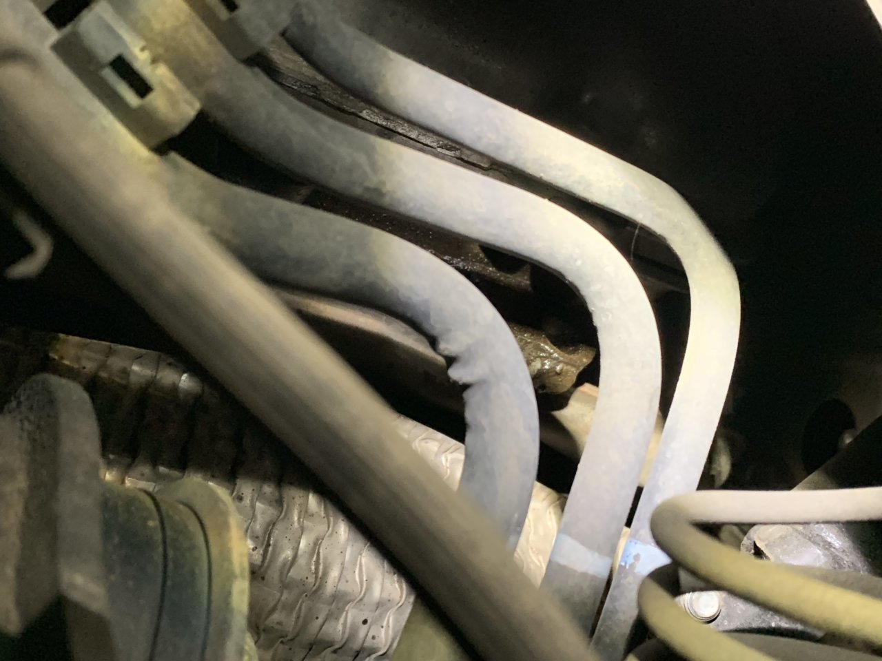

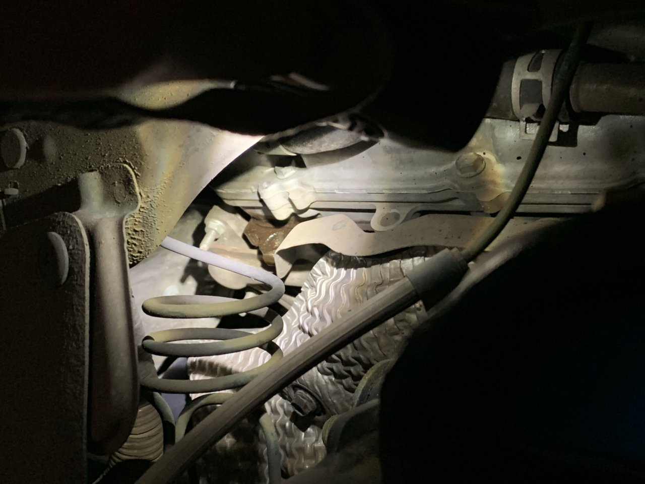

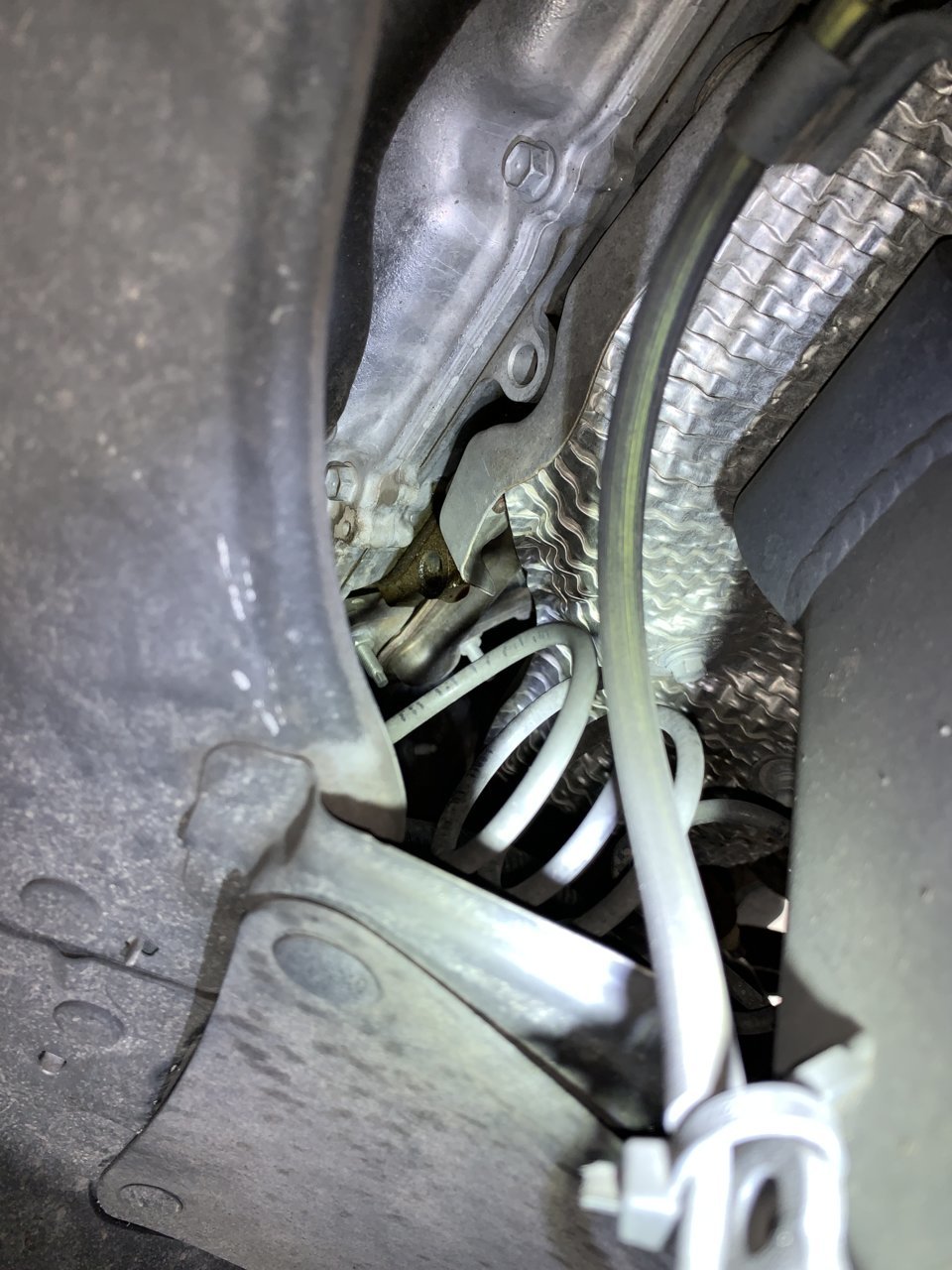

    That's how mine looks. However you need to look towards the rear of the motor.

    Back towards the cabin or towards the front bumper?
  27. Jan 31, 2019 at 9:10 PM
    #1347
    r1-superstar
    r1-superstar Kailua Boy
    Jun 20, 2018
    #16296
    1,672
    DB
    UTAH
    2018 TUNDRA CM SR5 TRD SPORT 4x4 MGM
    Cabin. Poke your head inside the wheel well, aim your camera up towards the rear of the motor. 20190122_110347.jpg
    OR18TRD likes this.
