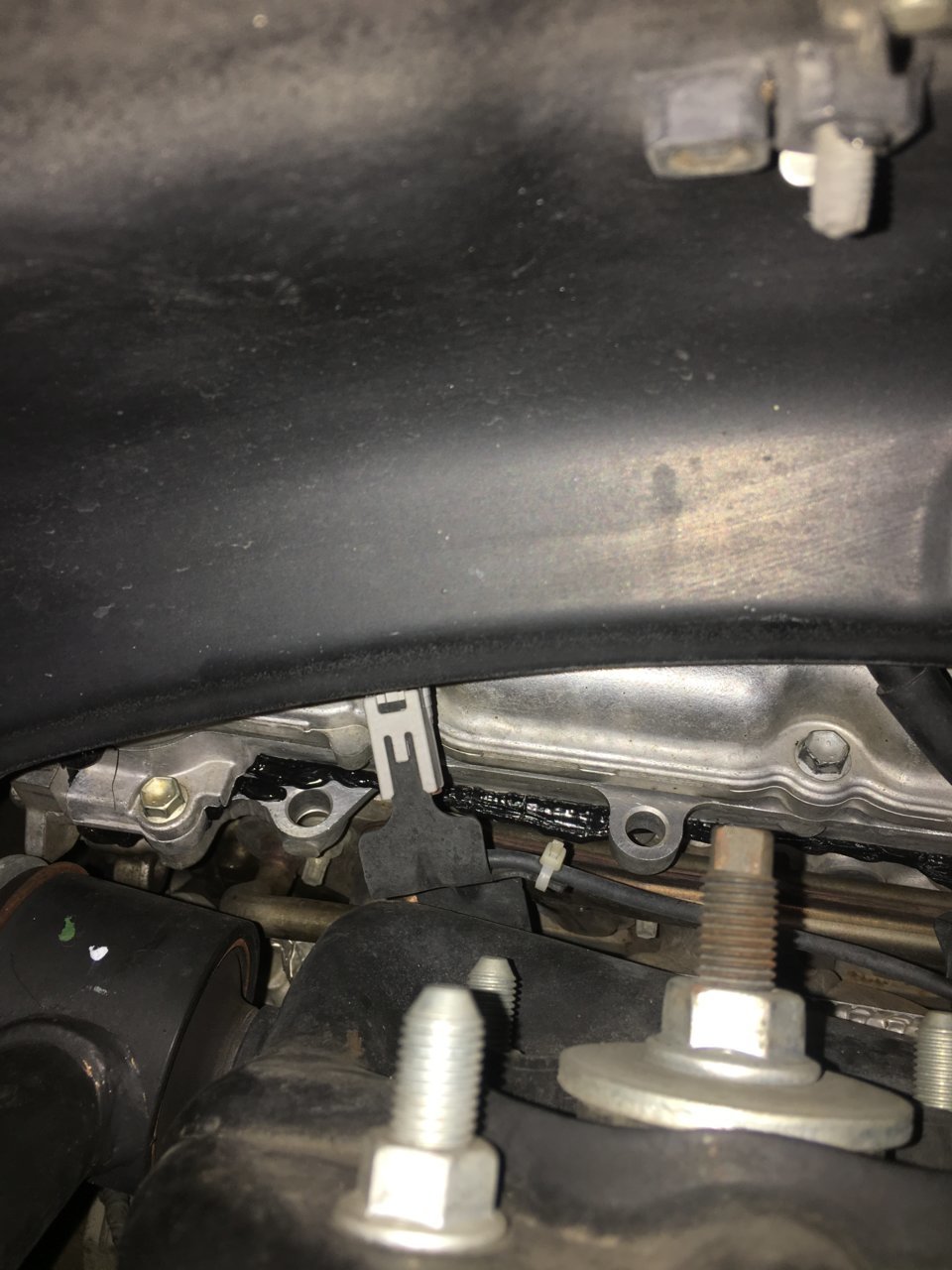

    Went to another Toyota dealership and had everything taken care of under warranty, Toyota did both sides. Thanks again for all the information everyone provided!

    yep looks like mine..a messy black sealant :)

    Nice! Looks like they went all out on that black sealant.
