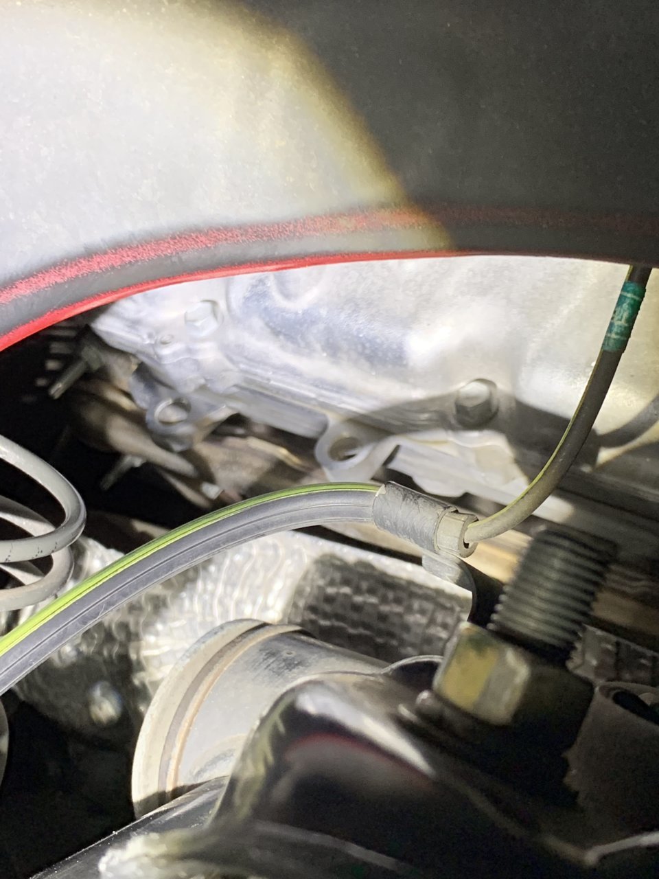

    B257B8A4-0ECF-4AFA-8C96-D41786B7CC01.jpg 16BA1359-4BB9-41F0-8169-1754F68555EE.jpg Was working on my truck tonight and figured I would check on cam seal leak. Unfortunately I think both sides might be leaking if I’m looking at the correct area.

    That's the correct area and looks to be leaking, man the more people are informed the more these are turning up. Toyota is gonna shut Tundras.com down lol.

    This is how mine looked but only on the passenger side. Both sides of yours are leaking on a 2018, wonder what the heck is going on with these 2018 motors.
